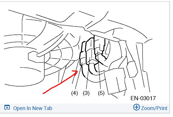

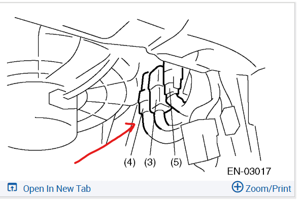

Im having trouble trying to determine where the fuel pump relay is in my 2007 Subaru Impreza wagon? Ive been over both fuse boxes and theyre not giving me the answers Im after, its been mentioned in other forums that it may be under the dash on the passenger side and to get to it the glovebox needs to be removed is this correct?
Nov 7, 2025 at 9:36 PM
  • 55,224 POSTS
Yep, the fuel pump relay is under glove box on the right side of the dash right next to the blower motor, do you have the new relay? If so match it up to the old relay to be sure you have the correct one. Here is an image for the location for clarity. It will have four wires going to it, which are:
vio/wht
grn/red
blk/red
blk/yel
Check out the images (below). Let us know if you need anything else.
