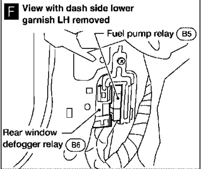

Cannot locate fuel pump relay.

It is hiding behind left hand kick panel. See picture for location.
Image (Click to make bigger)
