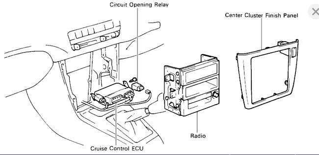

Trying to locate the fuel pump relay.

Good morning,
The fuel pump relay is also called the circuit opening relay.
It is located behind the radio in the dash. I attached a picture for you to view to access the relay.
What is the issue that leads you to this relay?
