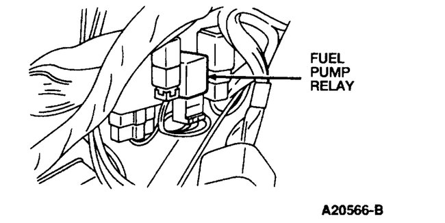

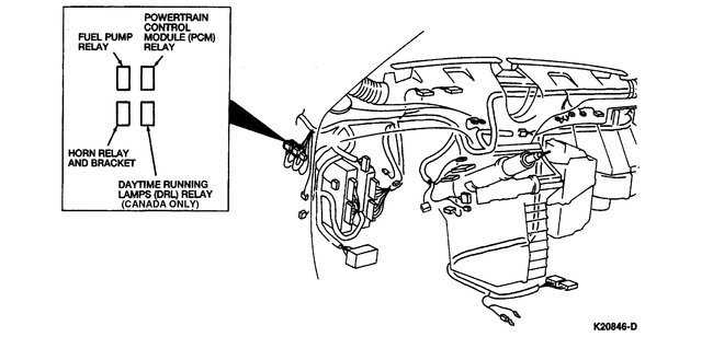

The Ford instruction manual states that part number 9345 (the fuel pump relay) is left hand behind instrument panel. I could not see it in that location. Do I have to remove the instrument panel? There is nothing behind the instrument panel other than the firewall (which would put the relay under the hood in the same location as the EGR Solenoid). I removed the left hand panel of the dash board, still nothing? Below the instrument panel, there is a fuse block but no pump relay? Tell me how to find it.

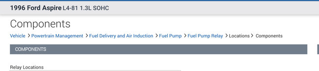

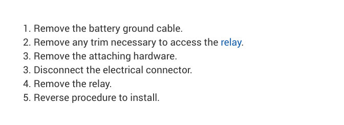

That is where the fuel pump relay is located on your vehicle. In the diagrams down below I have included the directions for how to remove and install the fuel pump relay on your vehicle. Please go through this guide and get back to us with how everything turns out.
Thanks,
Alex
