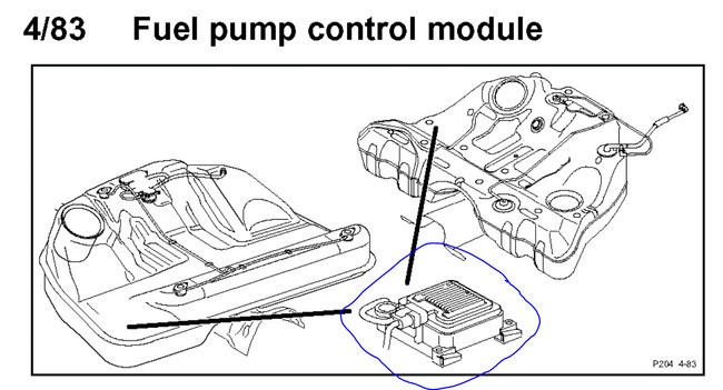

Where is the relay for the fuel pump? It's not under the hood. I have the panel under the steering wheel off but it's very difficult to see fuse box.

This vehicle doesn't have a traditional fuel pump relay. Instead, The fuel pump control module powers the fuel pump and regulates the output of the pump. See the pic below for the location.
