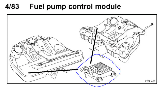

Fuel pump relay location
2006 VOLVO S60
185,000 MILES • 2.5L • 5 CYL • TURBO • 2WD • AUTOMATIC
NATUREGIRL79
Where is the relay for the fuel pump? It's not under the hood. I have the panel under the steering wheel off but it's very difficult to see fuse box.
Jan 29, 2021 at 9:26 AM
  • 110,244 POSTS
This vehicle doesn't have a traditional fuel pump relay. Instead, The fuel pump control module powers the fuel pump and regulates the output of the pump. See the pic below for the location.
