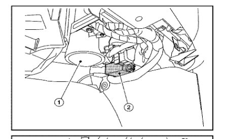

Where is the fuel pump relay located?
Jul 19, 2016 at 3:40 AM
RIVERMIKERAT
  • 6,110 POSTS

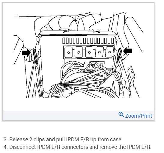

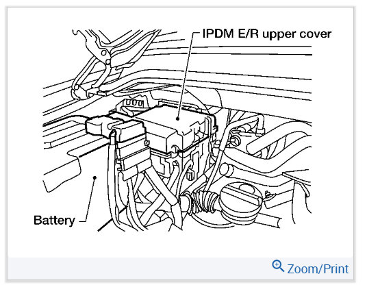

In a 2010 Nissan Armada, the fuel pump relay is located in the engine compartment fuse and relay box. Here's how you can locate it, but I have seen the relay be "bult in" to the IPDM so it will be not serviceable. Check out the diagrams (Below). Please let us know what happens.

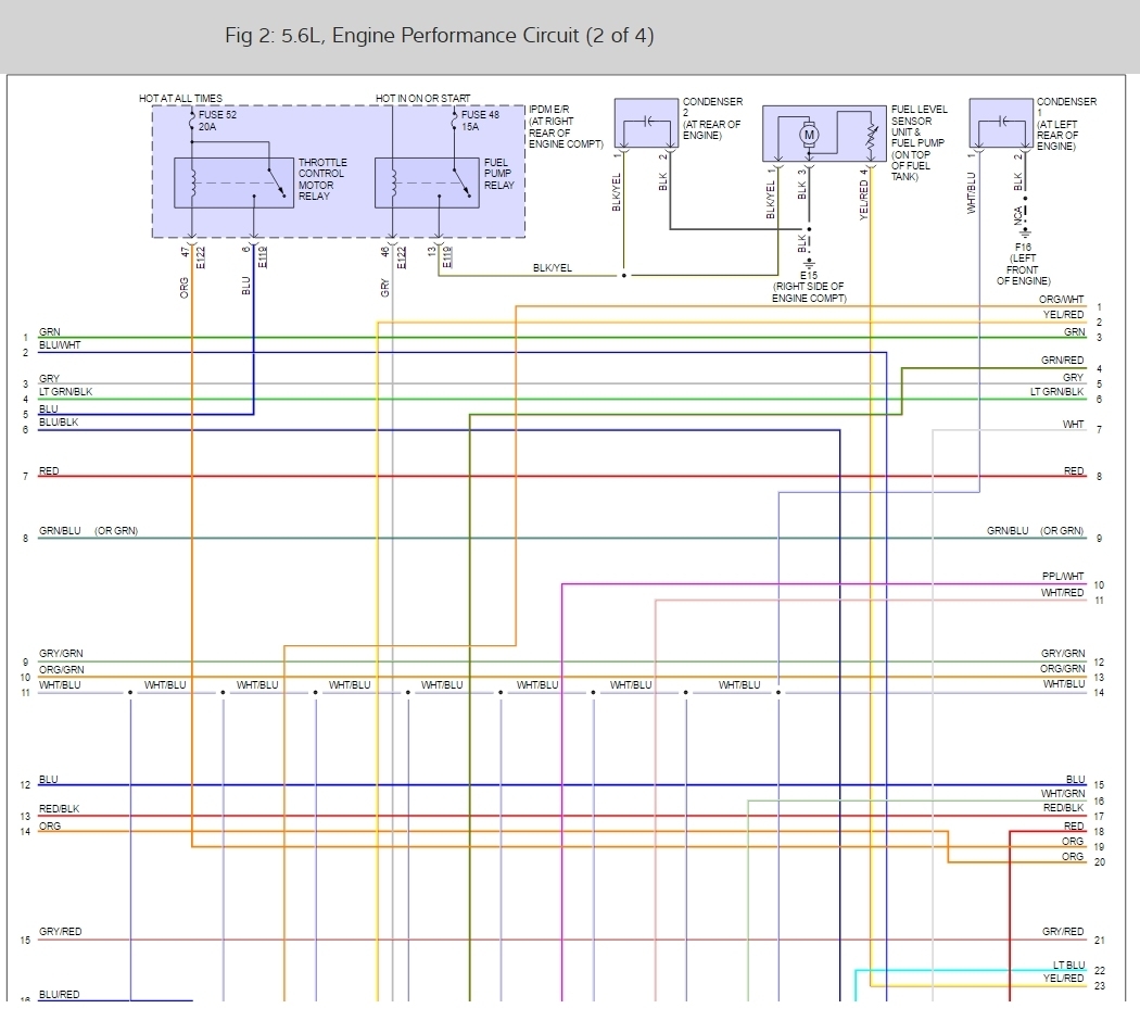

Can you tell me which relay it is? They are not telling me.
Sep 3, 2016 at 4:26 AM
  • 55,214 POSTS
I found this diagram for you that shows the wiring colors and the location of the relay you will need to match the wiring color to the relay be sure to check the fuse #52.

Hi Ken, Thanks for taking the time to answer my question and also for the diagram. I must be getting old because it seems like my eyesight is going! Is there any way I can blow that diagram up? Thanks again!!
Sep 3, 2016 at 9:45 AM
  • 55,214 POSTS
Just click on the image in the above post.
