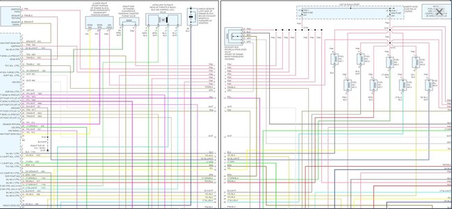

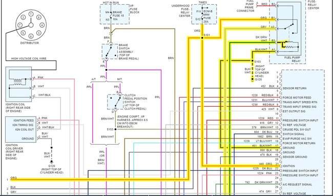

Fuel Pump Relay won't energize when key is in on or crank positions. Tests on the relay, ECM B fuse, jumper to fuel pump and fuel pump relay slot B1 all check out operable at 12v. Is the EMC/VCM easy to test? What is left to test?
Jan 17, 2022 at 1:50 PM
Good morning,

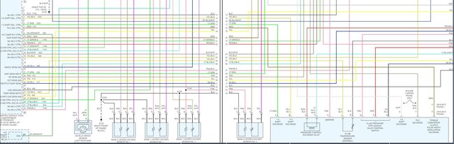

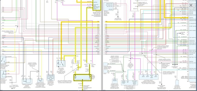

I attached a wiring diagram for you to view. This system may have two fuel pumps. There may be a second on the frame rail and need to verify.
The fuel pump relay has 2 feeds. Pin 30 is a constant battery voltage. Pin 85 is power from a fuse as well. Pin 86 is a ground to the ECM. The ECM should close the relay for 2 seconds with the key on for priming. It will close all the time while cranking and running.
The ECM test is performed with special equipment. We can only verify that the ECM is not grounding the relay. If that is true, then the ECM is a failure.

Single fuel pump, in tank.
With multimeter:
Slots 86 and 87 drop to 9v when cranking.
Slot 85 with Key off is 12v, 0v when cranking.
Slot 30 with key off is 12v, 9v when cranking.
Fuel Relay energizes for 2-sec prime, still won't start.
Fuel pump starts when jumped. 87, 30

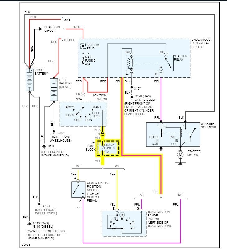

Inside cab fuse box found, #8 fuse (crank) circuit open, but 10A fuse not blown. Found 73 ohms to ground top half of fuse slot.
Seems to be another problem?

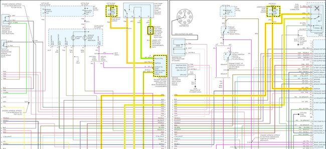

When the relay energizes, does pin 30 have power for that 2 seconds?
If it does not then the relay is bad.

Does the #8 fuse (crank) circuit seem okay?
Jan 19, 2022 at 5:36 AM
That is for the crank circuit.
You need to test the gray wire at the pump connector for power surging the 2 second prime.
Check that voltage.

Wasn't #8 but some other fuse/s I touched.
Jan 20, 2022 at 7:18 AM
Fuse 8 is for cranking only.
Should have nothing to do with the fuel pump.

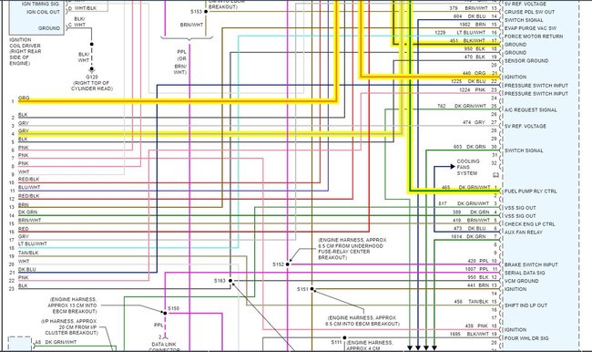

I noticed it has been a couple of days since contact has been made. Have you made any progress?
If not, I have a couple of questions. I read through all the posts above and need to confirm this is a fuel pump issue only and has nothing to do with the starter.

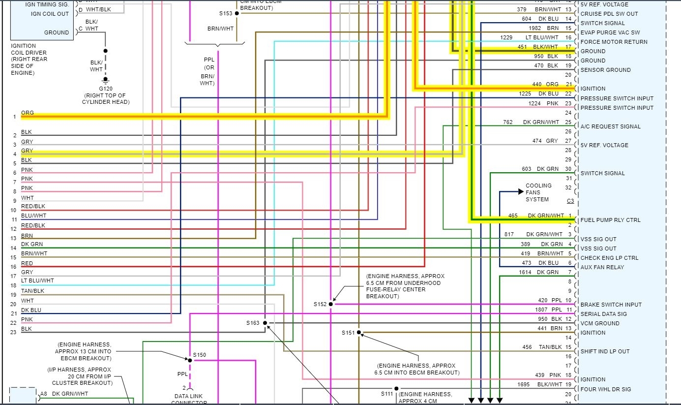

Also, the orange wire from the ECM-B fuse can only reach the gray wire to the pump if there is power at the dark green wire with a white tracer and a ground is provided via the black wire with a white tracer. Are these two wires working properly? Note, the power supply to the relay is from two different sources. It seems the red wire for the prime is working, based on what I read. I need to know if the dk green/white provided power to actuate the relay.
PS: Sorry to jump in. You may have already done all of this.
Jan 23, 2022 at 9:40 AM
3CARPRO
  • 15 POSTS
Thanks.
Don't think it's the starter but wondering if the Crankshaft position sensor is bad causing ECM a no start. Jumped the fuel pump at relay box to check pressure and got low 18PSI at the fuel rail. Also got 0.8 ohms on the pump at outside tank connector. A new fuel pump is 2.8 ohms. But yes, 12v on control and load sides but will check green/white and black/white tomorrow.
