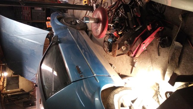

I believe my fuel pump has gone bad, but to test it I was going to jump the relay to see if i could get it to work or not. but, I cannot find the diagram online for what wire is what on the relay. The car has been sitting parked for about five years it ran fine when I parked it though. But what is a long time for a car to sit without being started. The car will try to start with the external fuel pump I wired but the pump is too small so it is not getting enough gas. It will run for about three seconds and quit. So before I go trying to replace the fuel pump which I dread I want to make sure it is bad first.

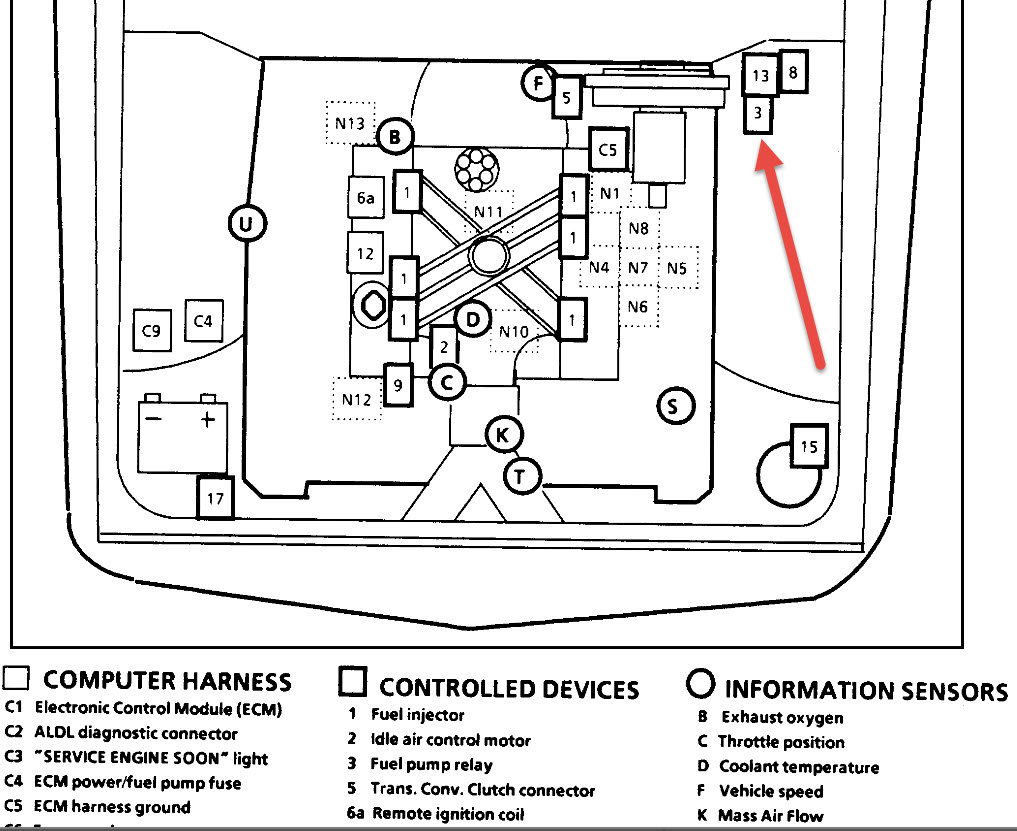

if the pump you wired in is working then the relay is probably bad. This guide can help us test it. Here is the relay location in the diagrams below.

where is the fuel pump relay located on a 1989 camaro?

[quote:0c74767a8b="greg1971"]Electrical problem
1989 Chevy Camaro 6 cyl Two Wheel Drive Automatic 149000 miles
WHERE IS THE FUEL PUMP RELAY LOCATED ON A 1989 CAMARO?[/quote:0c74767a8b]
On left side of firewall to left of brake booster

where is the fuel pump relay on 1989 camaro rs?

Check out the diagrams (Below) for the fuel pump locaiton. Please let us know if you need anything else to get the problem fixed.
https://images.2carpros.com/forum/automotive_pictures/561653_Fuel_pump_relay_89_Camaro_1.jpg
