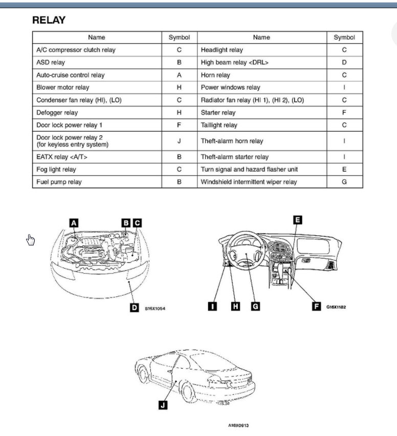

Not pumping gas or firing, fuel pump relay location needed
2000 CHRYSLER SEBRING
205,689 MILES • 2.5L • V6 • 2WD • AUTOMATIC
MICHAEL W WRIGHT
I have replaced the crank shaft sensor, the distributor that has the camshaft sensor built in, fuel pump, (I can't find the fuel pump relay). I have noticed that when you turn the key on it doesn't kick. the check engine light on and then it would go out... To my knowledge if that is happening it's your computer is that correct? I know I have put $400.00 for parts in this car and it has not helped anything...
Sep 20, 2020 at 8:29 AM
Just to clarify, when you turn the key on, the check engine light does not come on at all? You are correct that it should come on for about 3 seconds then go off. This is a self check and if it is not doing it then it is not performing this check. That is usually the module itself but it could be a power or ground issue.

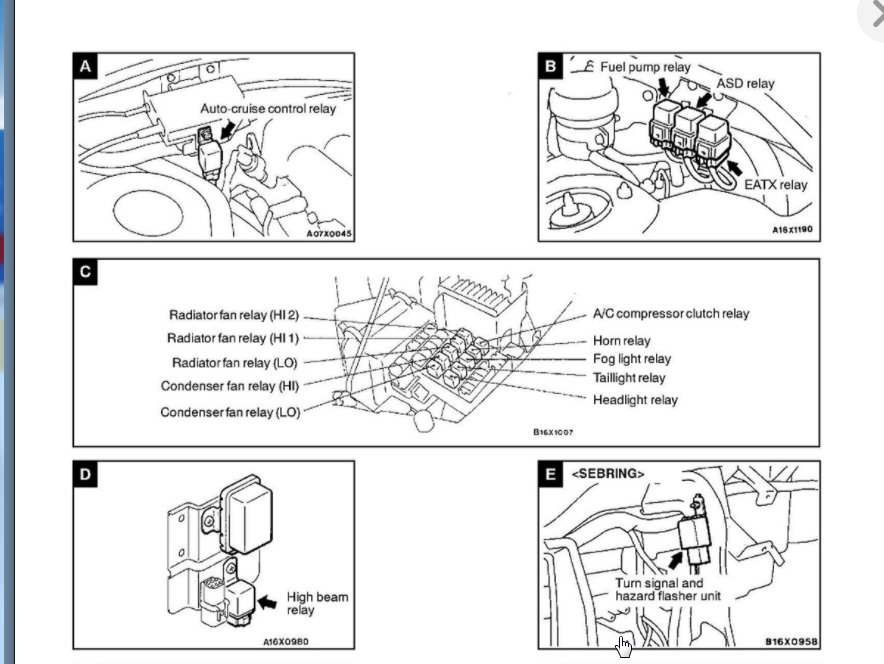

As for the relay, I attached the location.
Lastly we need to check for codes and go from there.
