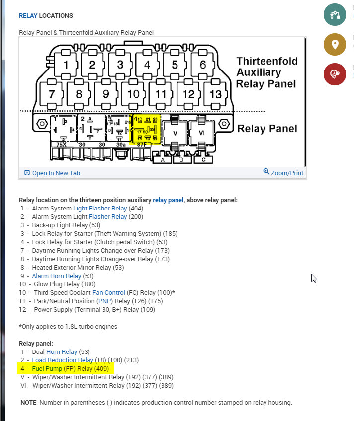

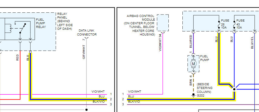

Where is the fuel pump relay?
Feb 8, 2020 at 4:44 AM
I attached the wiring diagram and fuse location in the panel. Check out the diagrams (Below). Please let us know what you find. Let me know if you need more info. Thanks.....................................

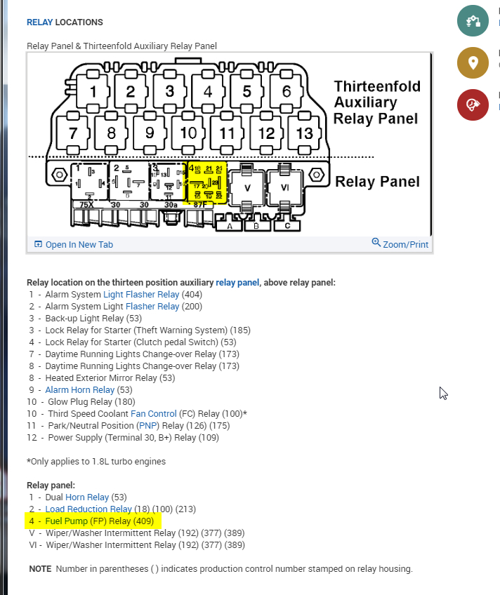

Good day, what’s the difference between starter relay 3 and 4? I am having issues with my 2000 VW Beetle and am trying to troubleshoot a “no start, just click”.
Thanks,
Robertfh
Oct 12, 2022 at 12:10 PM
  • 55,688 POSTS
No problem we can help you, but this question is for a fuel pump you must starter your own question about the starter issue.
