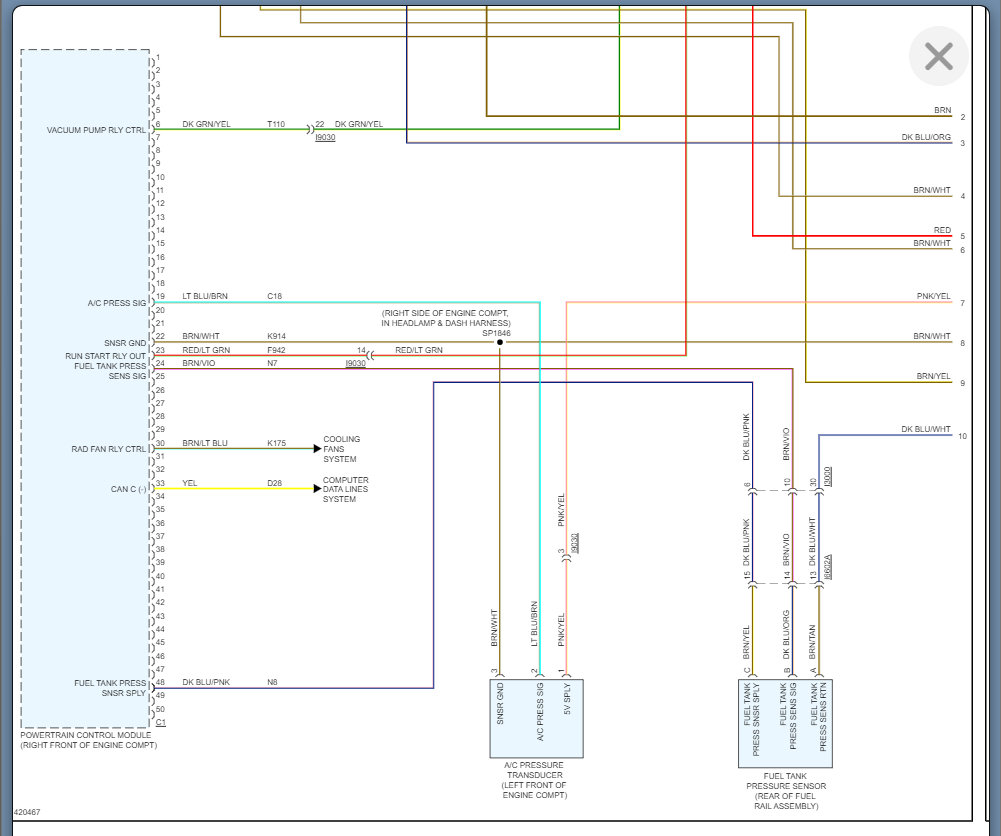

I can’t find the fuel pump relay on my vehicle listed above, Limited 5.7L Hemi. I have looked in the manual as well as the fuse box and I cannot find it. Please help.
May 1, 2022 at 12:01 PM

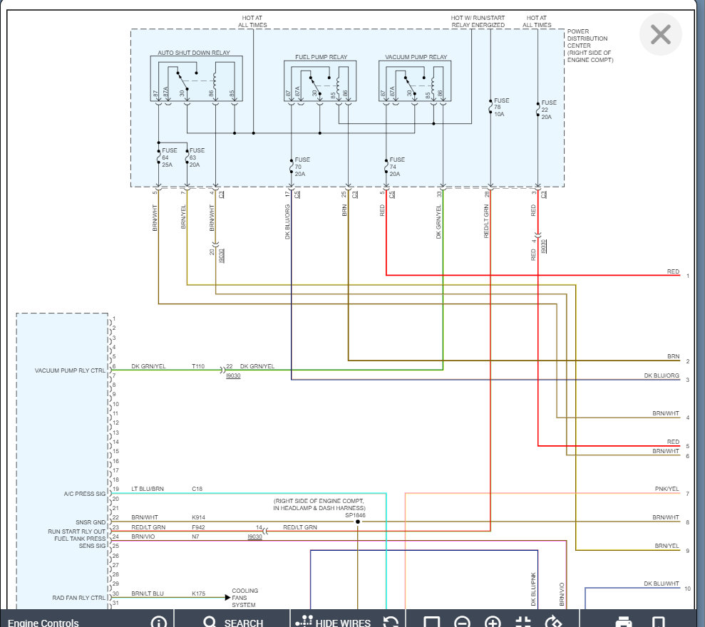

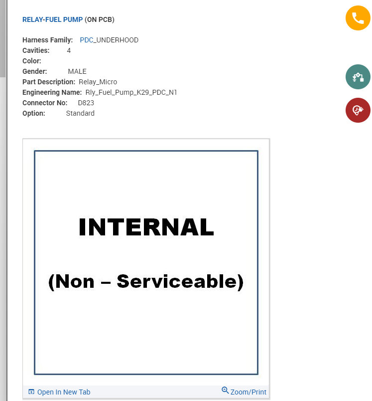

The fuel pump relay on this vehicle is internal to the PDC and not a serviceable relay.
You can test the circuits like a normal relay, but the relay is inside the PDC.
