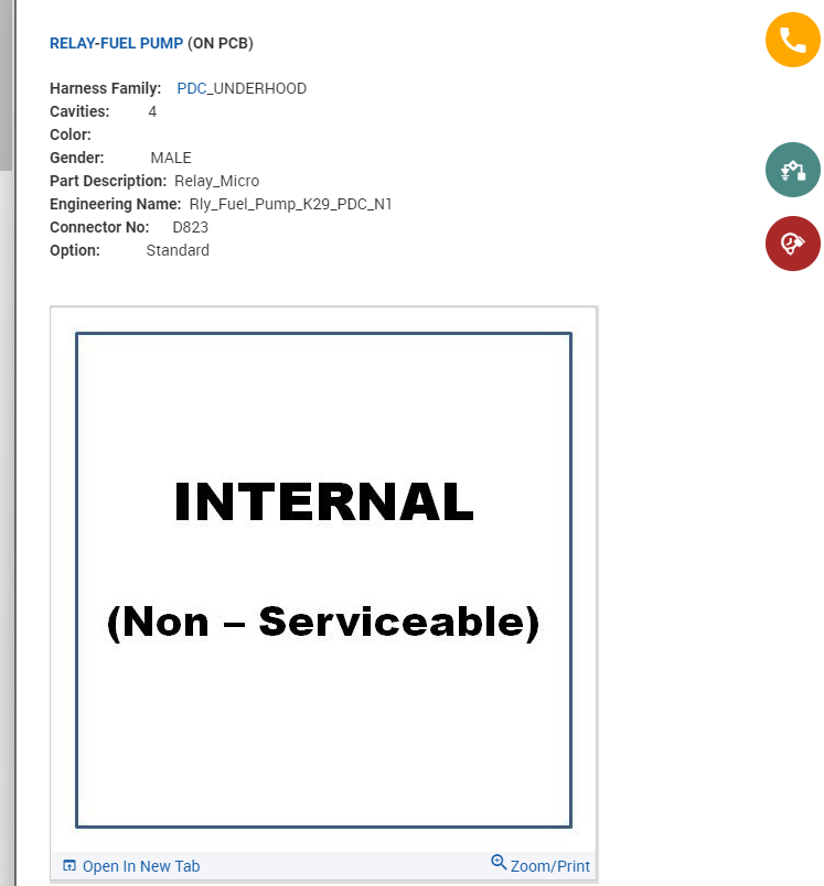

I can’t find the fuel pump relay on my vehicle listed above, Limited 5.7L Hemi. I have looked in the manual as well as the fuse box and I cannot find it. Please help.
May 1, 2022 at 7:01 PM

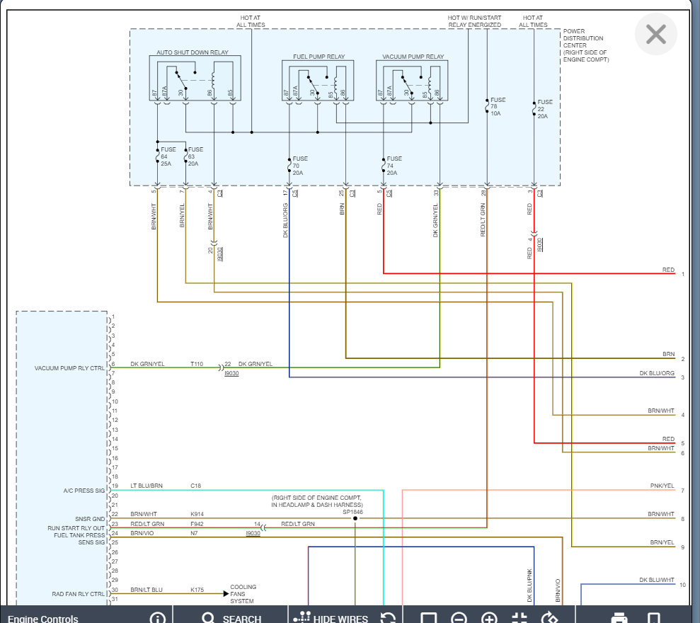

The fuel pump relay on this vehicle is internal to the PDC and not a serviceable relay.
You can test the circuits like a normal relay, but the relay is inside the PDC.

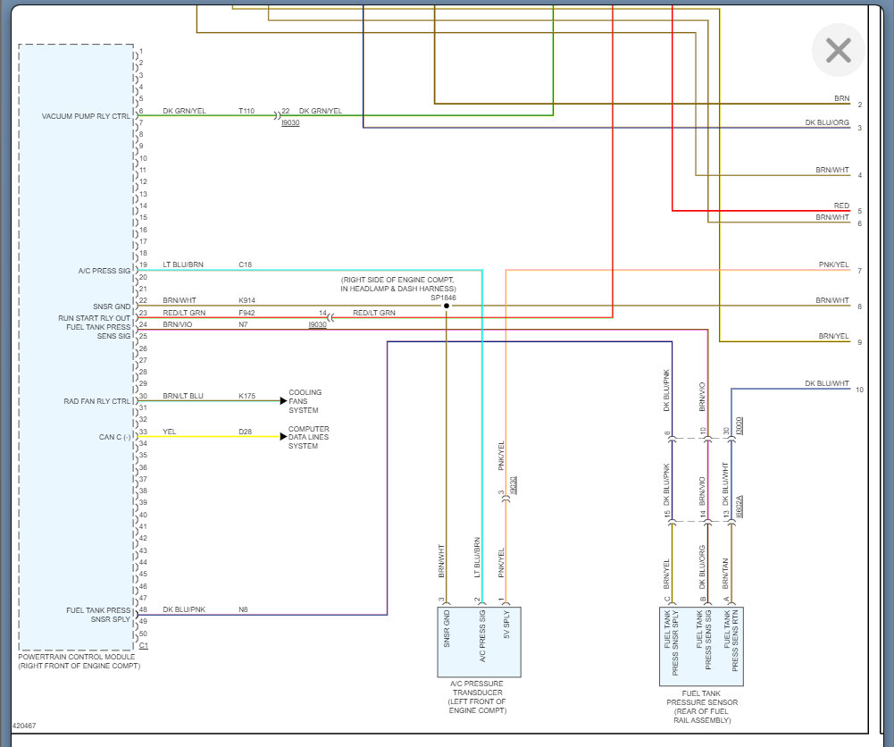

When the car is cold and we try and turn it on, it cranks for about 5 seconds, or even longer and then it starts. The colder the engine is, the more it does it. It used to do it once in a while, now it’s every day.
May 2, 2022 at 9:00 PM
This could be fuel related, so we need to start by checking the fuel pressure in order to confirm this.
This means we need to hook up a gauge and then check the pressure when it is doing the long crank.
