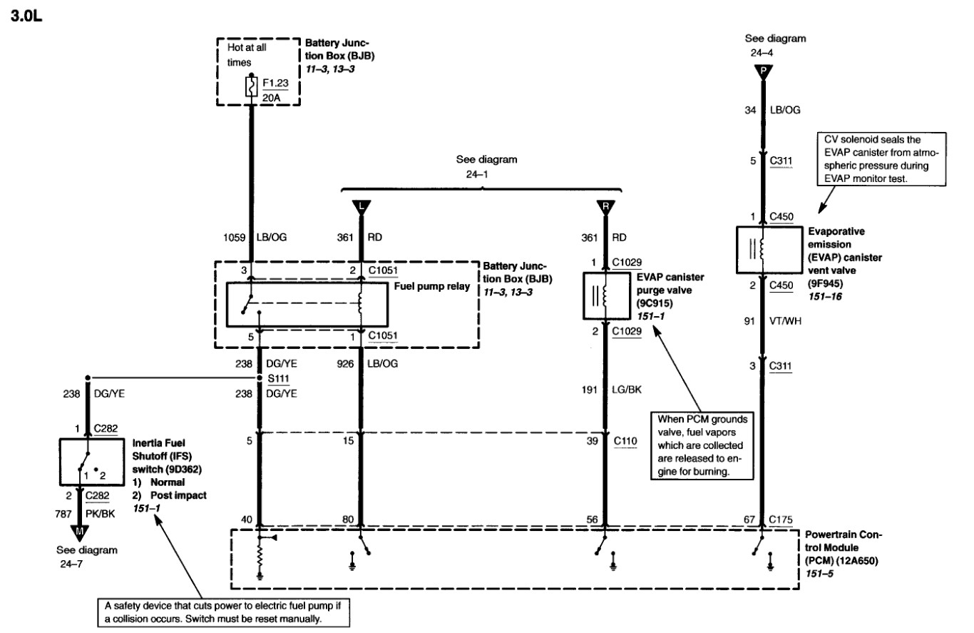

I know where the fuel pump relay is located in the fuse box under the hood. Where does it connect under the dashboard?

If you are asking about the control circuit for the relay, it doesn't really connect under the dash, it is controlled by the powertrain module mounted in the cowl panel on the right side of the truck above the engine. There is an inertia switch in that same area. No other control for the pump exists.
