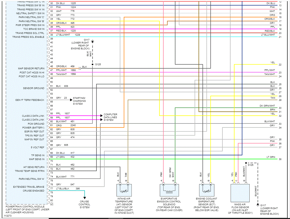

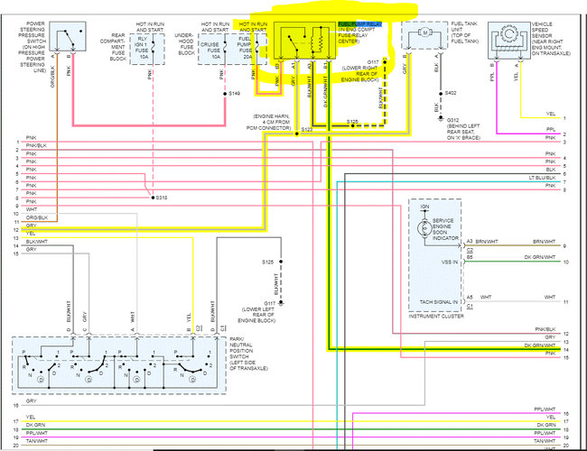

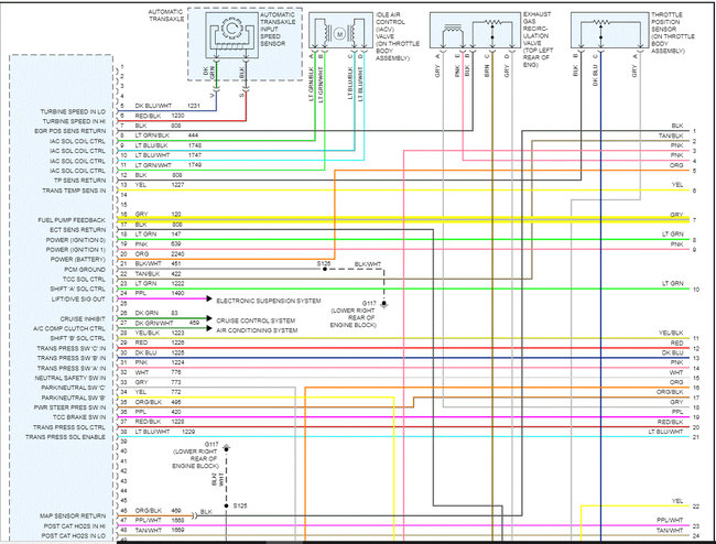

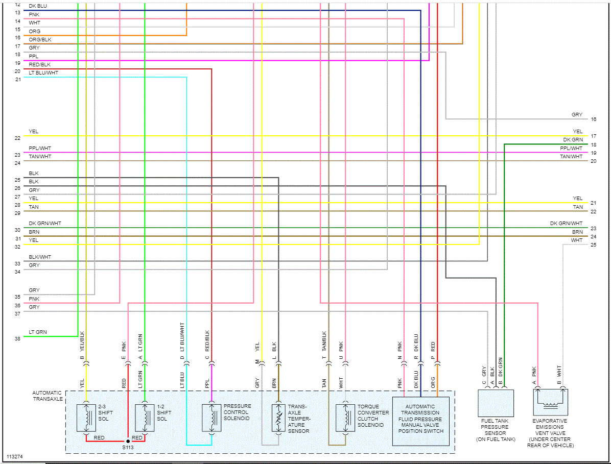

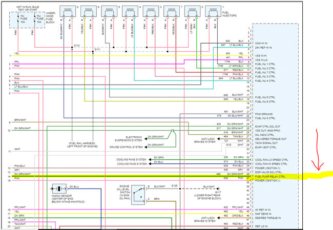

No power to the coil of the relay. Where does the green and white wire come from? fuses good, new relay. pump works if I jump around the relay. I need to find where the green and white wire comes from and check that circuit.
Jun 7, 2022 at 12:04 PM
  • 110,194 POSTS

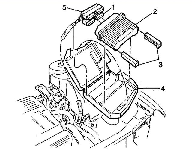

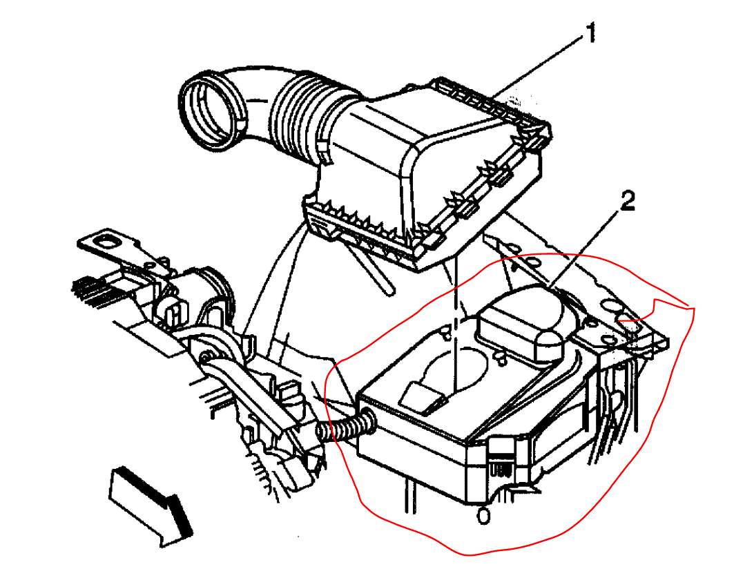

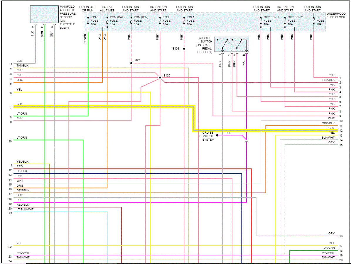

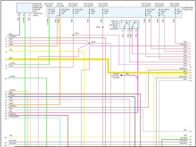

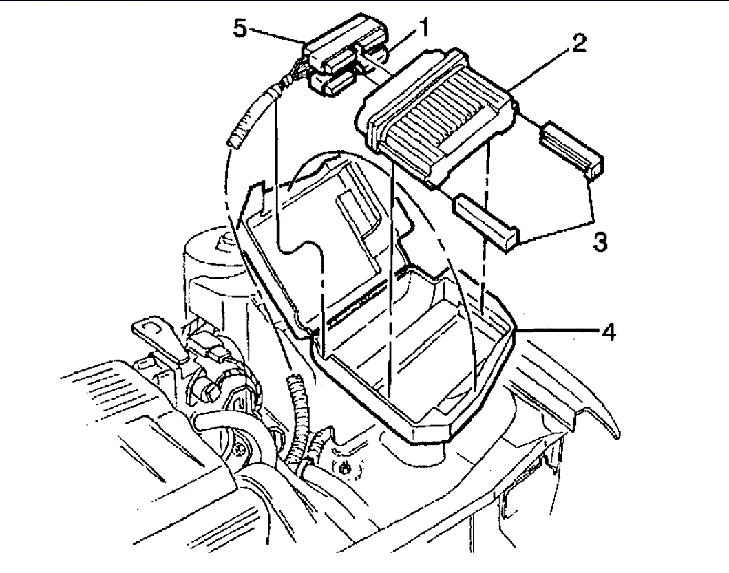

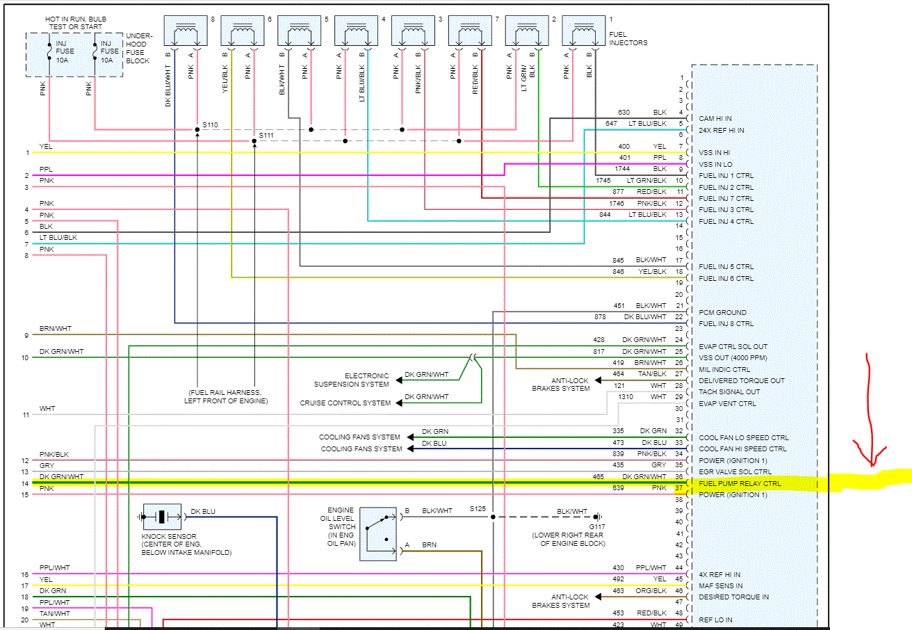

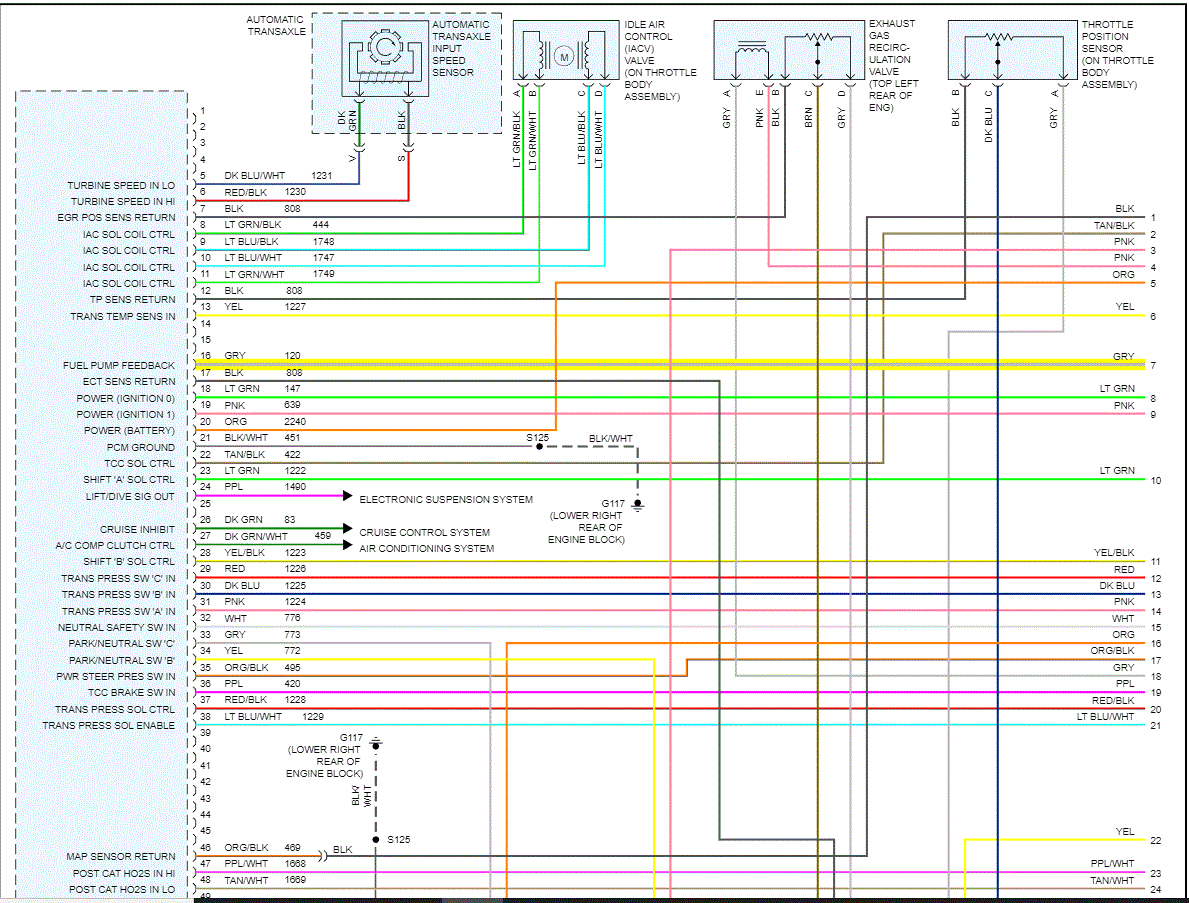

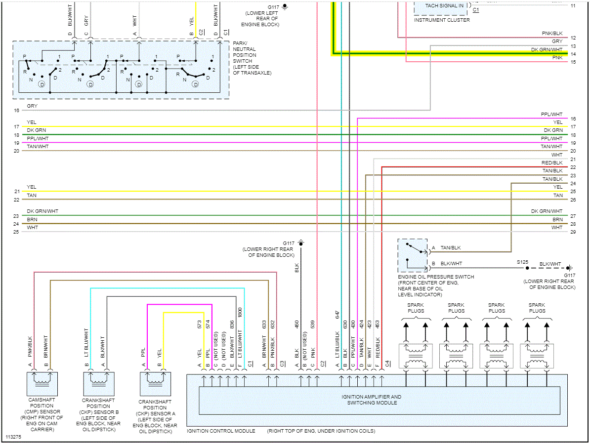

The green and white to the relay primary is from the powertrain control module (PCM) located below the air box in the air inlet housing. (Pin 36) (See the last two pics for location)

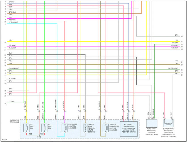

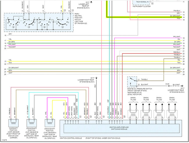

I attached the entire powertrain management schematic for you. It is four pages, but I did highlight the wires related to the relay.
Note: To make each page readable, I had to cut it in half. I did overlap each one so you can follow it.
Let me know if this helps or if you have questions.

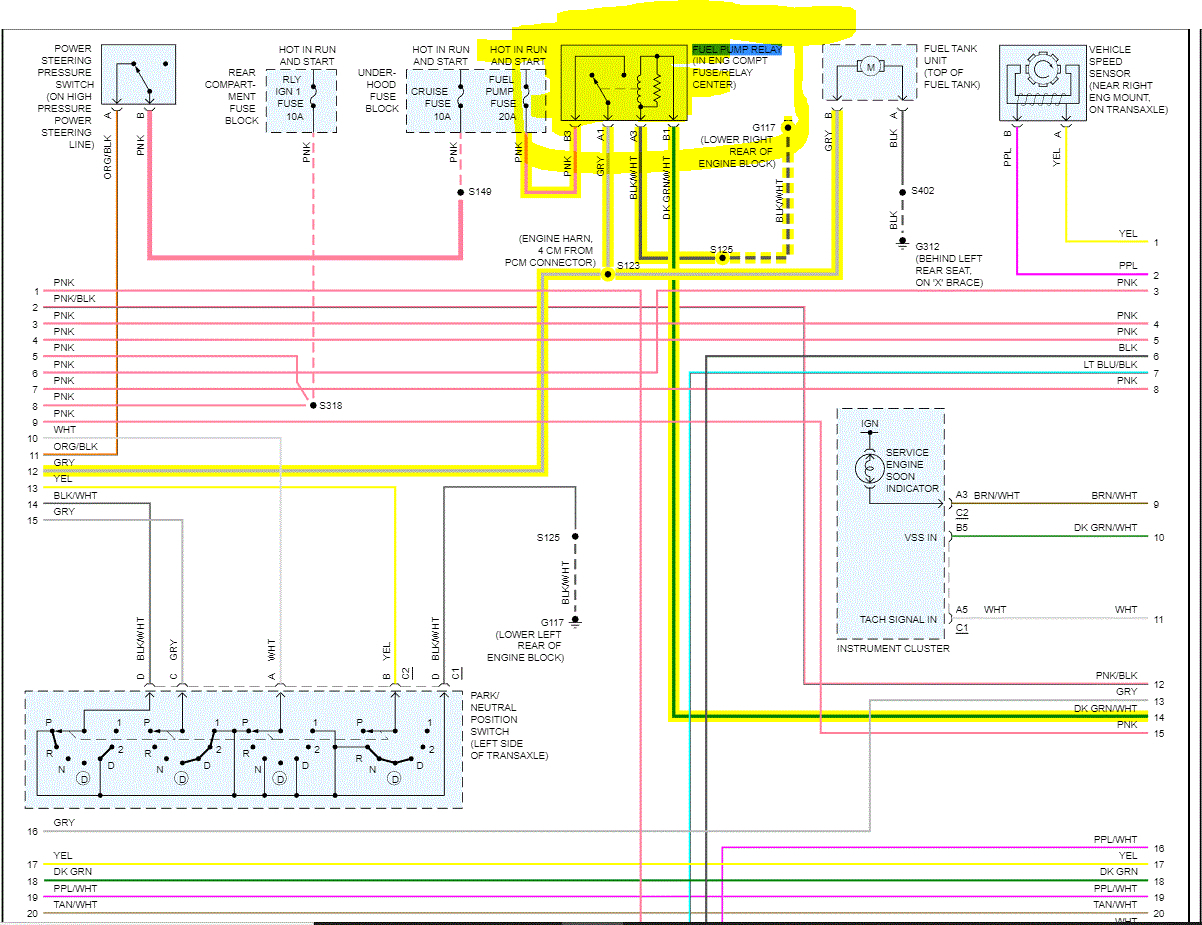

The PCM controls it. The fuel pump relay allows the fuel pump to be energized by the PCM. When the ignition is first turned "ON," the PCM energizes the fuel pump relay for two seconds. This allows the fuel pump to run for two seconds and builds up fuel pressure for cranking. The PCM then waits for ignition reference pulses from the Ignition Control Module (ICM). Once the PCM sees reference pulses, the PCM energizes the relay to run the fuel pump.
Did you check right at the PCM for power?
Jun 9, 2022 at 8:12 PM
BUTCH GA2
  • 8 POSTS
I do have a 2 second pulse at the relay green and white wire.
Jun 10, 2022 at 1:45 PM
  • 110,194 POSTS
If you do have a 2-second pulse, then the PCM is sending power to the relay coil to energize it. If the pump still isn't turning on and the relay is good, and the secondary side of the relay is getting power, then that leaves a faulty ground to the primary. It will be a black wire/white tracer that attaches to the lower right sides of the engine.
I looked at the schematic again, and I noticed there is a splice. Check for continuity to ground and wiggle that ground (black/white) wire around to see if you are losing ground. The splice may be corroded or coming apart causing a weak ground.
It's a theory at this point, but the other things seem to be working properly.
