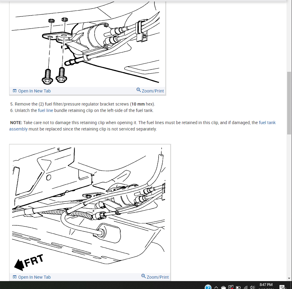

My Saturn sl2 02 has 289k so I have replaced parts honestly at random trying to get the rough idle to stop. I had a problem with when I was cold I couldnt turn the crank to start it up or it woulsnt turn over. I had to turn the key leave it for a second s*** it off then attempt to start it, it would fire right up. So I got a fuel pressure regulator to replace mine. But never got around to it and now I'm find it harder to locate than I thought. Probably right in my face but a tip would help
Mar 26, 2021 at 2:33 AM

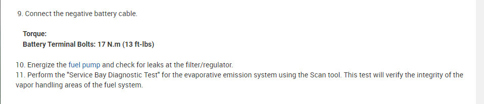

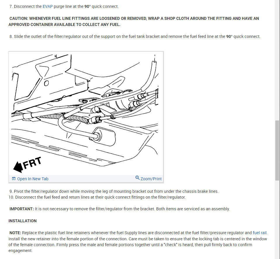

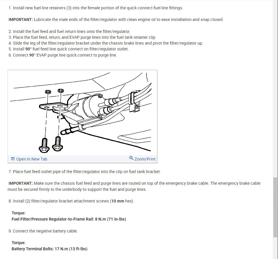

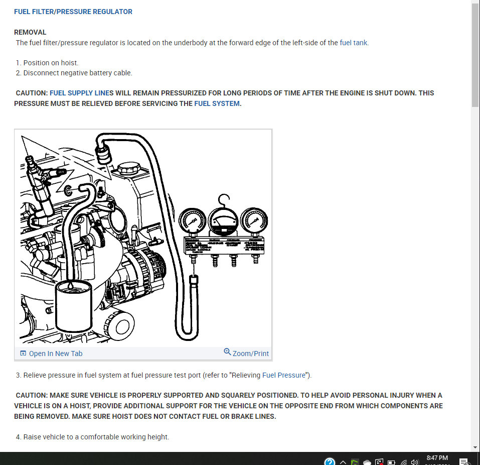

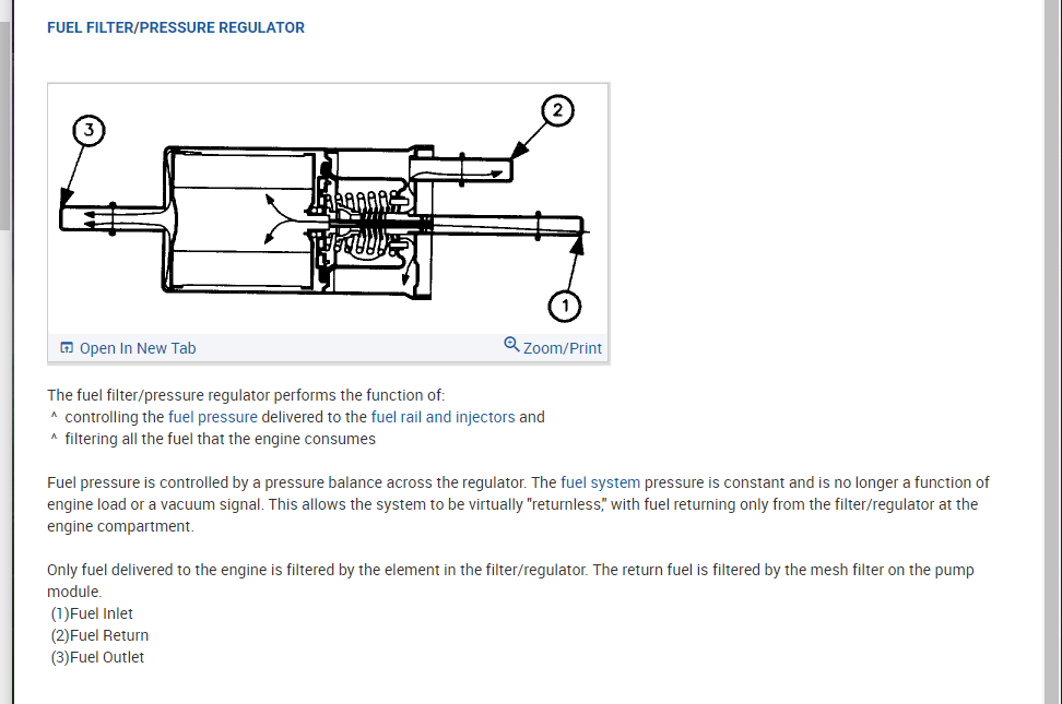

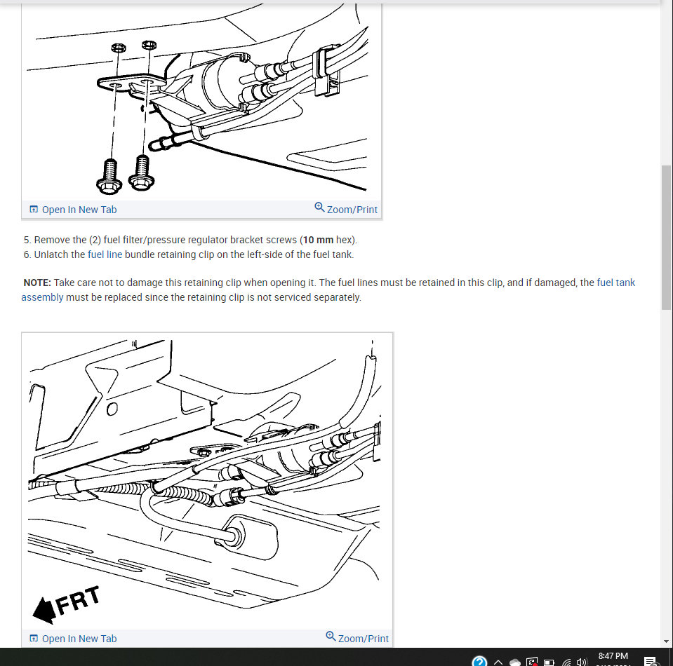

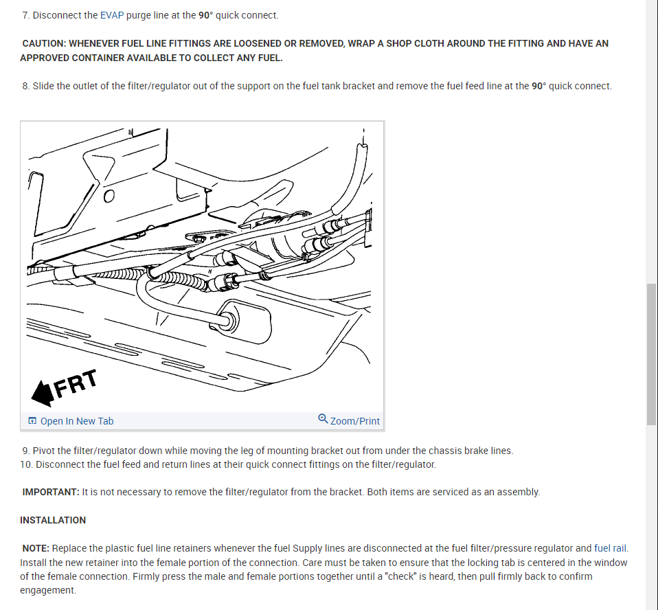

This regulator is part of the filter on this engine. So you will need to replace this in order to replace the regulator.
Below is the process from the manual that will help with replacing this.
Please run through this material and let us know if you have other questions. Thanks
