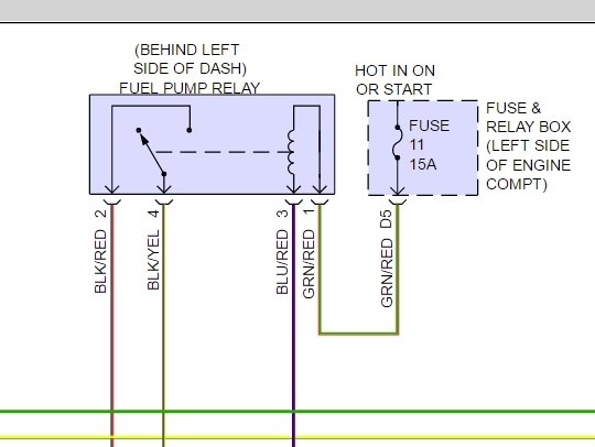

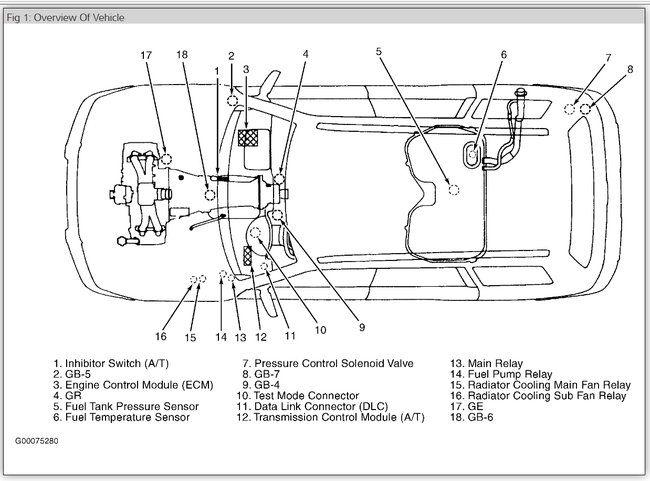

Pump is not working. I would like to see a diagram of the fuses or location of the pump regulator.
Sep 17, 2016 at 6:33 AM
  • 55,694 POSTS
Hi STACEY,

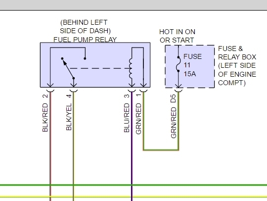

It looks like the relay is about mid way back and the fuse is in the fuse box on the left side of the engine. the pressure regulator looks like it is internal in the pump.
Here are some diagrams for you.
Please let us know what you find so it will help others.
Best, Ken
