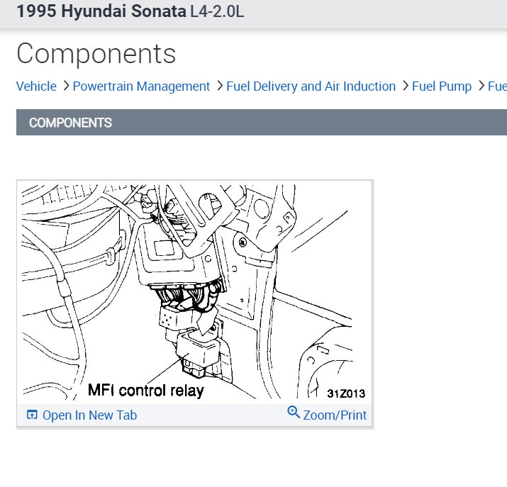

Fuel pump relay location needed.
Sep 23, 2022 at 10:19 PM
MIKE H R
  • 3,094 POSTS
Center of dash, on bracket under radio, under engine control relay. Check the image (below). :) If there is just the engine control relay then it does both jobs the fuel pump and engine. Let us know how you make out.
