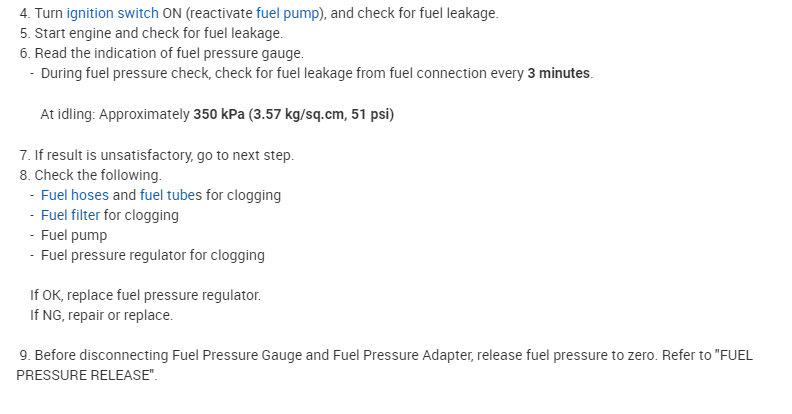

Fuel trims are about +9 combined at idle, and + 7 at cruise. Idle fuel pump pressure 43 PSI, but drops to about 35 at snap throttle, is this, okay?
May 16, 2022 at 10:30 AM
SQM
  • 6,383 POSTS

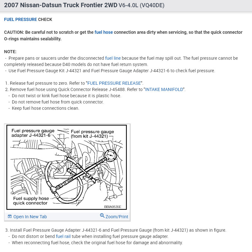

With the engine idling the fuel pressure should be at 51 PSI.
So being at 35 PSI, it is lower than it should be.
What kind of issues are you facing?
I have attached the fuel pressure test procedure below for your reference.
Let me know of any questions.
