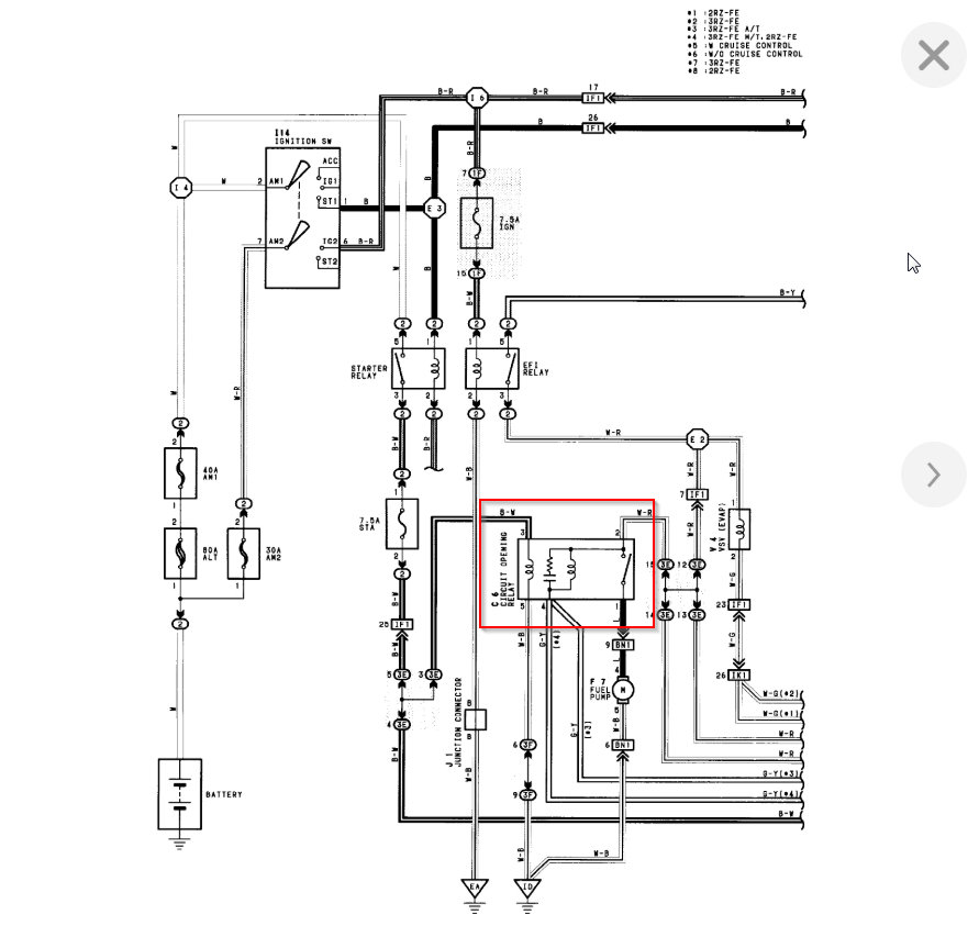

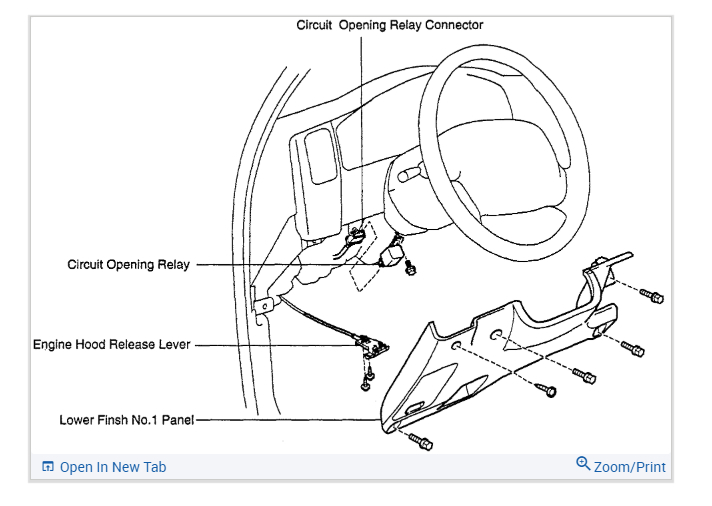

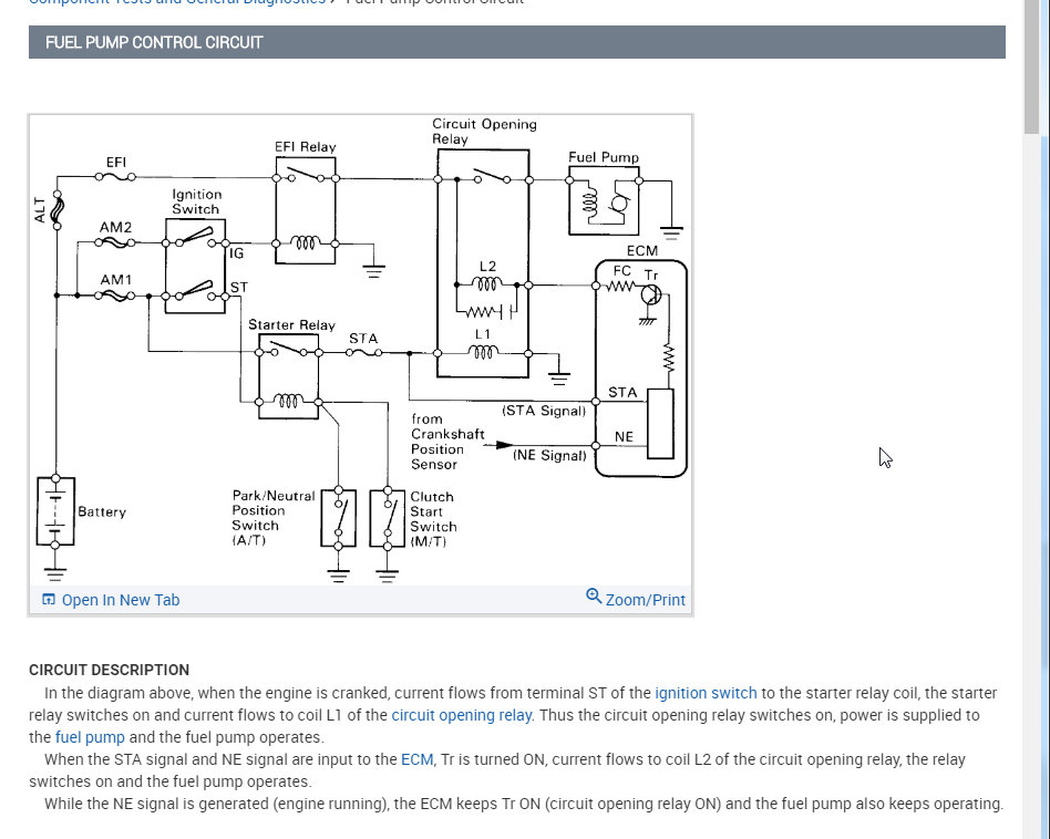

Need to know where COR is located.
May 18, 2020 at 4:18 PM
I attached the information on the circuit opening relay.
Also, here is a guide that will help with testing a relay in case you need this help as well.
Also, in case you need a little more info on how to use a meter which is helpful in these cases.
Please let us know if you need more info. Check out the diagrams (Below). Please let us know what happens. Thanks
