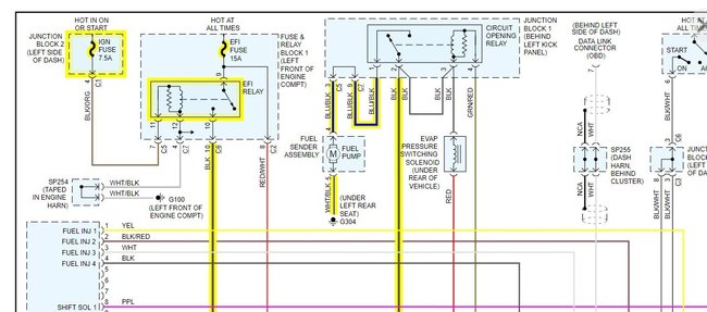

Car does not want to start. replaced starter, fuel pump, spark plugs. still does not want to start. could it be the fuel pump or fuel pump relay?

No, I don't hear the fuel pump turn on. And no spark.
Sep 21, 2019 at 8:02 AM

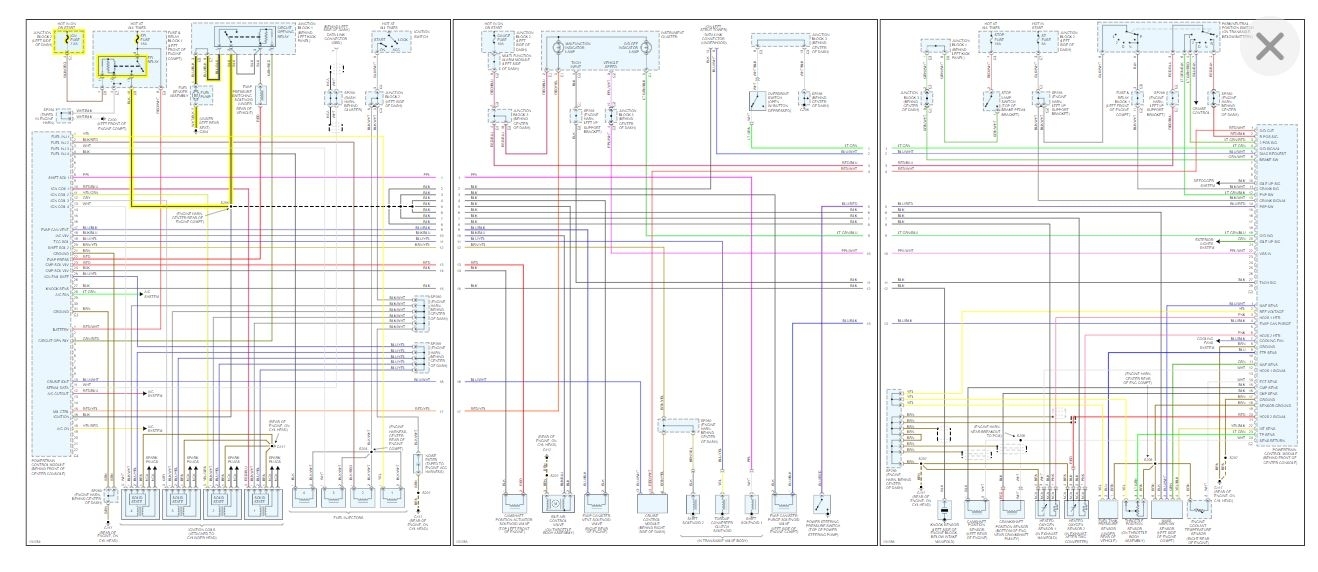

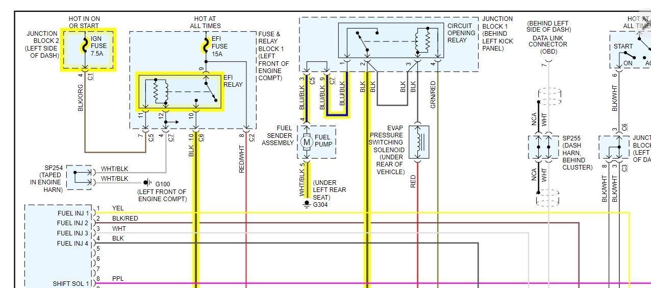

Okay, I attached a wiring diagram for you to view. Check the fuses listed for power on both sides for power with the key on. This is not a visual inspection, it is a voltage check.
There are 2 relays involved but testing must be done to determine the failure.

Okay, go to the EFI relay and remove the relay and make sure there are 2 powers with the key on.
If there is, install the relay and see if it clicks or turns on.
