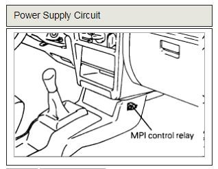

The pump is bad. When you run a hot wire to it, you end up with just a little extra juice getting there, helping it to get turning. This also explains the hesitation and bad running, as the fuel pressure is not as strong as it is supposed to be. To confirm, probe the lead wire at the fuel pump with a multi-meter. It should get some power when you turn the key on (two to three seconds) and when cranking. I will look up the location of the relay in a few minutes so you can check it (if there is no power at the pump) and post it below.

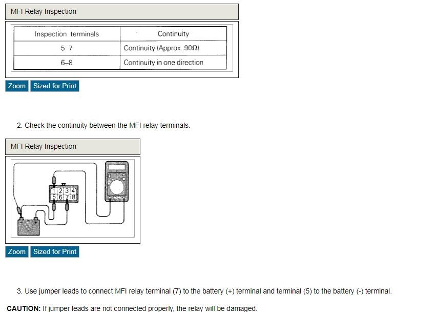

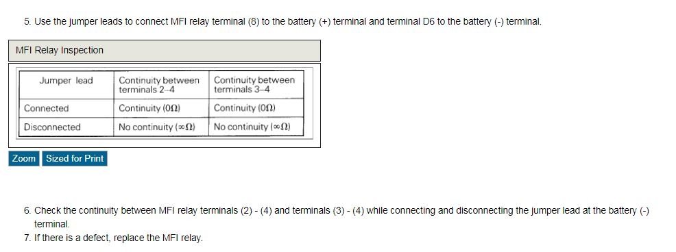

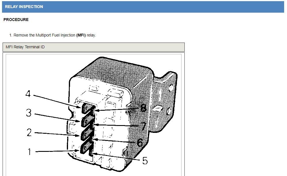

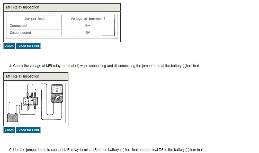

Here is some information on the relay and how to test it.

I got to the plug for the fuel pump disconnected and turned key with probe light on not any voltage found the MFI relay will I need to take the whole dash out cannot find any way to get to It I am figuring relay or broken wire or connection. any thoughts?
Dec 17, 2017 at 5:29 AM
JIMGABBARD58
well got the MFI relay out and did testing as prescribed it's all good so what is telling the mfi to work possible new controle module ?

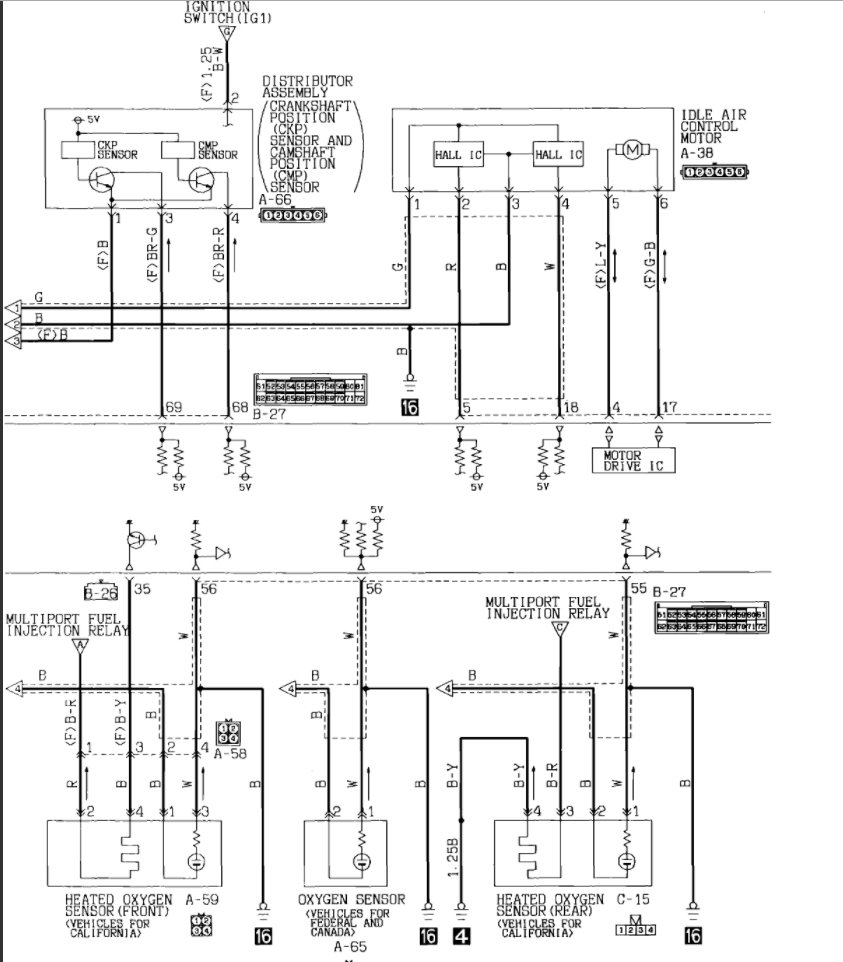

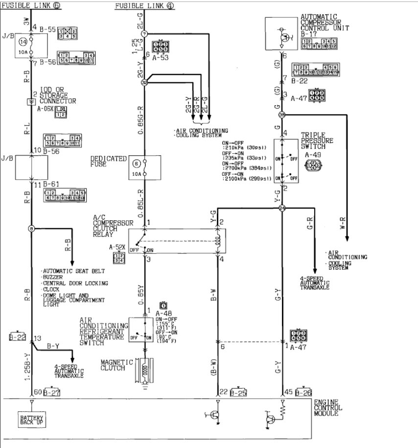

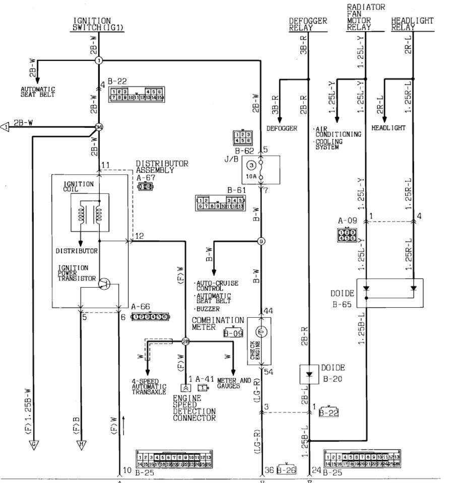

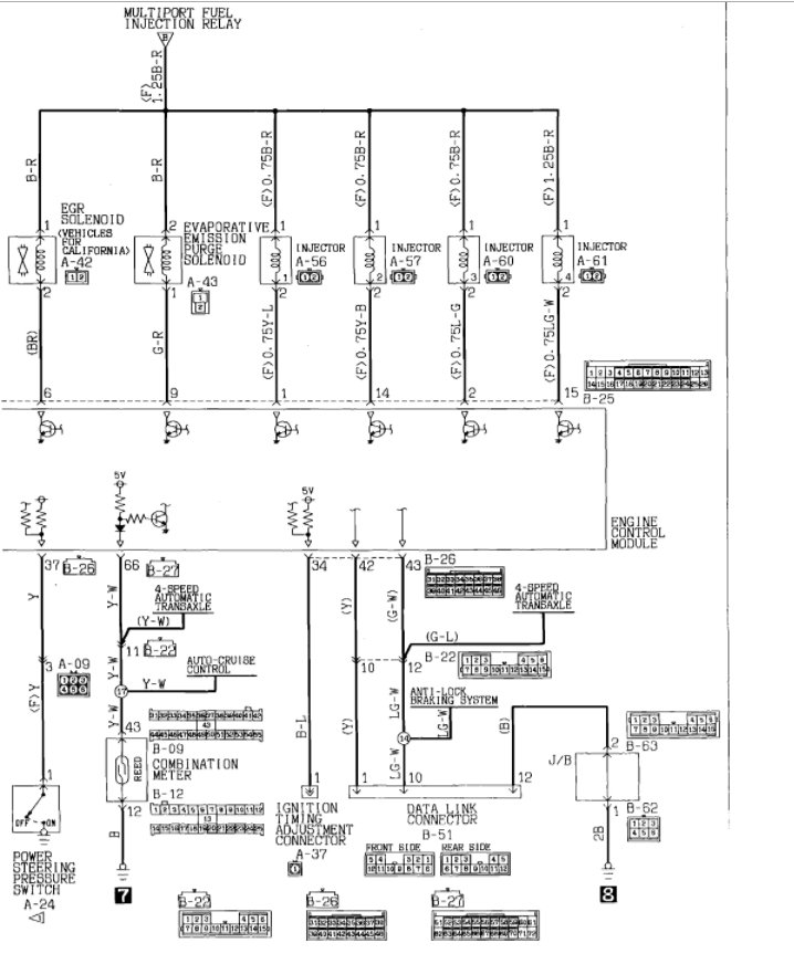

  • 55,399 POSTS

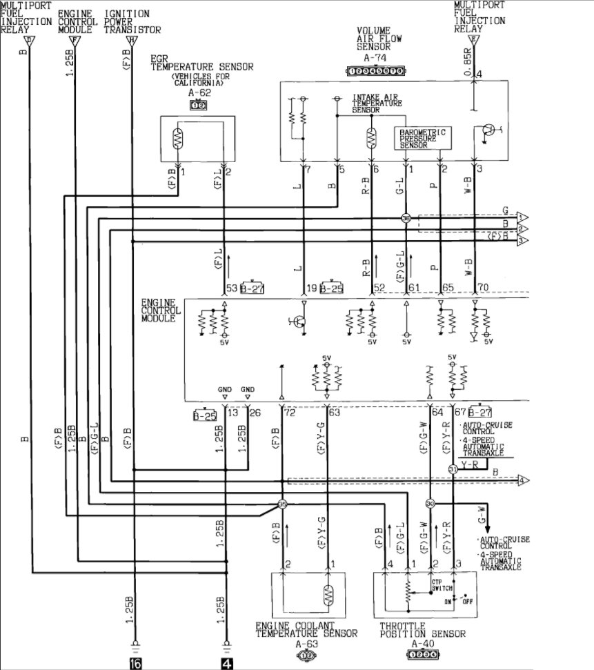

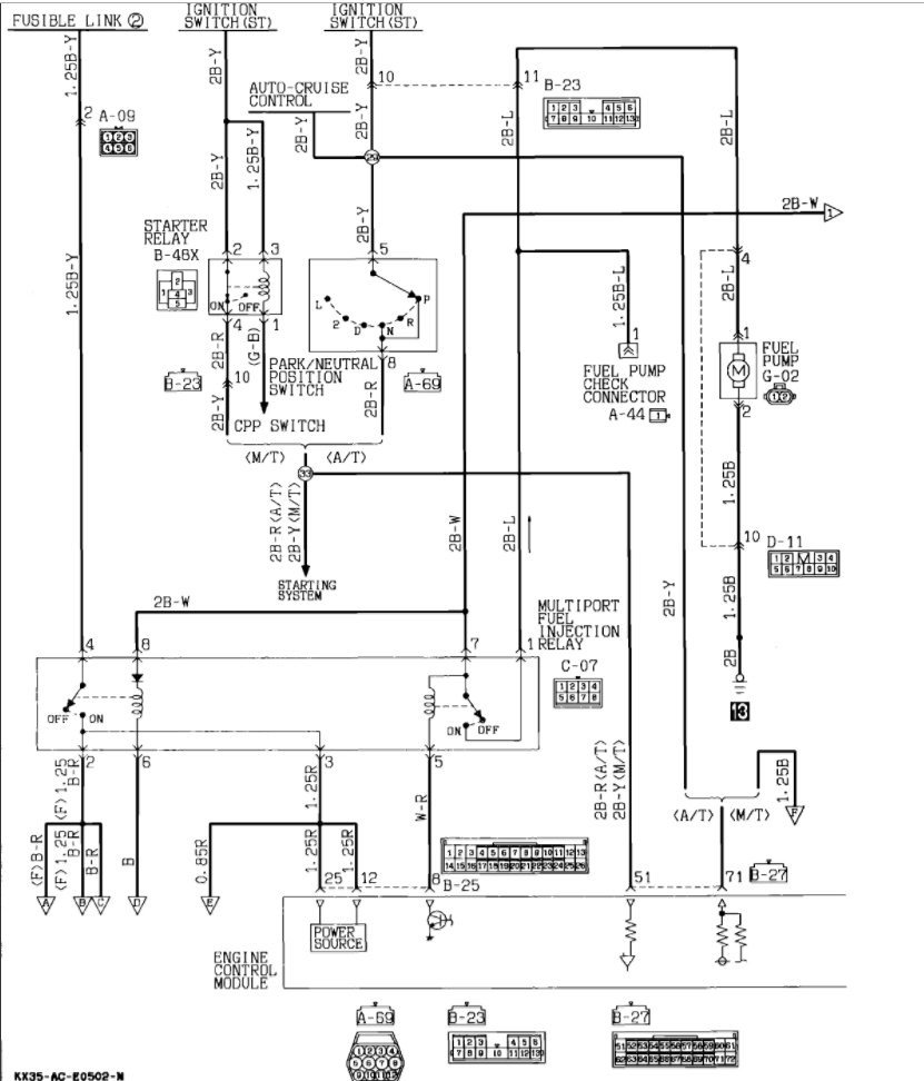

If I may jump in here. It sounds like you have lost a power feed to the system like a fusible link is bad. Please use a test light and check for power on both sides of the link.
Here are the engine and fuel pump wiring diagrams so you can check power and ground of the system:
and
