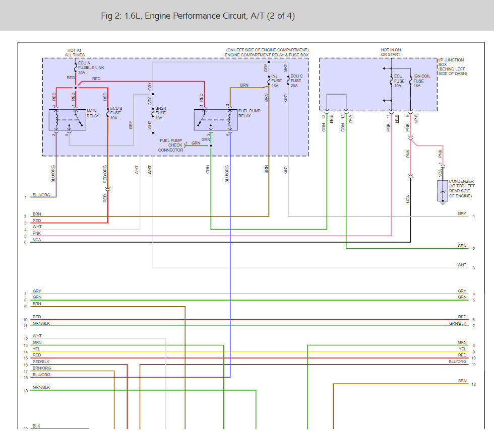

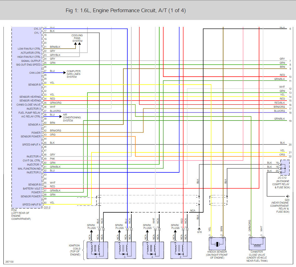

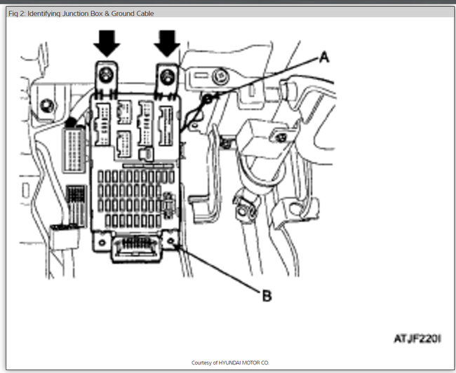

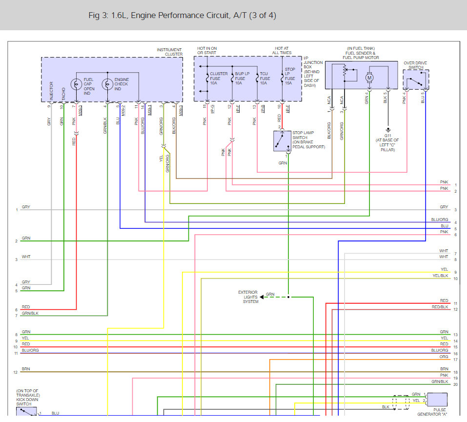

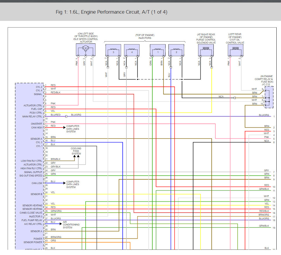

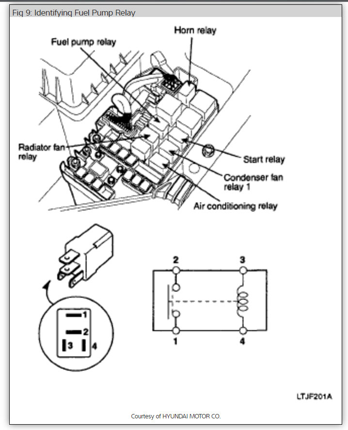

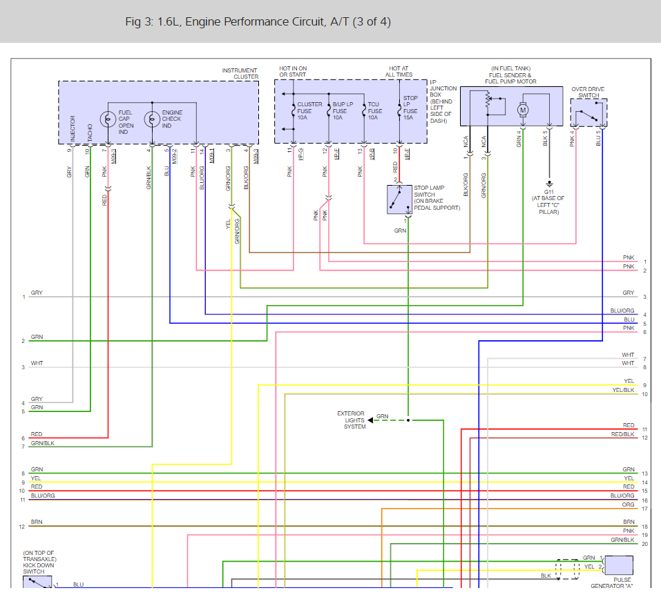

There is no power getting to the pump.
Aug 17, 2017 at 3:28 AM
Experienced Mechanic
55,616 POSTS

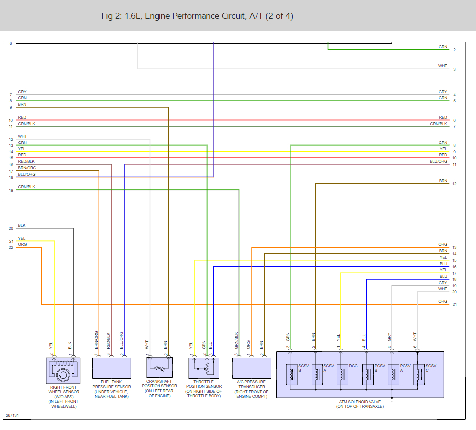

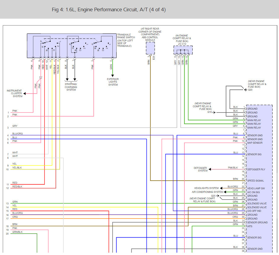

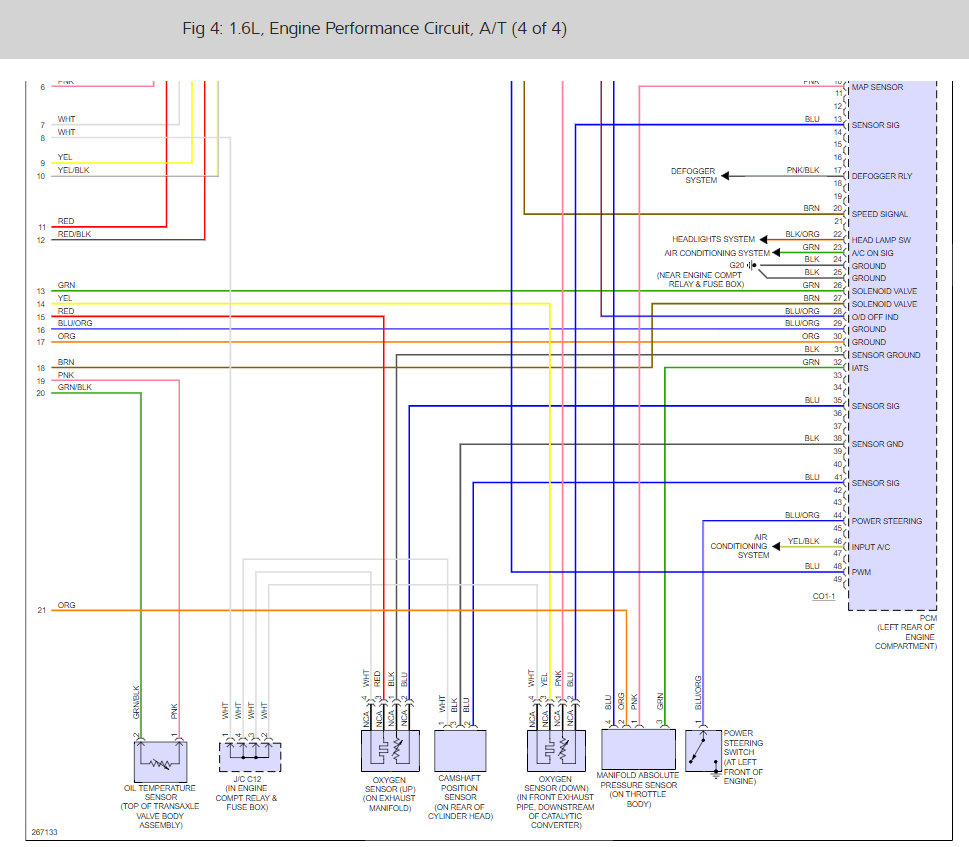

There is a fuse and a relay that can be causing the problem of the pump not getting power. Here is a guide that will help you fix the problem with some diagrams below.
and
Please let us know what happens so it will help others.
