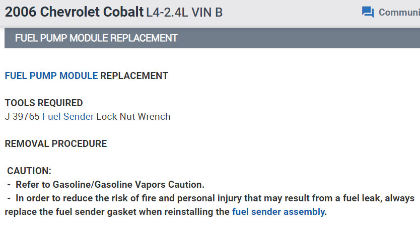

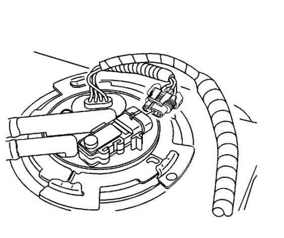

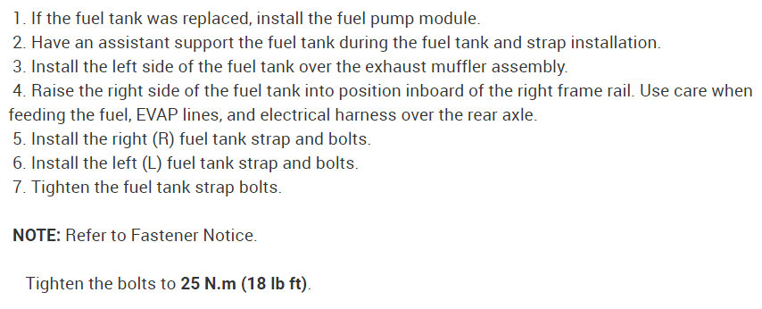

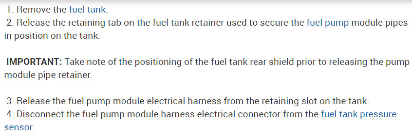

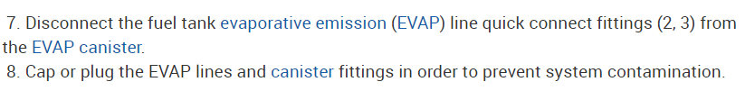

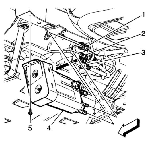

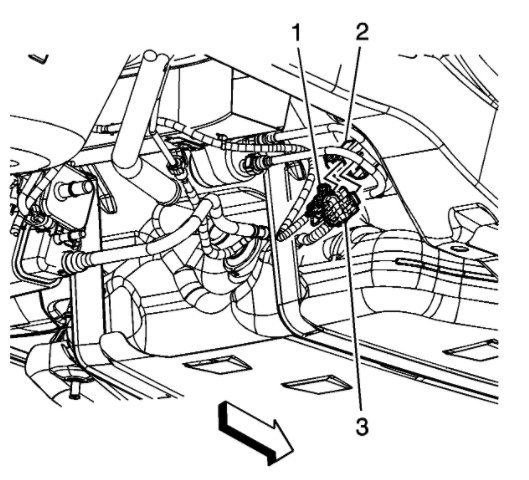

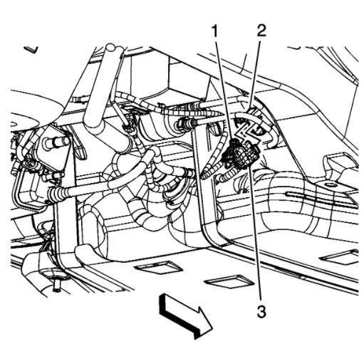

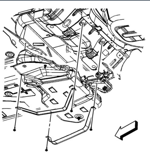

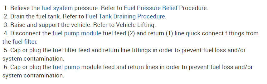

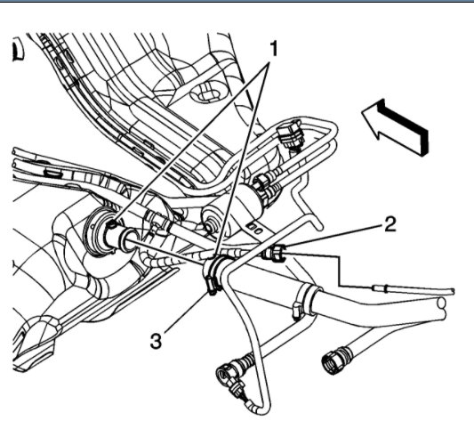

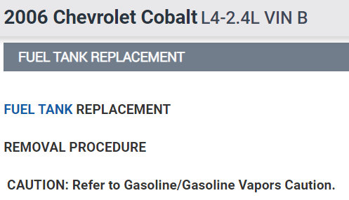

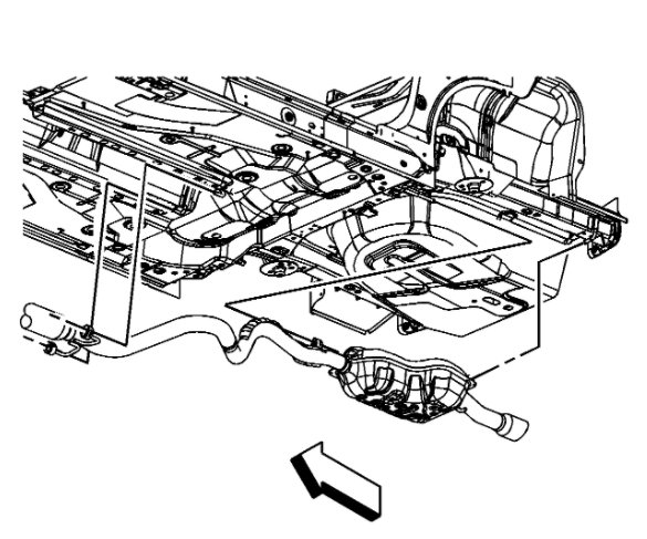

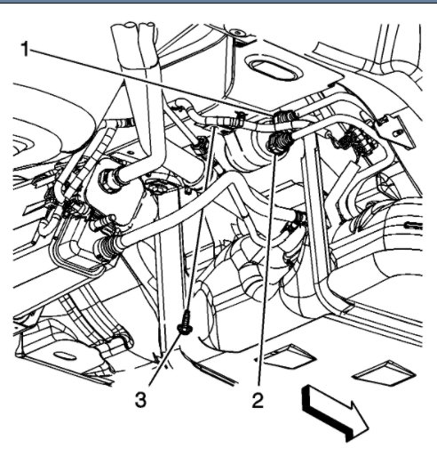

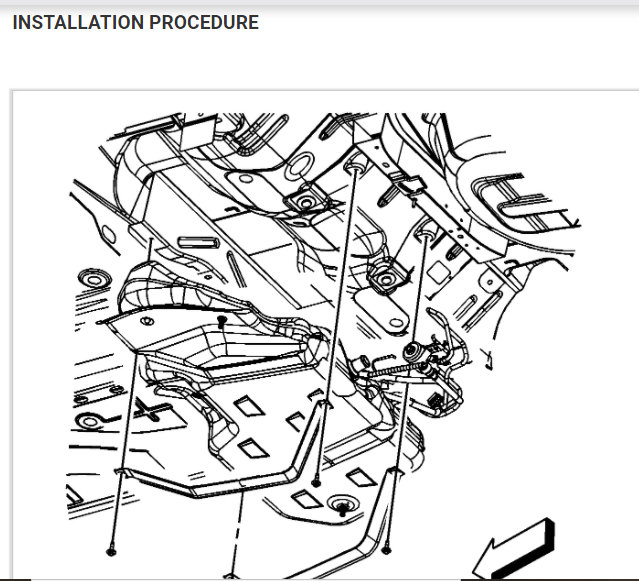

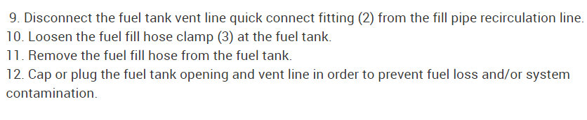

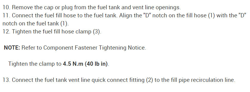

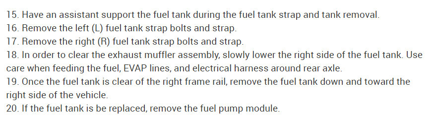

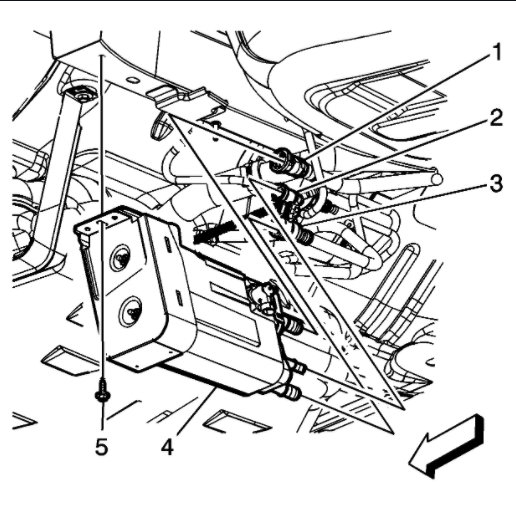

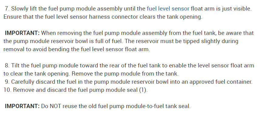

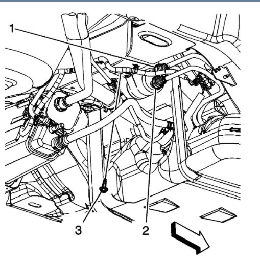

Here is the information you requested for in-tank fuel pump replacement. You will need to drop the fuel tank first to gain access to the fuel pump. I've attached picture steps below for removal and replacement of the fuel tank on you car. Due to the number of steps this will be the part 1 post. Hope this helps and thanks for using 2CarPros.

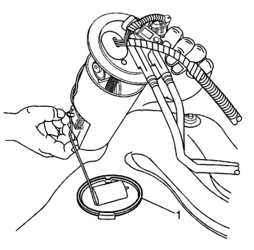

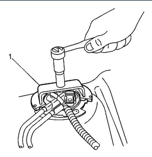

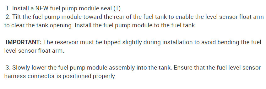

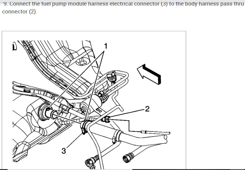

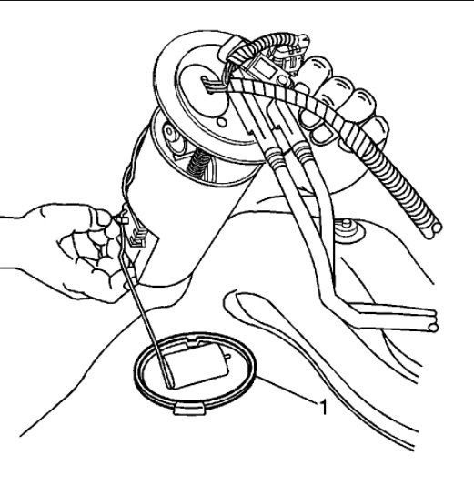

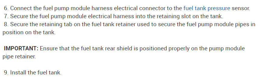

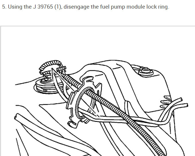

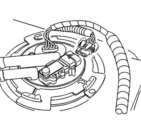

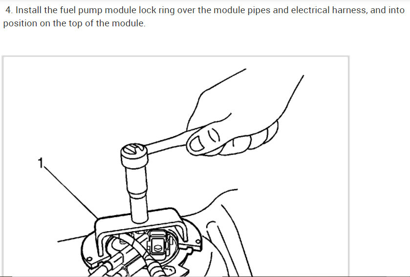

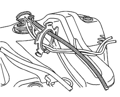

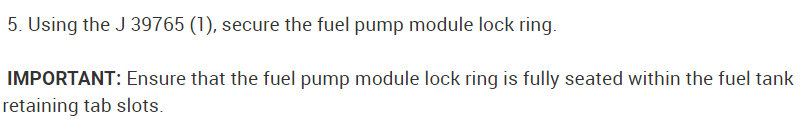

This is the part 2 continuation for fuel pump replacement. Here is a tutorial for you to view on in-tank pump replacement:
https://www.2carpros.com/articles/how-to-replace-an-electric-fuel-pump

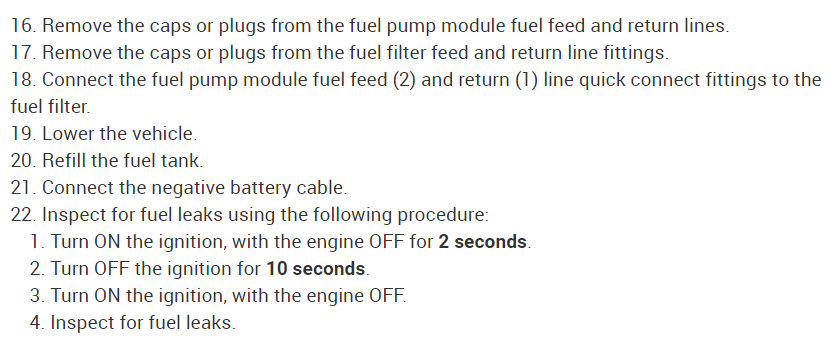

I've attached the picture steps below for the fuel pump replacement on your car. Hope this helps and thanks again for using 2CarPros.
