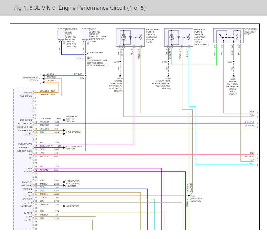

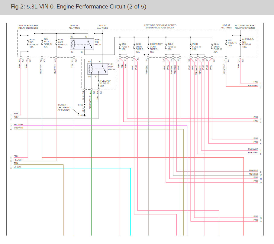

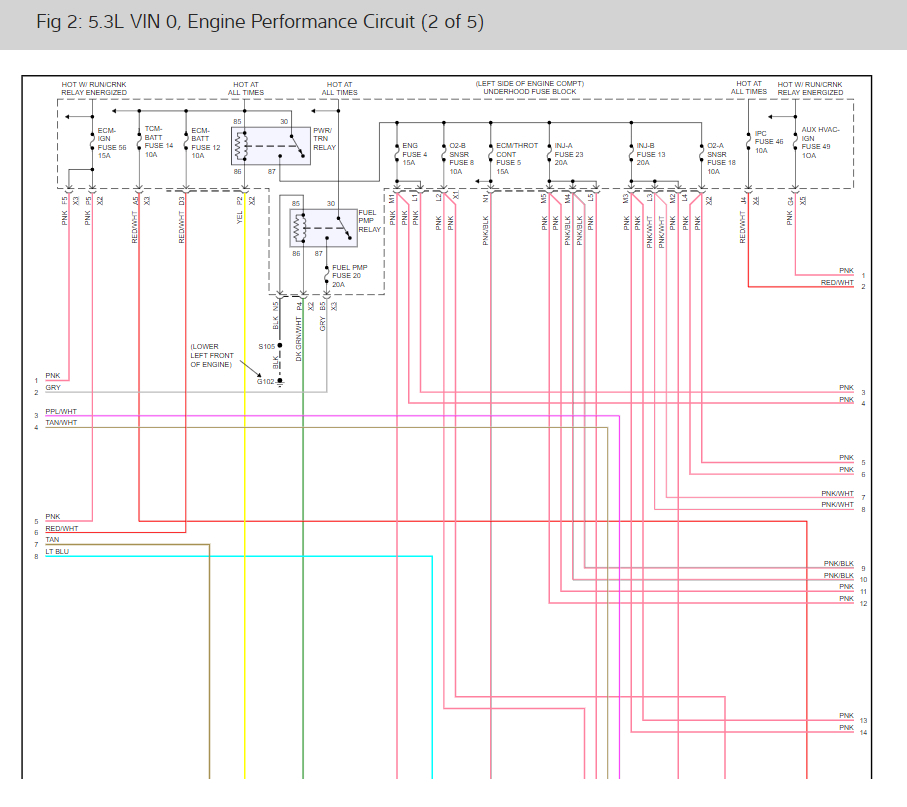

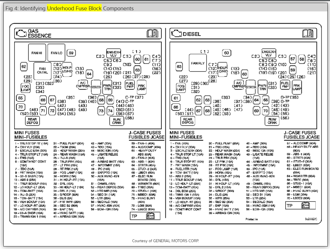

It sound sliek the fuel pump relay is bad. To be sure this guide can help us fix it with the fuel pump relay location in the diagrams below:

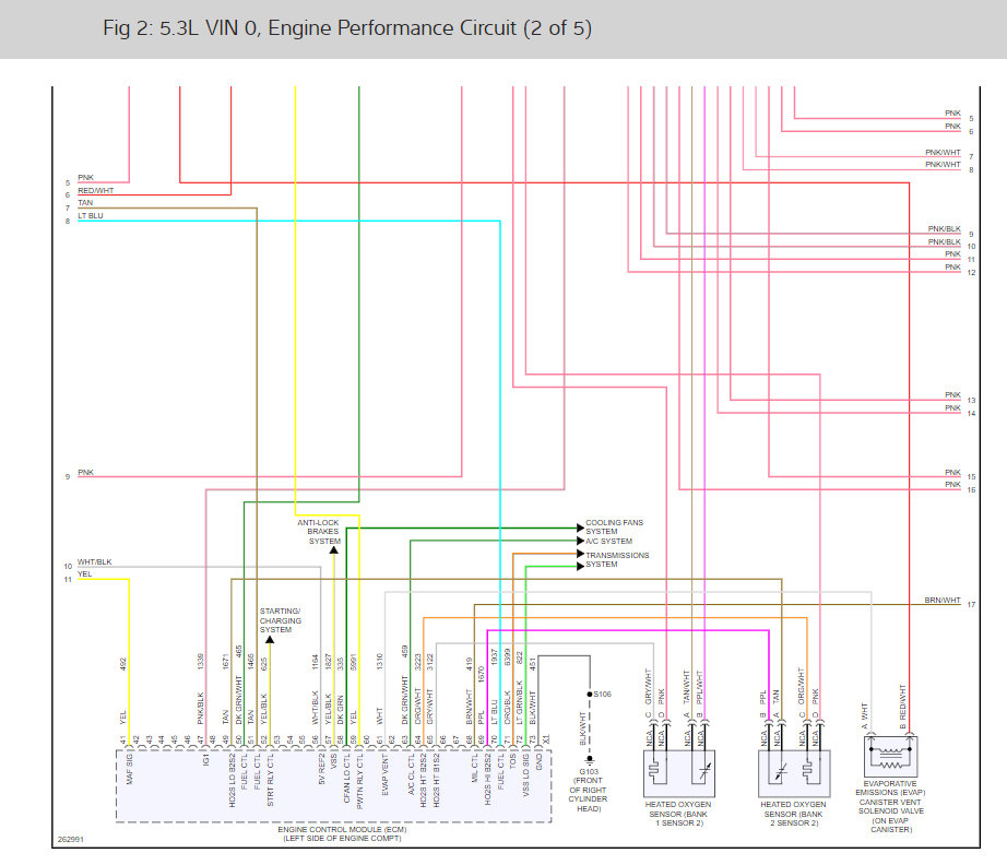

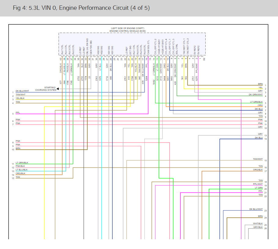

Here is the fuel pump wiring diagrams as well so you can see how the system works. Check out the diagrams (below). Let us know what happens and please upload pictures or videos of the problem.
