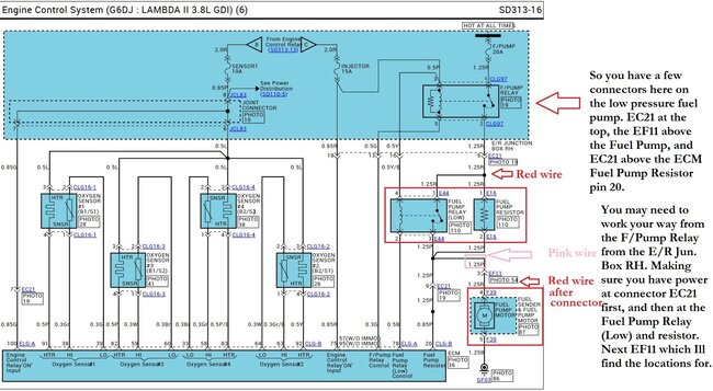

Hello, it looks like there are 2 fuel pump relays for this vehicle, but to begin with, do your brake lights come on when pressing the pedal? Just to verify, we can assume the brake pedal switch is working. I'm going to look through the OEM wiring to make sure these fuel pump relay wiring diagrams are correct.
This also looks like a GDI high pressure fuel system, so I'm assuming you are not getting power to low pressure pump in the tank? You're not checking pressure at the high-pressure pump test port where it shows the low-pressure side?
With a scan tool you could read the Fuel Rail Pressure live data, but do not touch any of the steel fuel lines for the high pressure fuel pump under the hood, its usually near the valve cover, but the high pressure can be anywhere from 500-2,000 PSI and cause serious injury or worse.

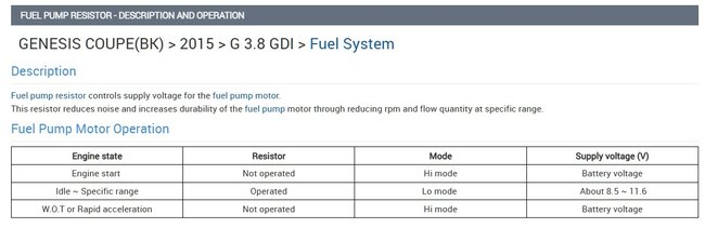

On a side note, I have had these cars not start due to a blown fuse which was actually caused by the rear taillights shorting out, blowing the fuse. Which happened to be the same fuse for the brake pedal, there was a Recall on the tail lamp sockets due to over heating, melting and shorting out. This happened just a few months ago, so I would just go through the fuses with a test light and make sure you don't have any blown fuses. I don't know if the recall applies to this vehicle, but it was exhibiting the same symptoms. I will post the wiring diagrams for you, there is also a resistor for the low pressure fuel pump, which power flows through at idle, where the voltage at the pump will be lower, anywhere from 8.5volts to 12v.

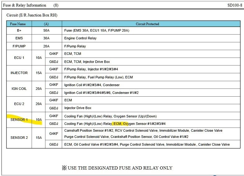

Thanks for the reply. Got out there this morning and was able to figure it out. The hard brake pedal and the clicking under the dash was caused by what appeared to be the main fuse panel connection under the hood on the passenger side. The clips that hold that entire complex of wires has somehow worked loose and I guess it was causing a poor connection. Took it apart, reconnected it, and used a zip tie to make sure it didn't somehow work loose again. Got that connection and the car started turning over again...but still wouldn't start. Started again rechecking the ECM relay and fuel pump relay, and both still checked out okay. Still power getting to the terminals too. Checked all of the mini fuses with a multimeter and came across one random 10-amp fuse that was blown and it was simply labelled "sensor" Replaced that and it started right up. I thought I had checked all of the fuses yesterday, but I somehow missed that one...it was off by itself with one more mini fuse. That being said why in the world would one little 10-amp mini fuse labelled "sensor" cut power off to the fuel pump?? From what I read there is no separate "fuel pump fuse," only the fuel pump relay. To me common sense would to have one designated power and ground from the relay to the fuel pump and not have that wiring integrated with other circuits that could cause a fuse to blow and cut the fuel pump off. Anyway, thanks again for the information and the help. My son has pimped this car out and it rides like a wooden rollercoaster, so I'm sure the beating all of the internals take will eventually cause some other craziness. I appreciate you guys/gals that are willing to help. Take care!

Okay, so you don't need any of these wiring diagrams, here's the Sensor 1 10amp fuse, its not listed in the Power Dist wiring diagrams but it's obviously for the ECM power. Probably why one of the relays wasn't grounding. but glad you got it figured out. Check the rear bulb sockets for overheating, just to be sure they aren't melting, probably not related to this issue, but good to check anyway.
