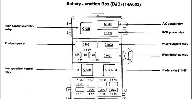

When I turn the key to on the fuel pump does not run. What is the cause and what to check?

How old is your (Ecm or Ecu)? And have you checked the fuses as well, and checked the wires to the fuel pump to see if they are getting power? If you do not hear the priming of the the fuel pump, its not getting fuel at all.

I do not know how old is the Ecm or Ecu i have not check the fuses and the wires where are the fuses located? i do not hear the priming of the fuel pump when turn the key on.

Also, check if it has a fuel pump relay or main relay.

try resetting security system if no manual look online for your car on how to do it. Also, check the battery cables as they may be dirty causing the security system to engage. when it does it shuts fuel off.

where is the fuel pump relay located?

see pic
