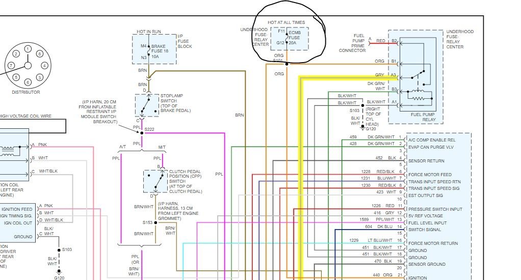

Grey wire on fuel pump is not getting power, sending unit has power but fuel pump will not kick on.
Oct 4, 2019 at 2:55 AM
Good afternoon,

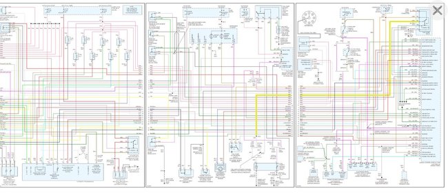

I attached a wiring diagram for you of the fuel pump.
You will need a test light or voltmeter to do some checks as to why the relay is not working.
Jun 2, 2021 at 7:49 AM
TIMMY LEGENS
It shut off while driving so I assumed it was the fuel pump, replaced fuel pump and no luck that is when I started chasing wires. My next guess is the oil pressure switch or sensor.
No, the next step is to diagnose the issue, not replace parts.
You need to do testing. Do you have a voltmeter or test light to do some testing?
