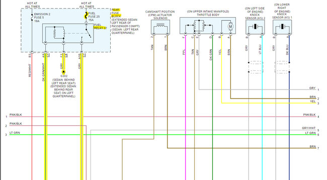

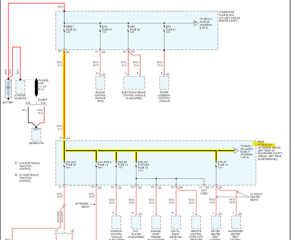

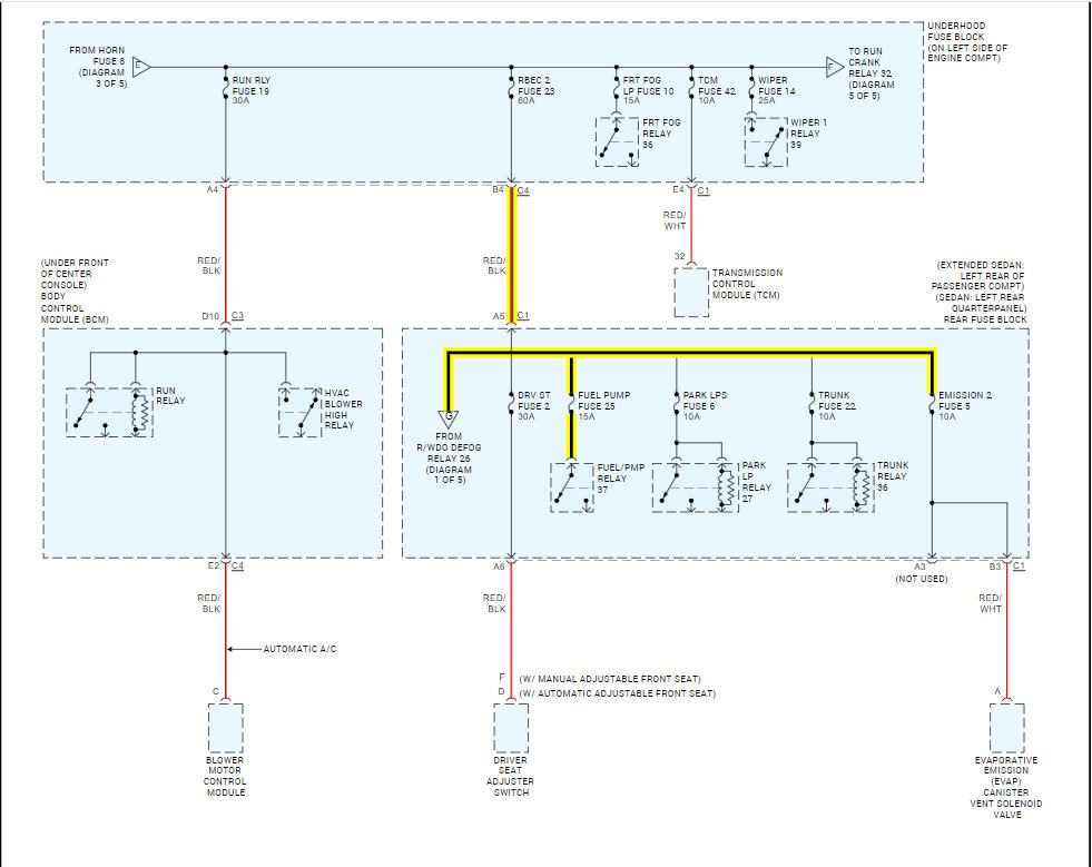

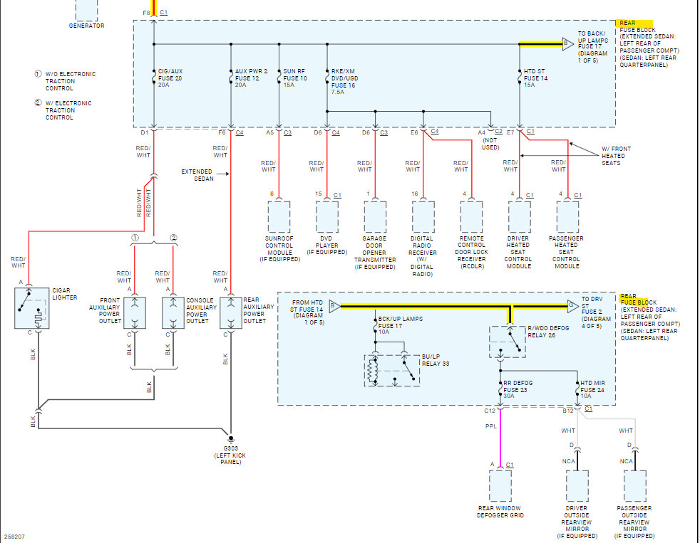

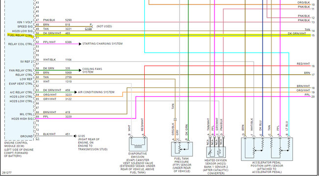

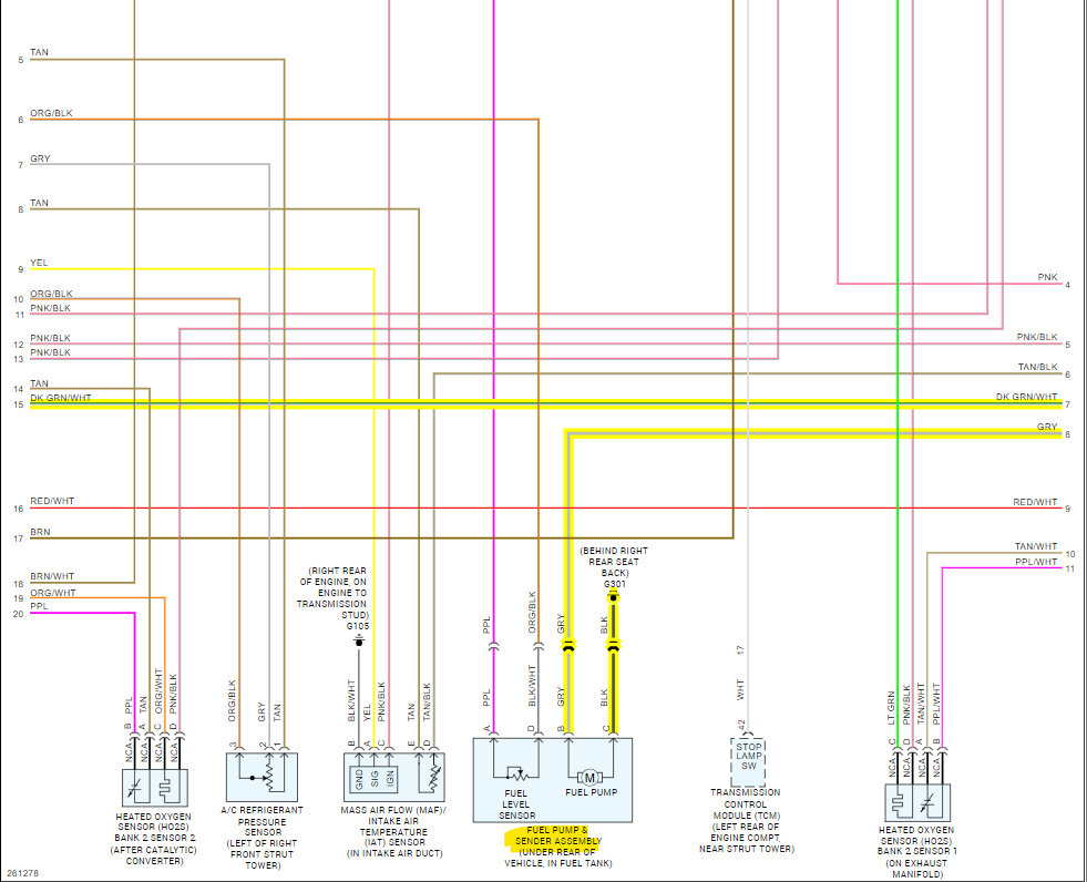

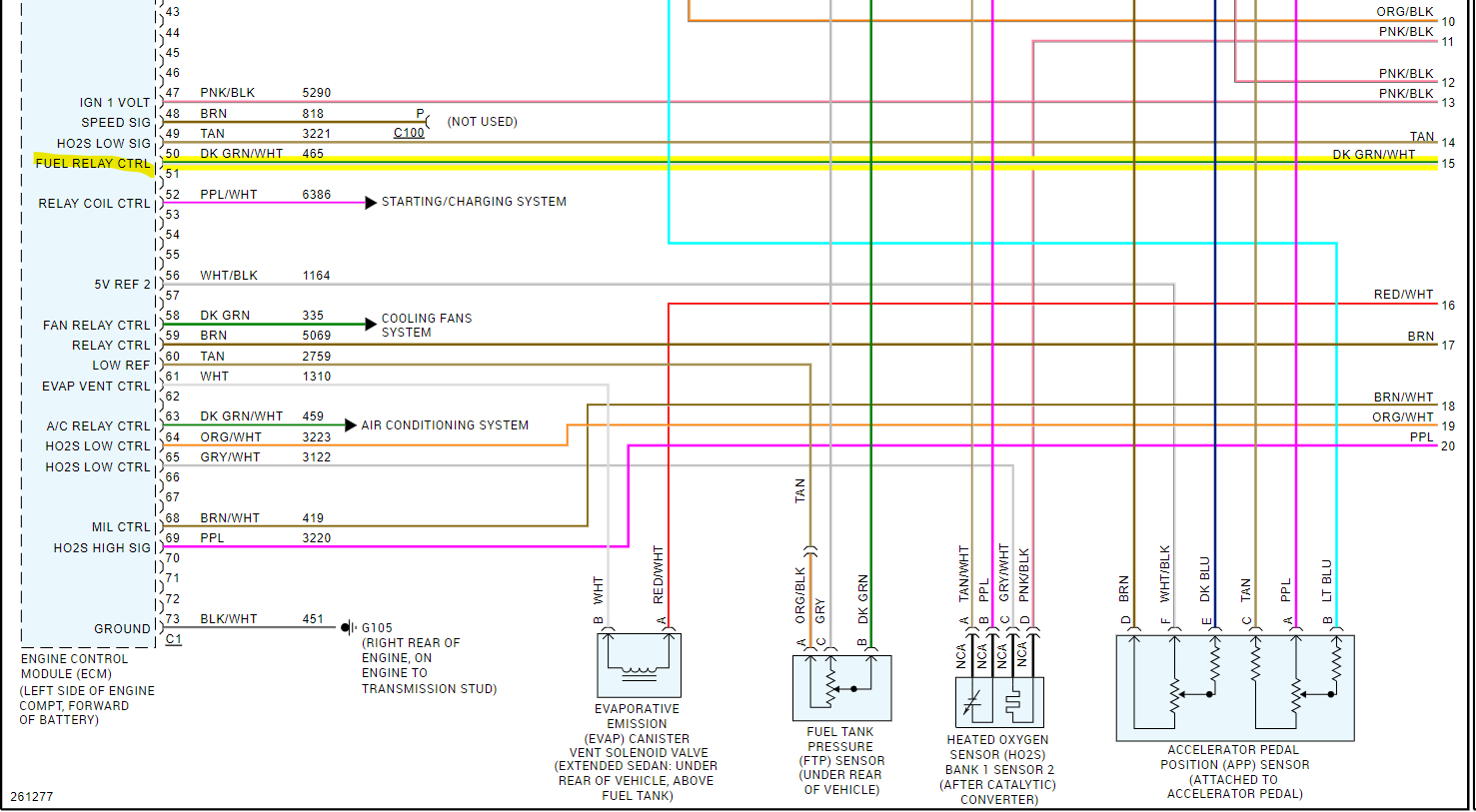

Can I get the Fuel pump color coded wiring diagram?
100,000 MILES
PAUL OLDHAM

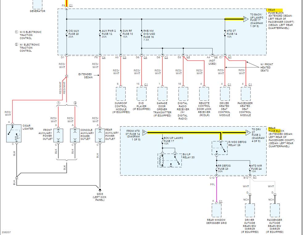

Trunk fuse block color coded wiring diagram.
Jan 13, 2024 at 1:57 AM
AL514
  • 5,700 POSTS
Hello, are you missing power at the fuel pump relay? I have the fuel pump, relay and ECM wiring diagrams already pulled up for you. Do you need the actual Rear Fuse Block diagram? And is this a 3.5, 3.6 liter or 4-cylinder engine?
Diagrams 4,5,6 are the Power Distribution diagrams for the Rear Fuse Block from the engine compartment. If you need anything more, let us know.
