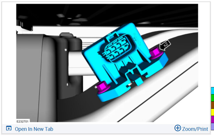

I have the truck listed above King Ranch and I cannot find where the fuel pump module relay goes.

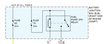

So this truck has a fuel pump relay which is located in the fuse panel in the right side fuse panel under the hood, and a fuel pump control module which is located at the right center of the frame rail, I have added the locations to both in the images below. Let us know if you need anything else. It should show the relay location from the lid of the fuse panel; sorry they don't show the exact location. Check out the images (below). Let us know if you need anything else.
