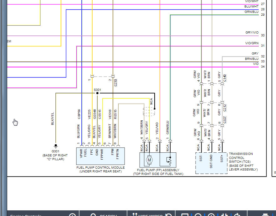

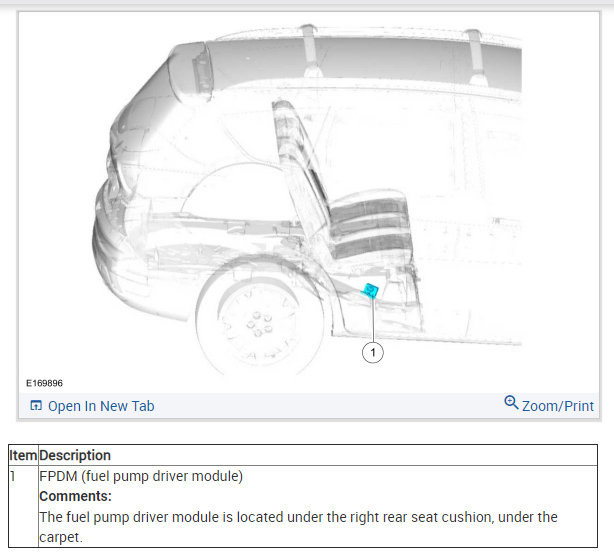

Where do i find fuel pump driver module? no idea where to start looking on car.
May 29, 2021 at 9:54 AM
It is under the rear seat. I attached all the info below on this including the wiring diagram.
Please take a look at this info and let us know if you more and we will be happy to provide it.

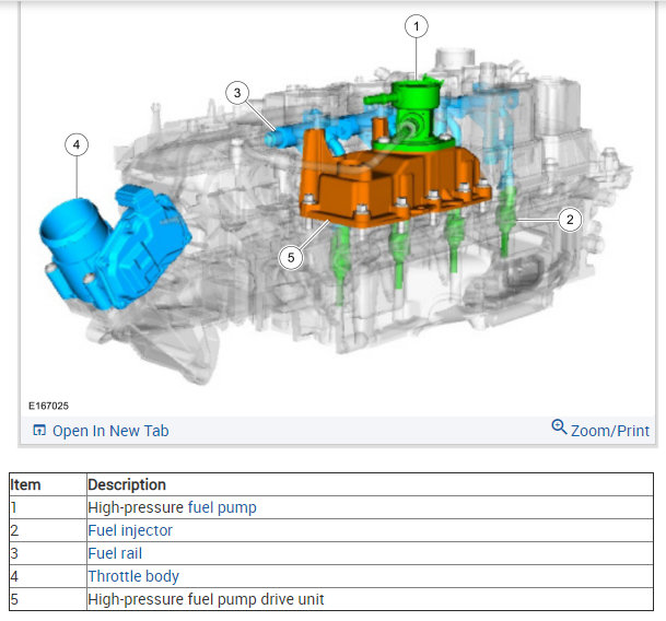

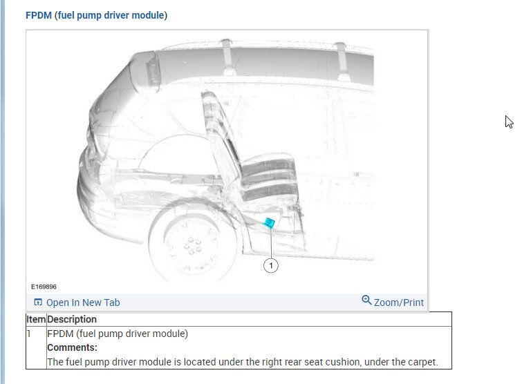

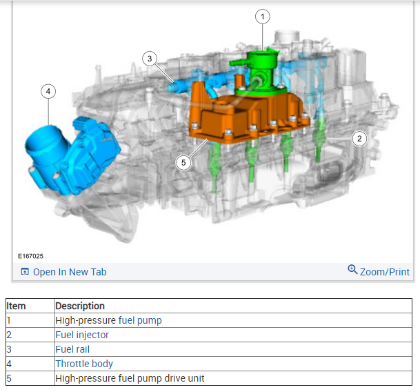

The fuel pump driver module is located under the right rear seat cushion underneath the carpet. I've attached a picture below. I've also attached a picture of the rest of the fuel system as well. Hope this helps and thanks for using 2CarPros.

No. If you take a look at the wiring diagram I added above you will see that there is a fuel pump control module and that will control the fuel pump if it needs to be shut off.
They stopped using the shut off switch some time back when the body control module and powertrain modules got more sophisticated.
