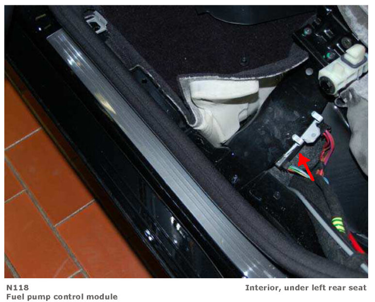

Where is the Fuel Pump Modulator located?
2009 MERCEDES BENZ S550
190,000 MILES • 5.5L • V8 • 2WD • AUTOMATIC
CHRIS GANZ
MEMBER
2 POSTS
Where is it?
Jun 7, 2024 at 11:01 PM
Experienced Mechanic
55,604 POSTS
The fuel pump control module in under the left rear seat. Check out the images (below). Let us know if you need anything else.
