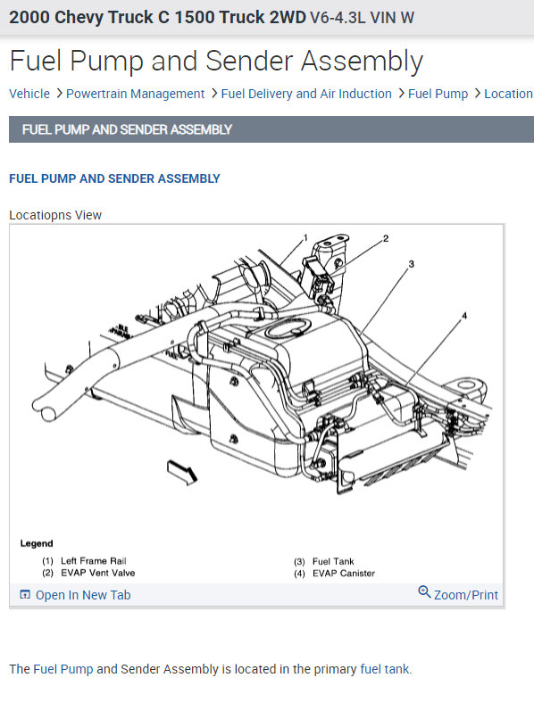

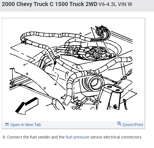

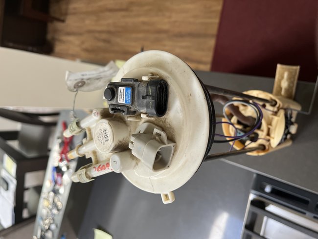

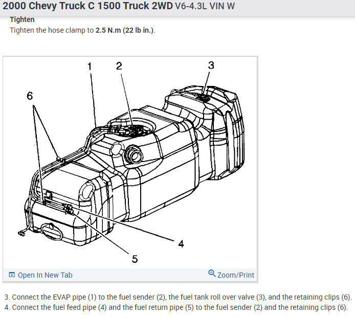

My old fuel pump has an electrical port (?) for a square connector. Every new fuel pump I can find doesn't have a square connector; it has an oblong connector.
Do you know how or where I can find the SQUARE style connector fuel pump for the truck listed above 1500 model?
It is the exact same fuel pump on your VIDEO
www.youtube.com/watch?v=VuGxQgWDP-0
Please and thank you!

Which engine is in your vehicle?
Is it the 4.3L, 4.8L or 5.3L?
Let me know and I will see what the OEM part number is as that can help determine which one you need.

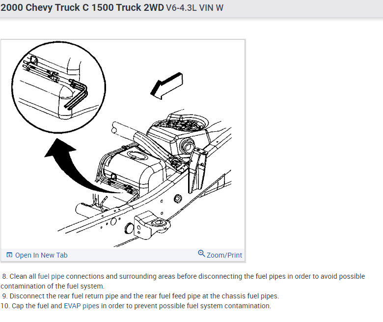

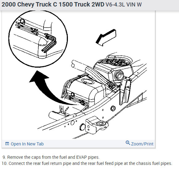

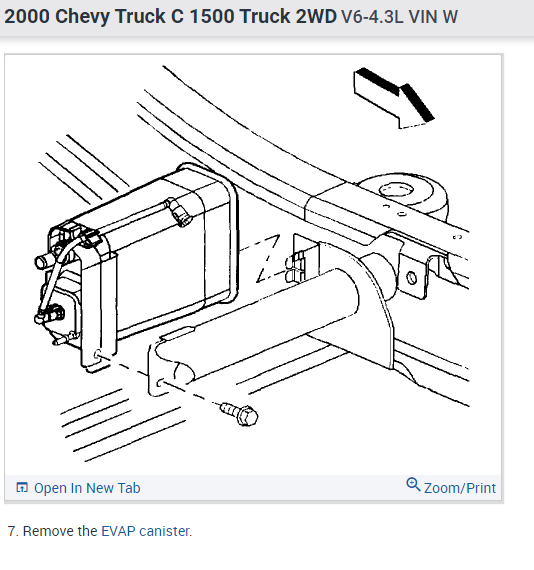

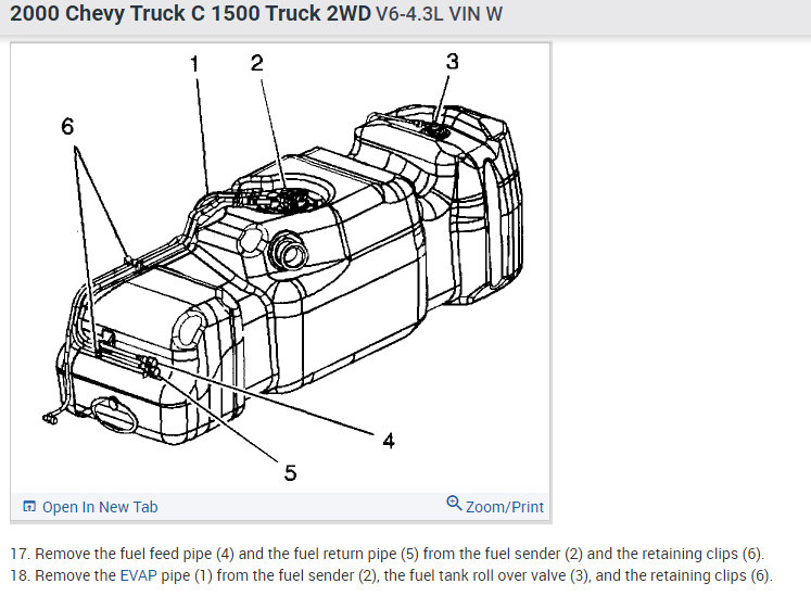

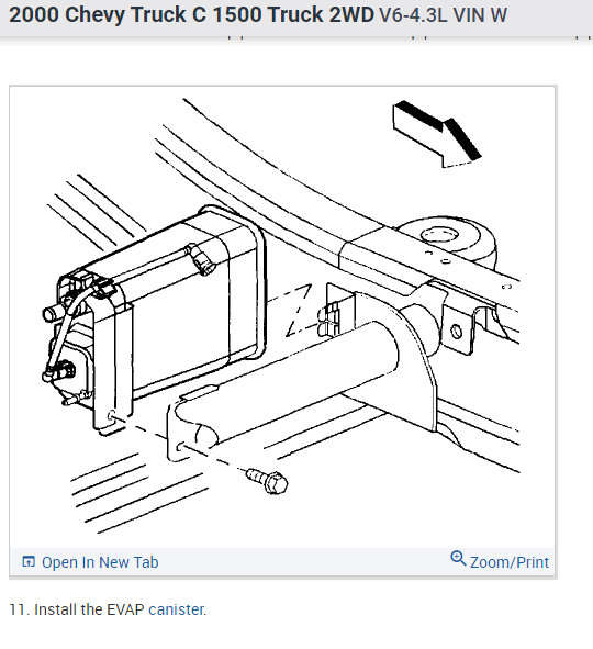

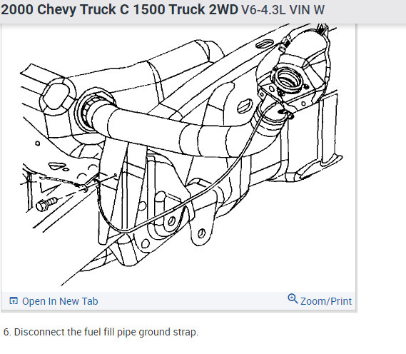

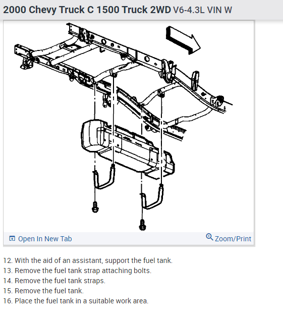

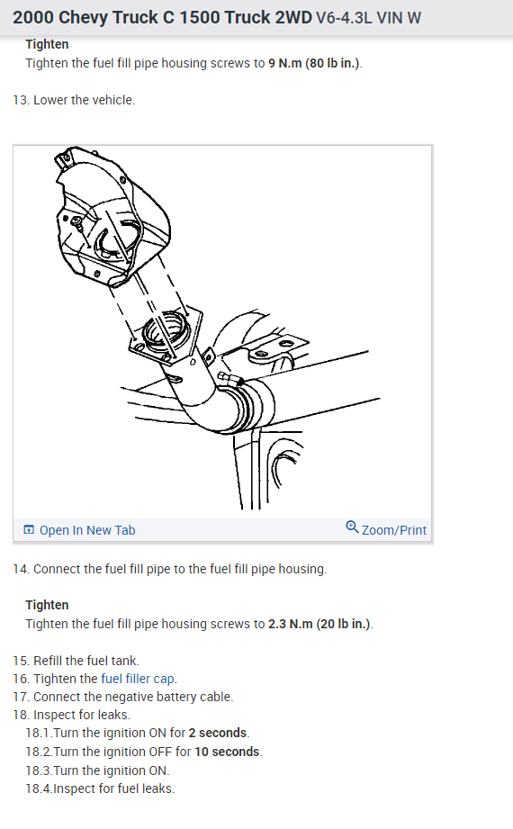

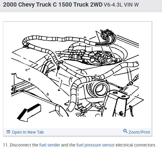

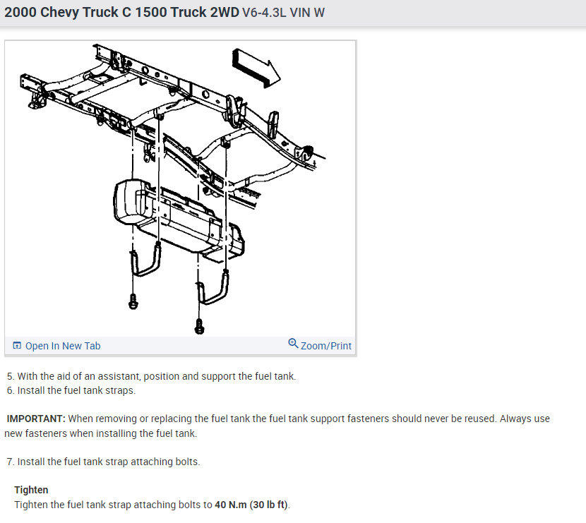

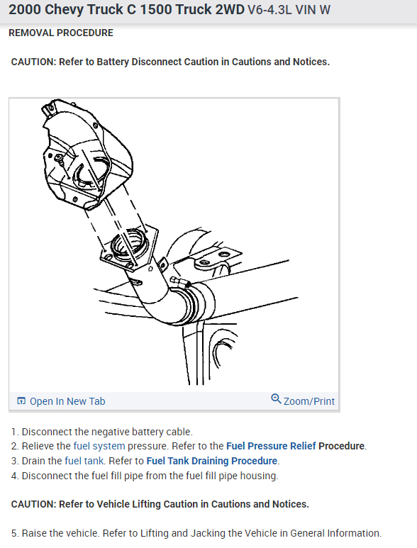

https://www.2carpros.com/articles/how-to-replace-an-electric-fuel-pump
I have attached the fuel pump replacement procedure below.
Let me know of any questions.

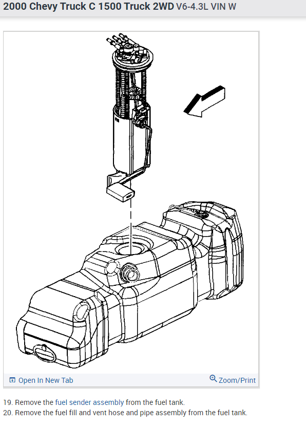

LARRY0777
Hi Sean, thank you again for your help!
I have attached a pic of the fuel pump I am trying to replace. Every 'replacement' pump on the internet has a different electric port. I need the square 4 pin, while the new ones all show an oblong 4 pin!
Can you help me find the original? Or do I just rewire the square 4 port to a new oblong 3 port?
Thanks again Sean!
Larry
