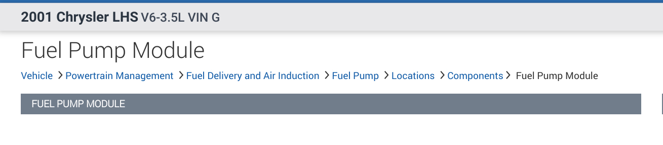

Fuel pump location

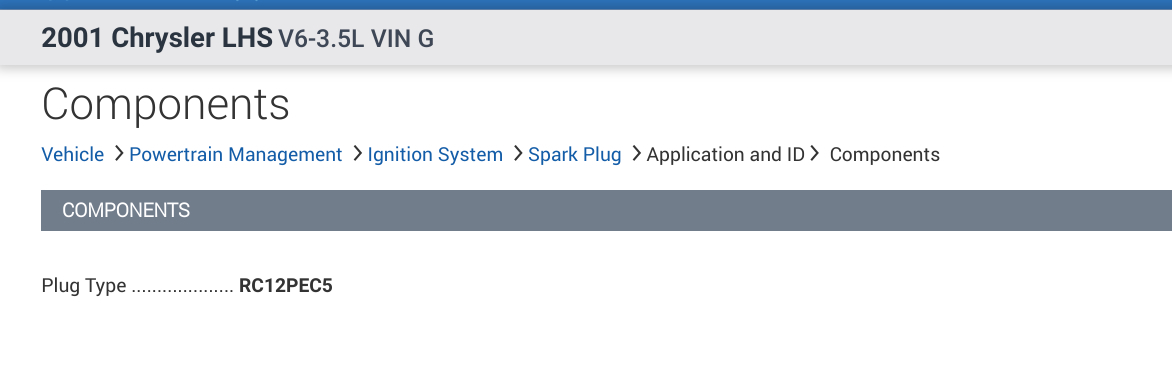

Running rough.
Mar 6, 2020 at 5:48 AM
SCGRANTURISMO
  • 4,897 POSTS

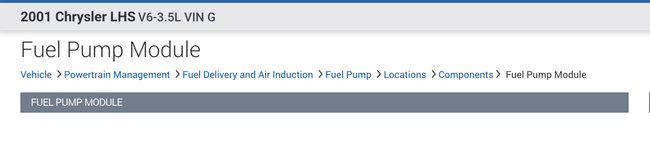

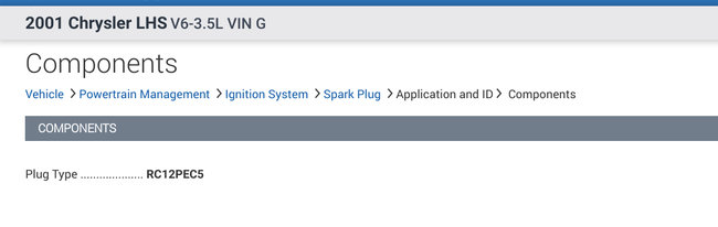

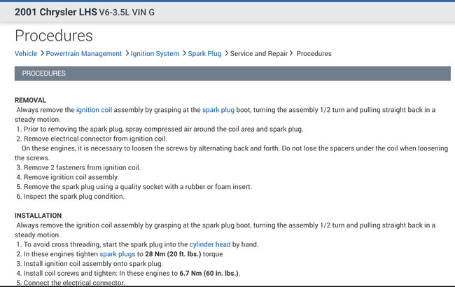

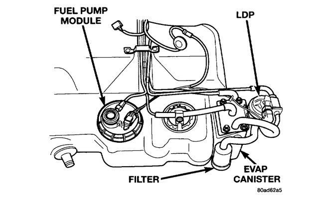

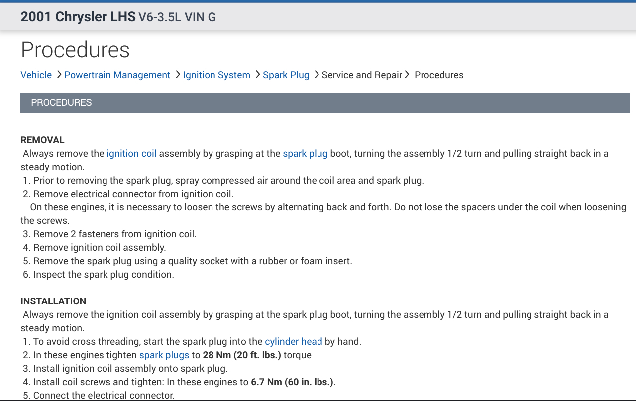

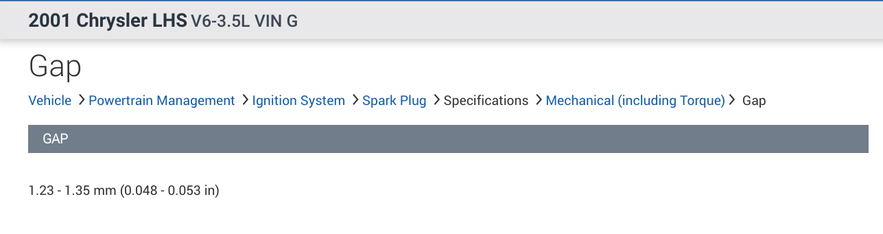

In the diagrams down below I have included a diagram with the fuel pump location. It is part of the fuel pump module. If your vehicle is running rough though, I would recommend starting out by changing the spark plugs in your vehicle. In the diagrams down below I have included the instructions for the removal and installation of the spark plugs for your vehicle. I have also included the Original Equipment Manufacturer[OEM] part number for the spark plugs as well the gap specs. Please go through these guides and get back to us with how everything turns out. We can go from there if needed.

This guide can help walk you through the repair on this similar car:
https://www.2carpros.com/articles/how-to-replace-an-electric-fuel-pump
