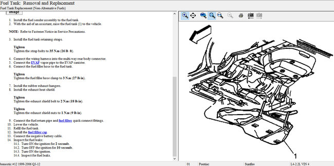

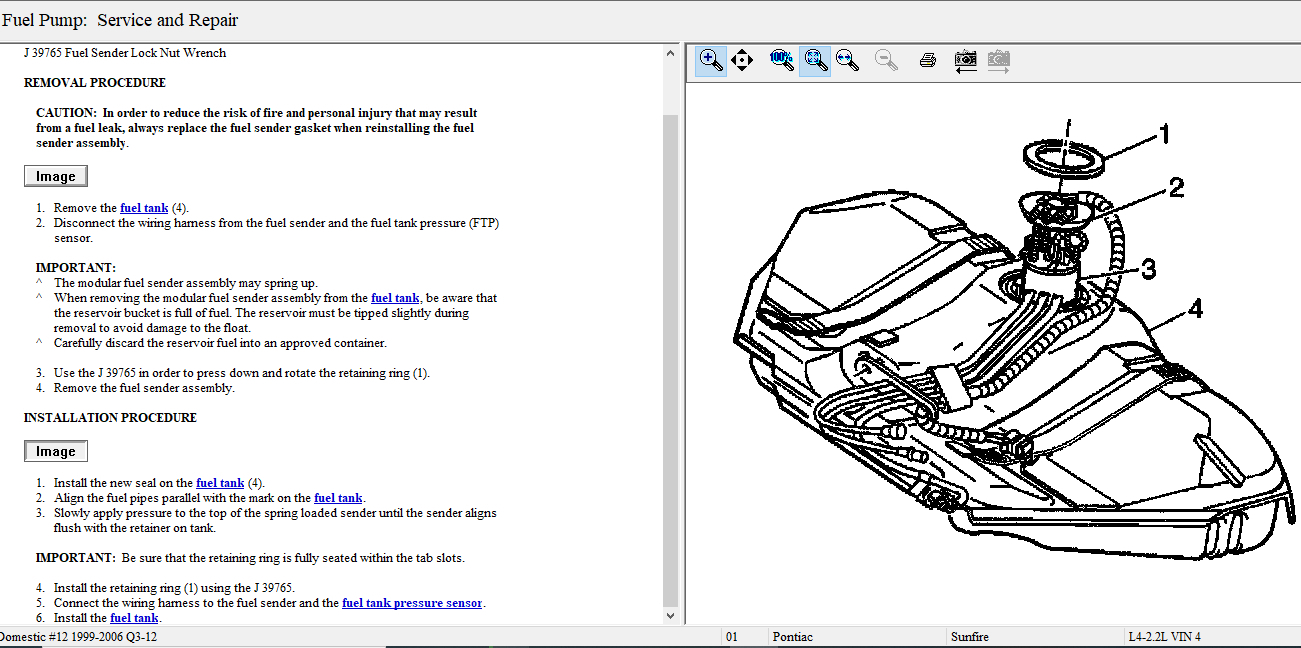

I am trying to find the location of the fuel pump in the gas tank. I am not up to dropping the gas tank so I plan on cutting through the floor or trunk to gain access. Thanks for any help y'all can offer.

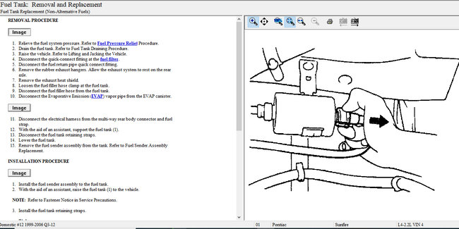

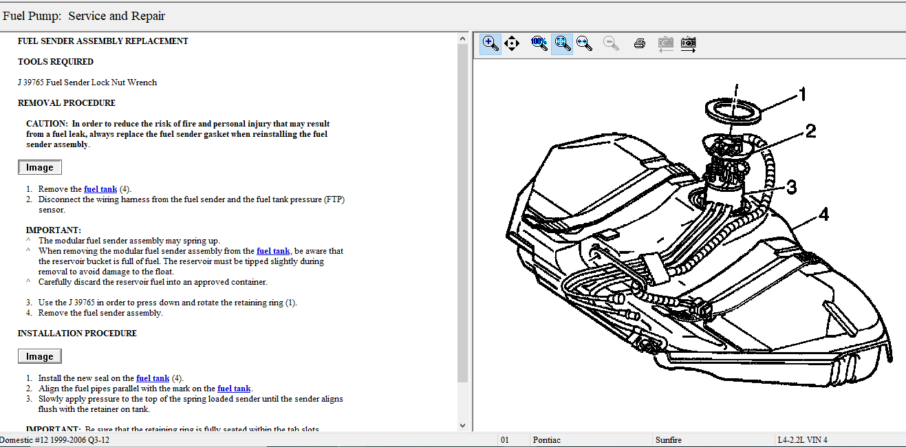

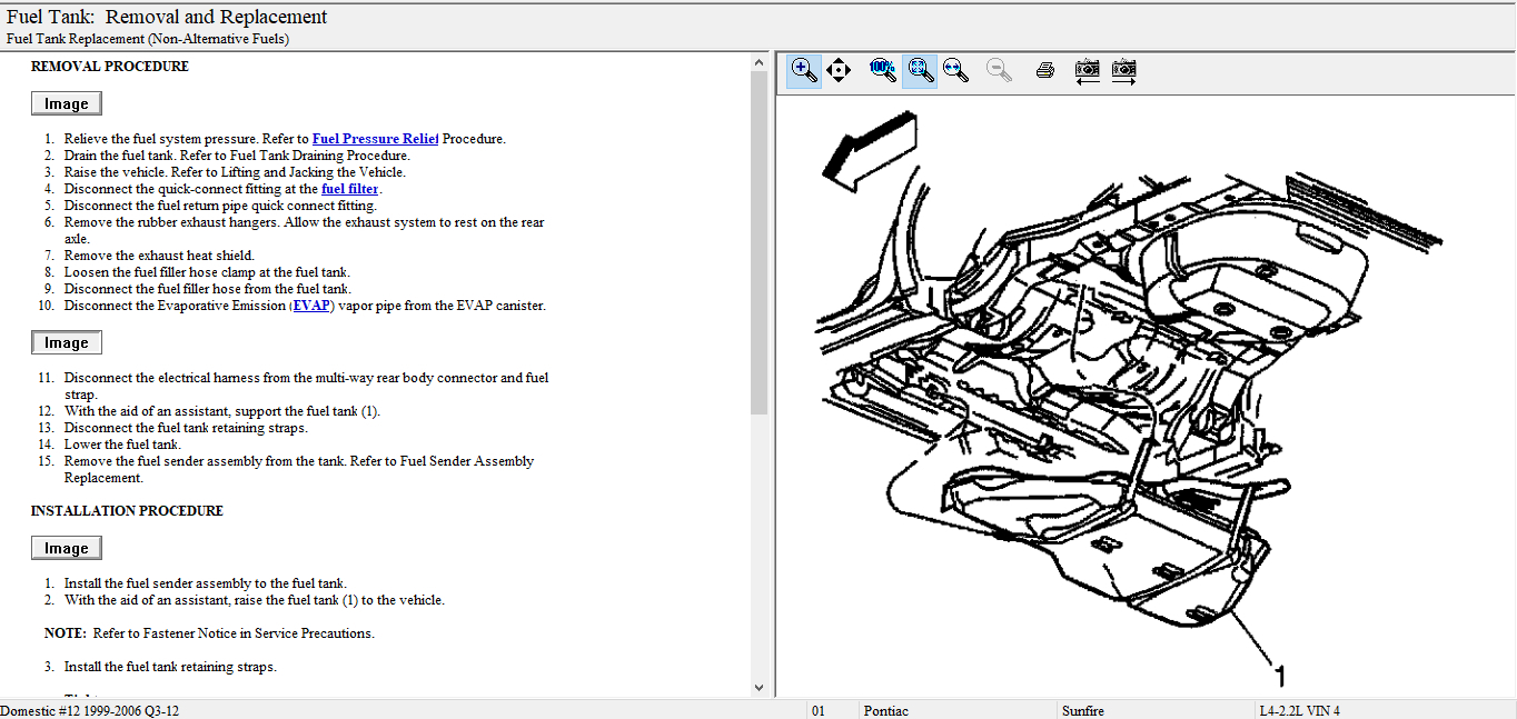

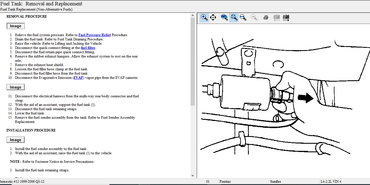

Fuel pump is located at the center of the fuel tank, but it's better to remove the tank.
check the diagrams below location and the procedure how to remove tank and replace the pump.
