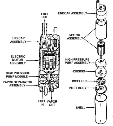

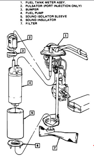

Is there a access point or do I need to drop gas tank??
Oct 17, 2020 at 2:41 AM
DANNY L
  • 5,648 POSTS
Hello, I'm Danny.
Sorry, there is no access point you will have to drop the gas tank to gain access to the in-tank fuel pump. Here is a tutorial showing what is involved for replacement:
https://www.2carpros.com/articles/how-to-replace-an-electric-fuel-pump
I've attached a few pictures below of its description. Hope this helps and thanks for using 2CarPros.
