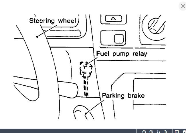

Where is the fuel pump relay located?
170,000 MILES • 2.4L • 4 CYL • 2WD • MANUAL
NEVENL2000
location of fuel pump relay for the vehicle listed above XE.
Jul 13, 2021 at 12:46 AM
COLBY_STEPHENSON2000
  • 32 POSTS
Hello I'm Colby.

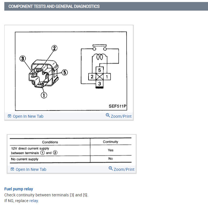

Here is the location for the fuel pump relay. Looks like it is behind the knee panel on the driver side by ignition switch. I have also included a guide of the location and testing procedure.
