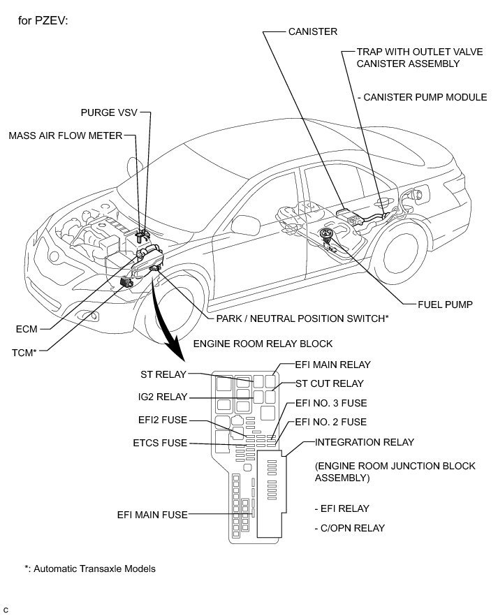

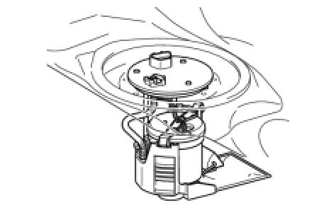

Recently had a new engine installed. Car originally started after the new engine was installed. The next day, the car began to stall when I put it in drive or reverse. I was told I needed a new fuel pump. I installed a new one but I do not hear the humming sound that fuel pumps make when you turn the key. What is causing it to not start?

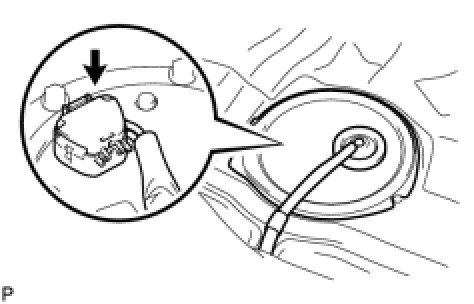

REMOVE REAR FLOOR SERVICE HOLE COVER
(a) Remove the rear floor service hole cover.
(b) Disconnect the fuel pump connector.

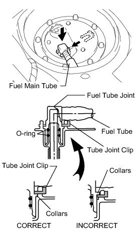

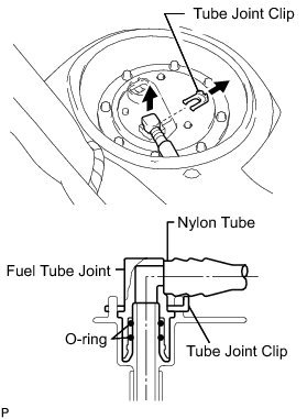

SEPARATE FUEL PUMP TUBE SUB-ASSEMBLY
(a) Remove the tube joint clip, and pull out the fuel pump tube.
NOTICE:
* Check that there is no dirt around the fuel tube joint before this work and clean any dirt away.
* It is necessary to prevent mud or dirt from entering the fuel tube joint. If mud enters the joint, the O-rings may not seal the fuel tube connector and fuel suction plate properly.
* Do not use any tools in this work.
* Do not bend or twist the nylon tube.
* After disconnecting, cover the fuel tube joint with a plastic bag.
* If the fuel tube joint and fuel suction plate are stuck, pinch the fuel tank tube between fingers, and turn it carefully to release. Disconnect the fuel tank tube.

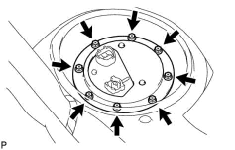

REMOVE FUEL TANK VENT TUBE SET PLATE
(a) Remove the 8 bolts and set plate.
REMOVE FUEL SUCTION TUBE ASSEMBLY WITH PUMP AND GAUGE
(a) Pull out the fuel suction tube from the fuel tank.
NOTICE:
* Do not damage the fuel pump filter.
* Be careful that the arm of the sender gauge does not bend.
(b) Remove the gasket from the fuel suction tube.

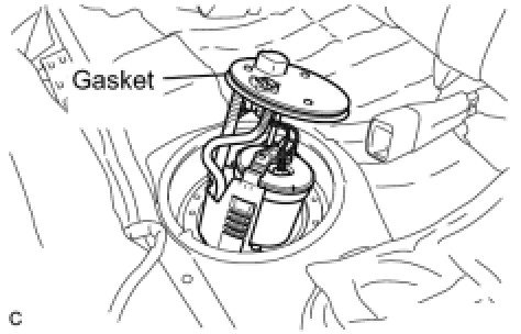

Installation: NOTE: Pictures 6 and 7 are for replacement.
FUEL PUMP: INSTALLATION
INSTALL FUEL SUCTION TUBE ASSEMBLY WITH PUMP AND GAUGE
(a) Install a new gasket to the fuel suction tube.
(b) Install the fuel suction tube.
NOTICE:

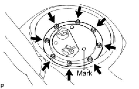

INSTALL FUEL TANK VENT TUBE SET PLATE
(a) Align the mark of the set plate with the fuel suction tube.
(b) Install the set plate with the 8 bolts.
Torque : 6.0 Nm (61 kgf-cm, 53 in-lbf)
CONNECT FUEL PUMP TUBE SUB-ASSEMBLY
(a) Install the fuel pump tube with the tube joint clip.
NOTICE:
* Check that there are no scratches or foreign objects on the connecting part.
* Check that the fuel tube joint is inserted securely.
* Check that the tube joint clip is on the collar of the fuel tube joint.
* After installing the tube joint clip, check that the fuel tube joint is pulled off.

If you followed the directions and all things are properly connected, I would check the fuel pump relay. It is located under the hood of the vehicle. I have attached a picture of its location (Picture 8). What to do is switch it with a known good relay in the relay box that has the same part number.
