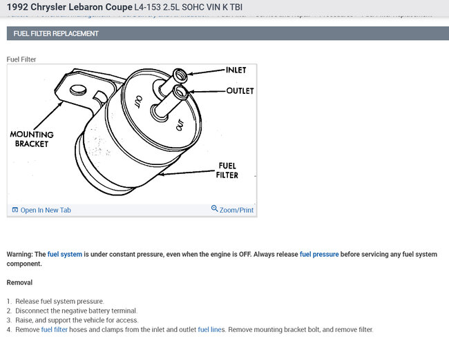

I fuel pressure tested my car and I turned the key but didn’t start it and I git 10 PSI… then I started my vehicle and got 45 PSI… I’m pretty sure that it’s supposed to stay 45 PSI before you start and after you start the vehicle… my car also stalls a lot while driving it shut off on me earlier and wouldn’t start with a jumper cable and only started after I put starter fluid in there.
The fuel pump still makes a sound when I turn my key before cranking it… so, is it a bad fuel pump or just a bad fuel filter?
Jul 3, 2023 at 8:57 AM
  • 55,423 POSTS

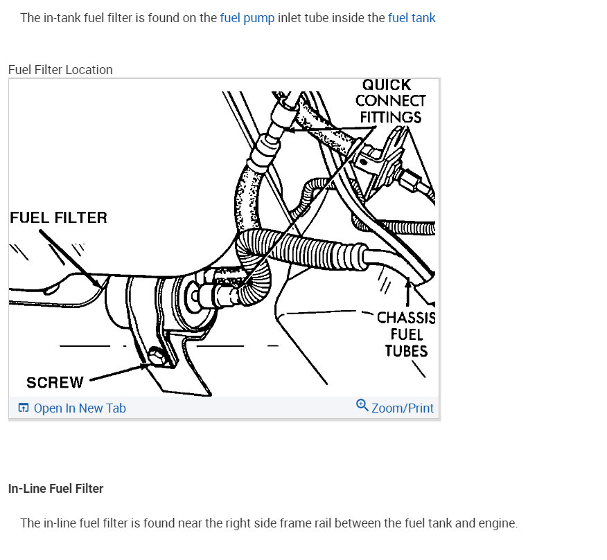

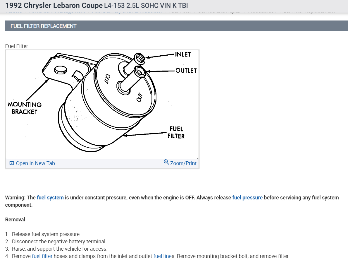

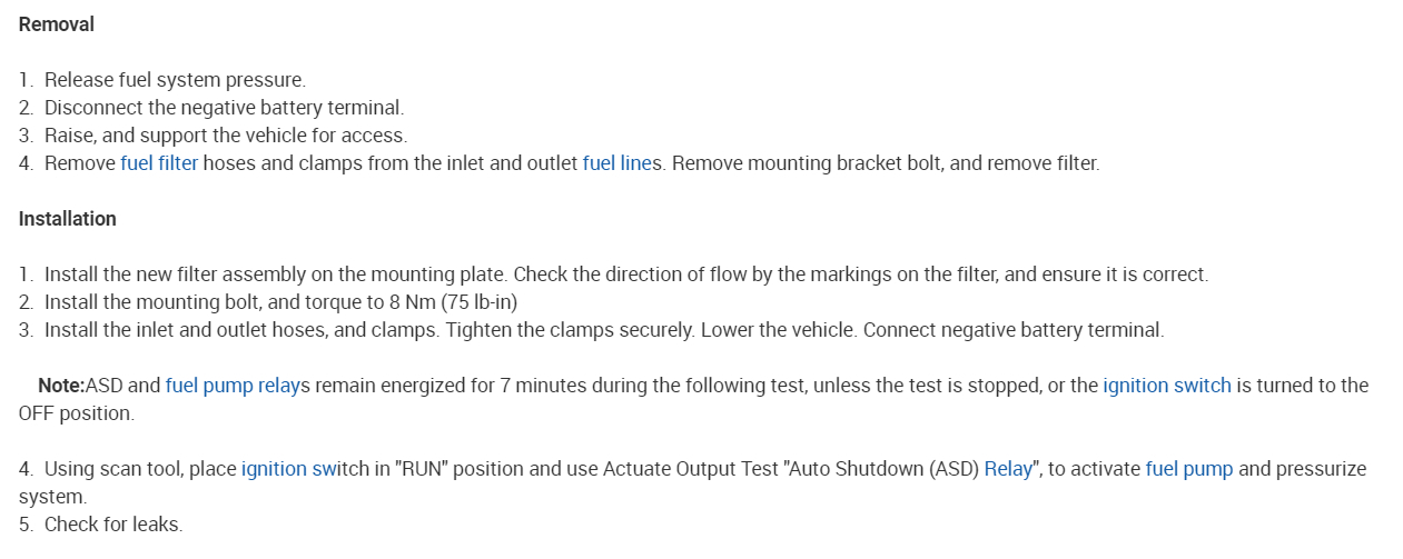

I would do the filter first. here is a guide to help walk you through the steps with instructions below to help you with your car:
https://www.2carpros.com/articles/how-to-change-a-fuel-filter
Check out the images (below). Please let us know how it goes
