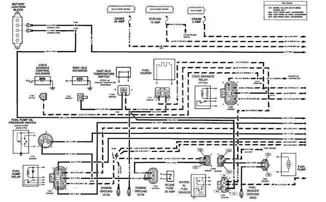

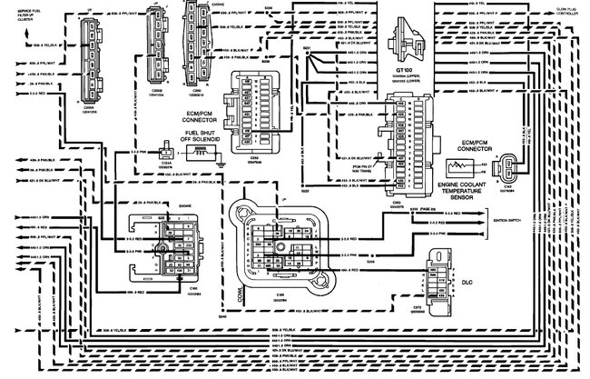

Fuel pump is not working, no power to relay fuse.
Nov 1, 2022 at 2:09 AM
Experienced Mechanic
55,464 POSTS
There is a 20-amp inline fuse that powers the fuel pump. here are the wiring diagrams and a guide to help check for power so you can see how the system works and where it might be losing power:
Check out the images (below). Please let us know what you find. We are interested to see what it is.
