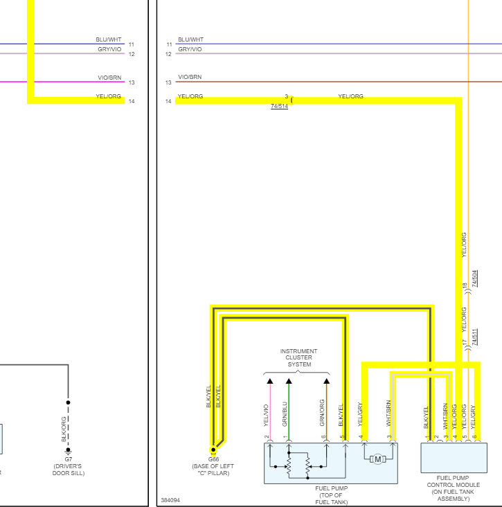

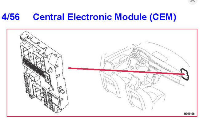

Fuel lump fuse and relay location needed.
Feb 26, 2022 at 1:41 AM
SQM
  • 6,383 POSTS

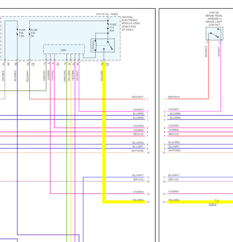

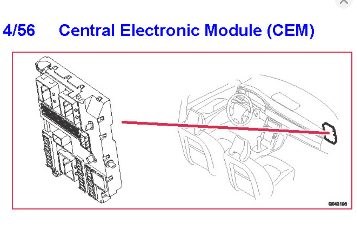

This vehicle has a fuse for the fuel pump located in the Central Electronic Module, which is at the right end of the dash. It is fuse number 13, a 20A fuse. I have attached a diagram showing the location of the CEM.

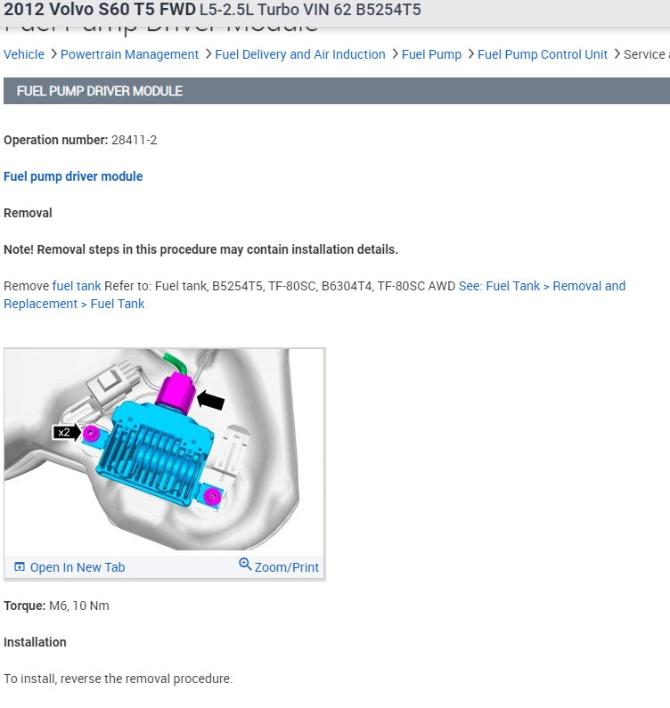

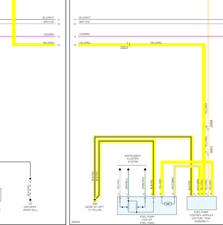

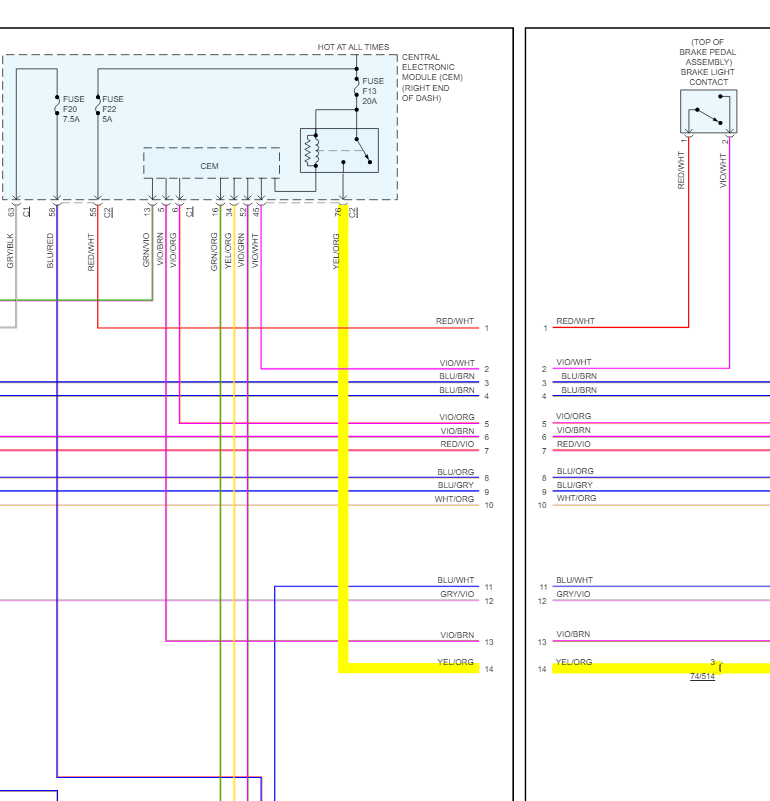

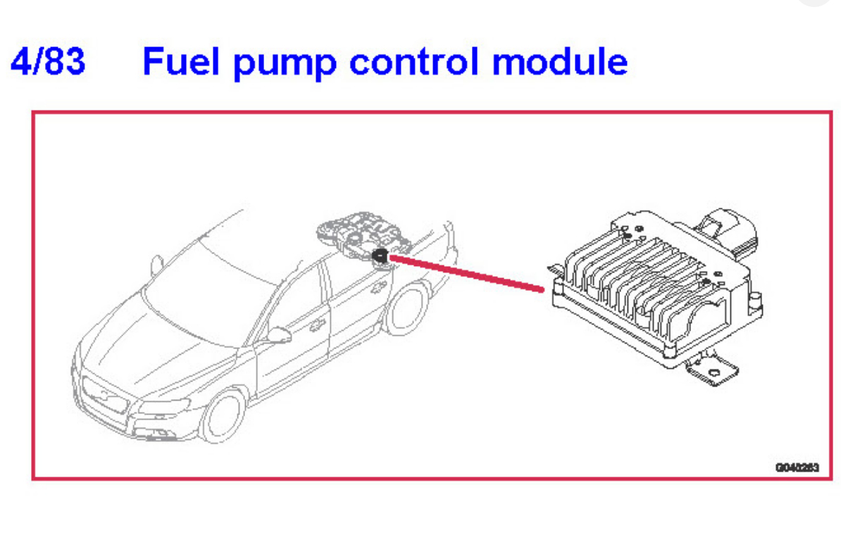

There is no relay, but a fuel pump control module located on the fuel tank.
I have attached the wiring schematics for the fuel pump below.

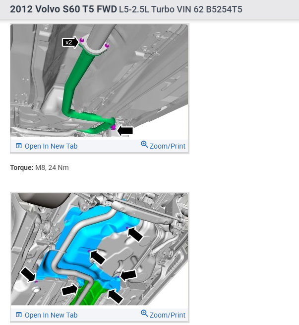

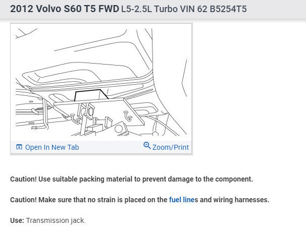

Where is this module on the fuel tank? Under the seat? I can only see fuses underneath the dash on passenger side on firewall... but no numbers.
Mar 5, 2022 at 4:00 AM
SQM

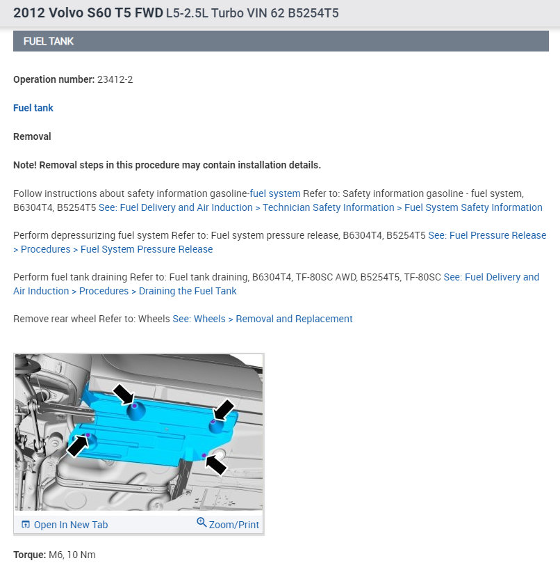

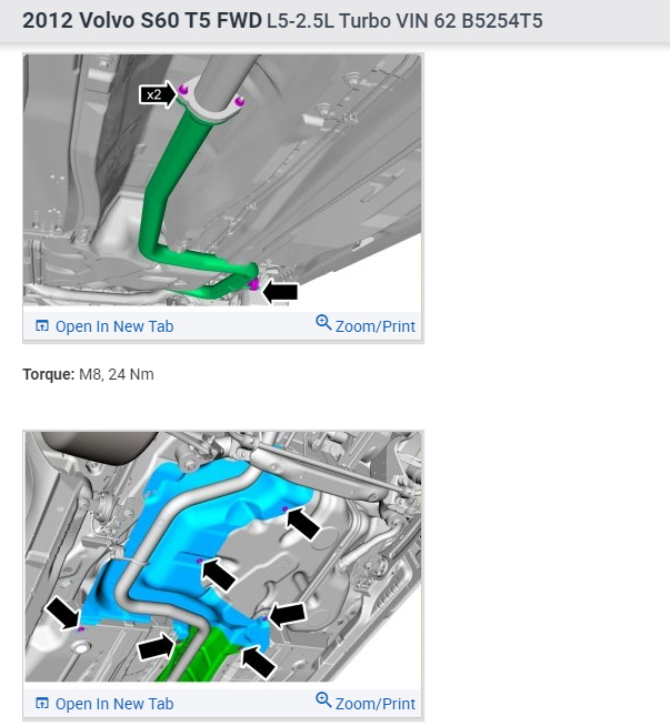

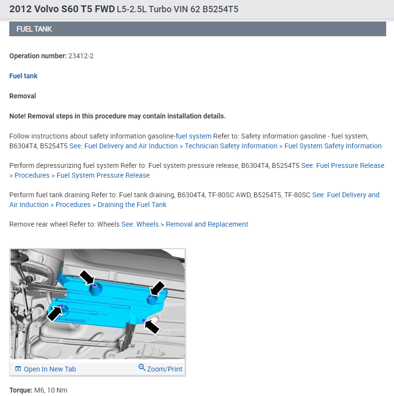

  • 6,383 POSTS

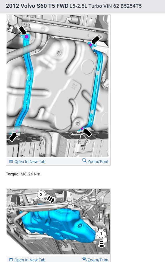

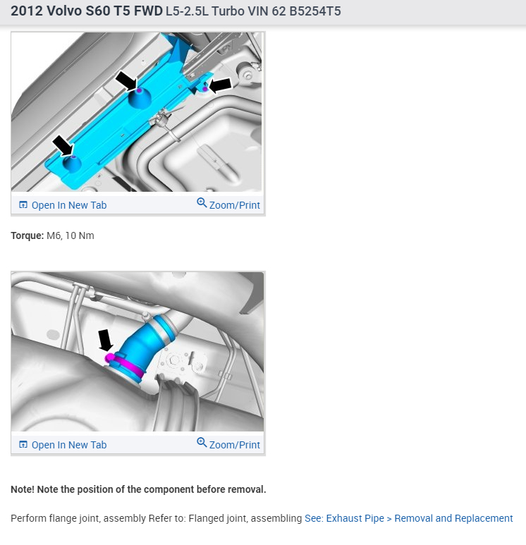

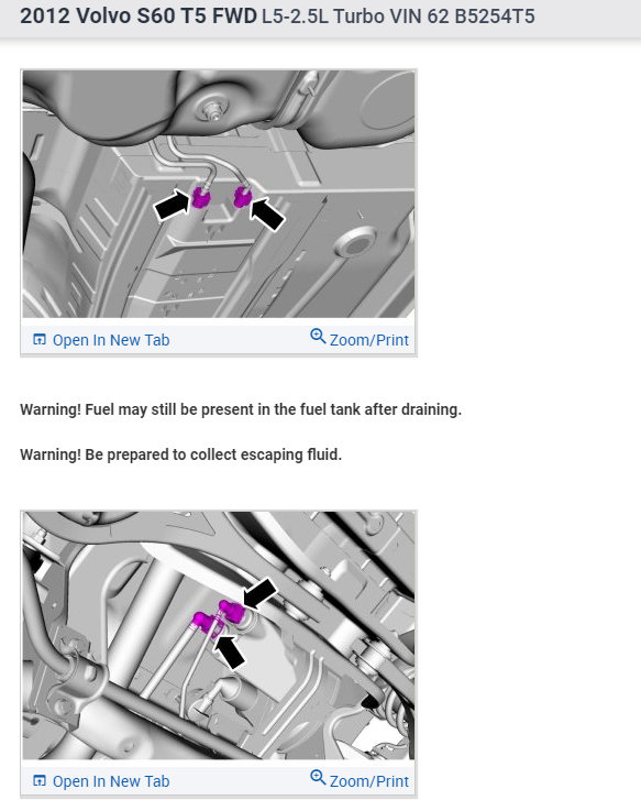

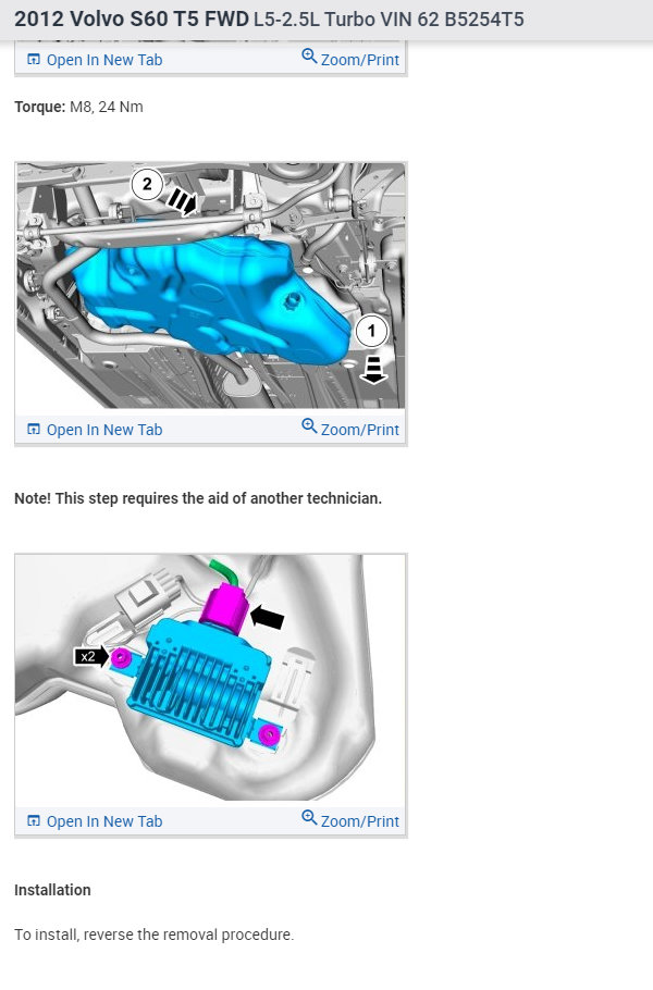

This module is actually mounted on the top of the fuel tank. In order to access the module the fuel tank will have to be removed.
I have attached the procedure below for your reference.
