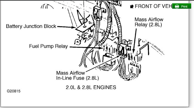

Hi, I have the car listed above station wagon. It’s the base model. I’m planning to change my fuel filter. I just want to know where the fuel pump fuse is located and which one it is? Thank you!
May 10, 2019 at 5:56 PM
SCGRANTURISMO
  • 4,897 POSTS

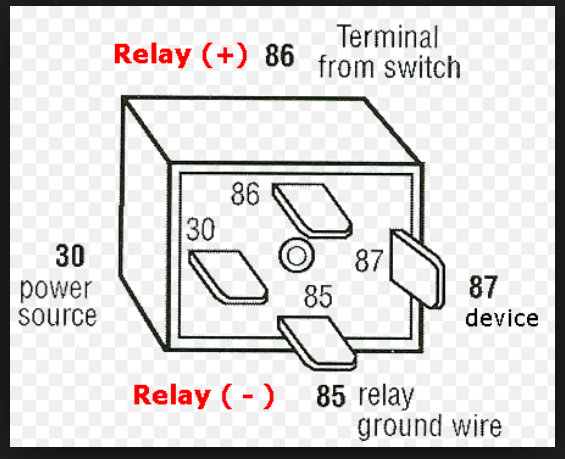

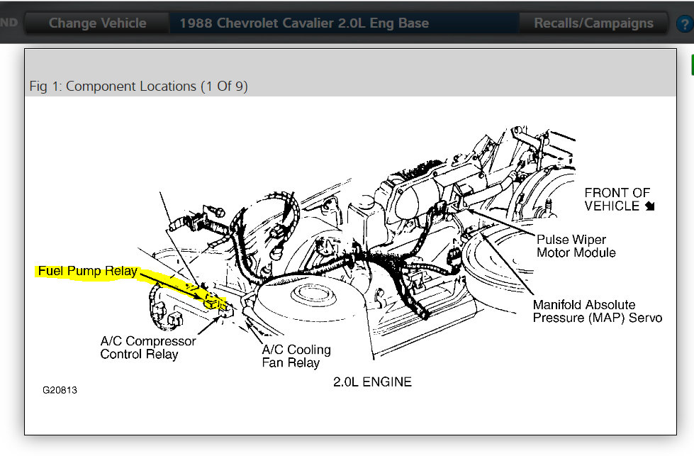

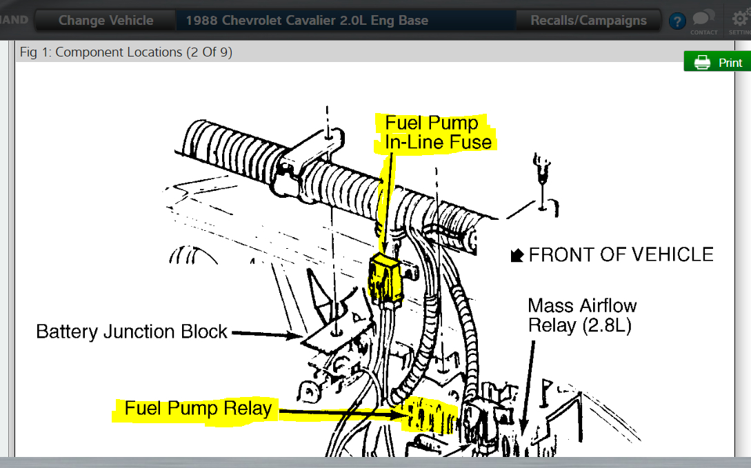

Your vehicle's fuel pump relay is located on the left hand side of the engine compartment on the firewall. I have included a few different diagrams of the relay and fuse for your vehicle's fuel pump in the diagrams down below. I have also included a diagram of how a relay works for you as well. If you should have any other vehicle related questions, please, feel free to ask.
