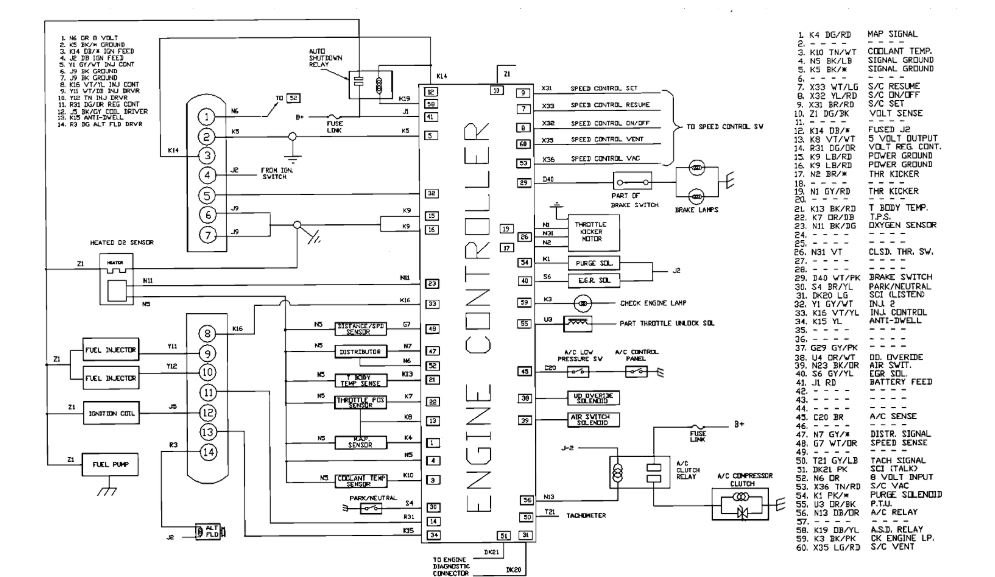

It starts with gas poured into the carburetor and then after that it will not stay running. Fuel pump fuse?

Good afternoon.
You need to check for power to the fuel pump. It is in the tank itself. I attached a wire diagram for you to view.
If it has power, the pump is the issue.
If it does not then check the wiring from the ASD relay to the pump.
