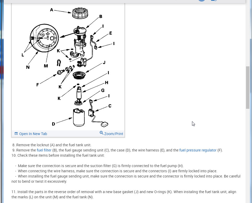

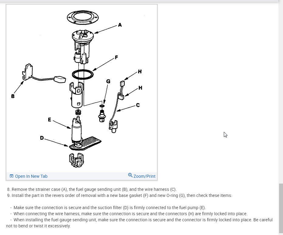

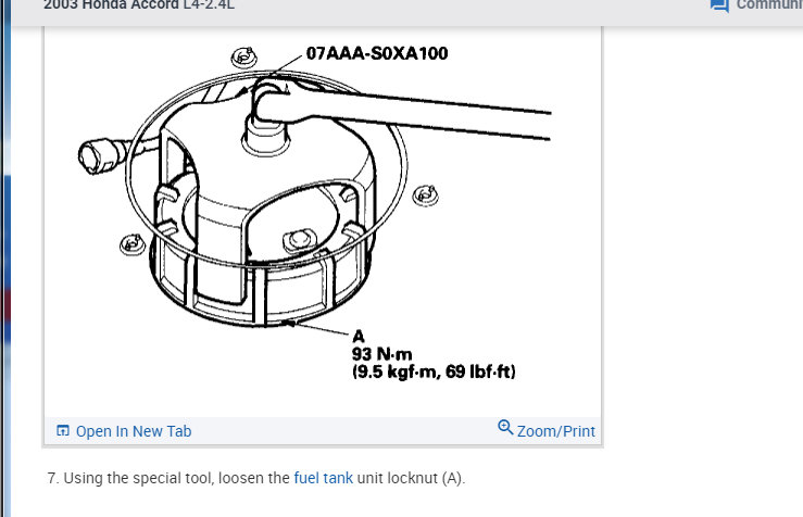

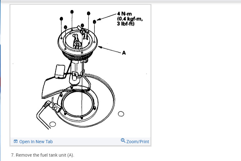

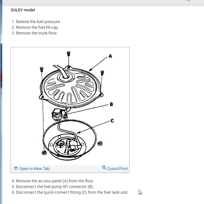

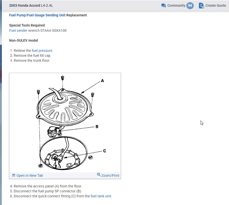

My car will sputter as it starts up. Sometimes I have to press the gas pedal as I crank it to get it to start. I've noticed it takes its time accelerating. I want to try to fix this by replacing the fuel pump and filter. Where is the fuel pump/filter located? Is it accessible through the trunk?
Sep 20, 2020 at 4:00 AM
To confirm this we should check fuel pressure.
Here is all the info you requested. Let us know what happens and we can go from there. Thanks
