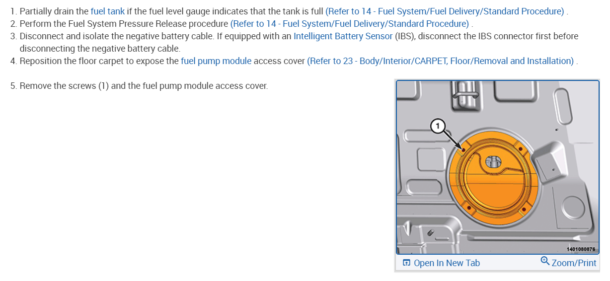

Where is the fuel pump located?
2018 CHRYSLER PACIFICA
100,000 MILES • 3.2L • V6 • 2WD • AUTOMATIC
JAXFLAGIRL

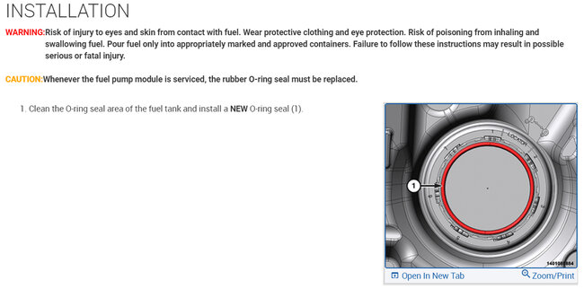

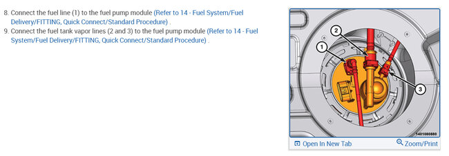

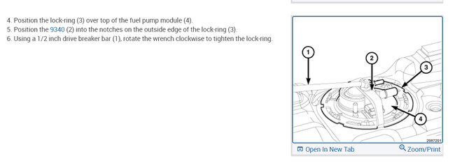

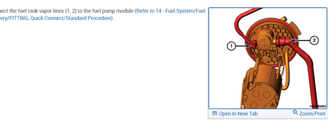

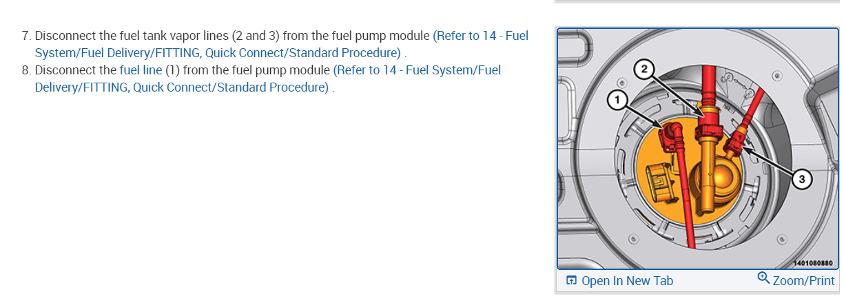

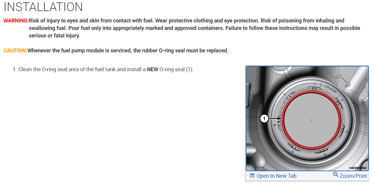

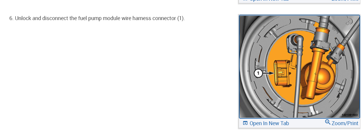

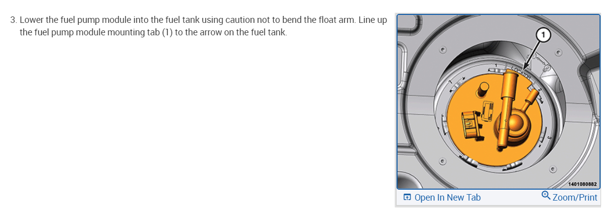

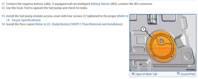

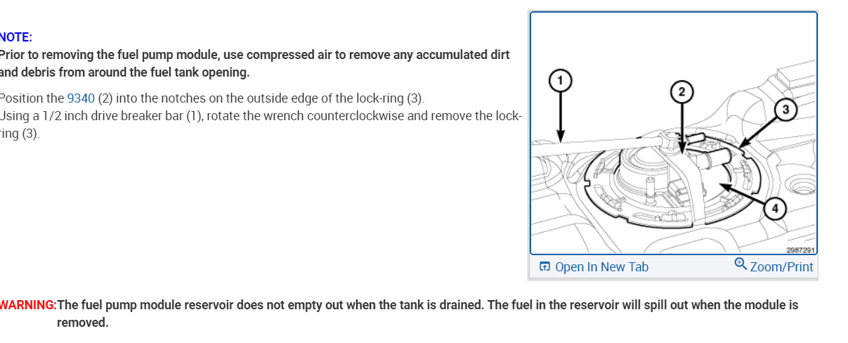

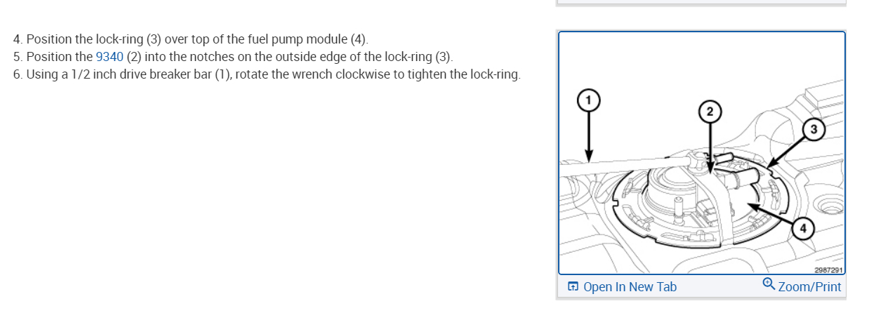

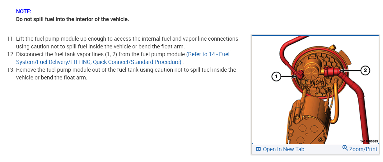

The car misfires and I believe it's the pump. I'm not sure where it's located. I'm not sure if I have to drop the tank or if there an easier access to it. Please advise.
Aug 14, 2023 at 9:59 AM
  • 55,447 POSTS

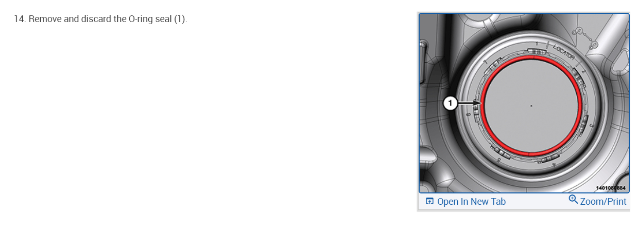

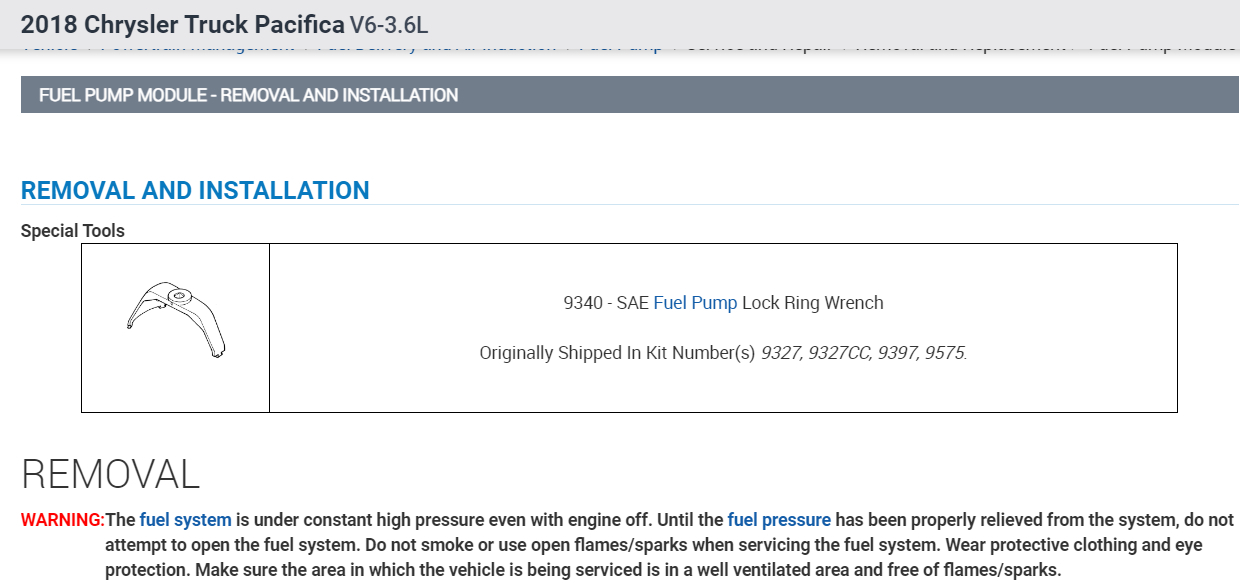

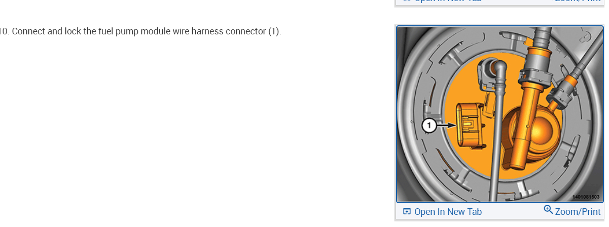

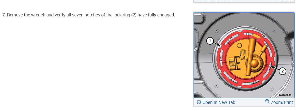

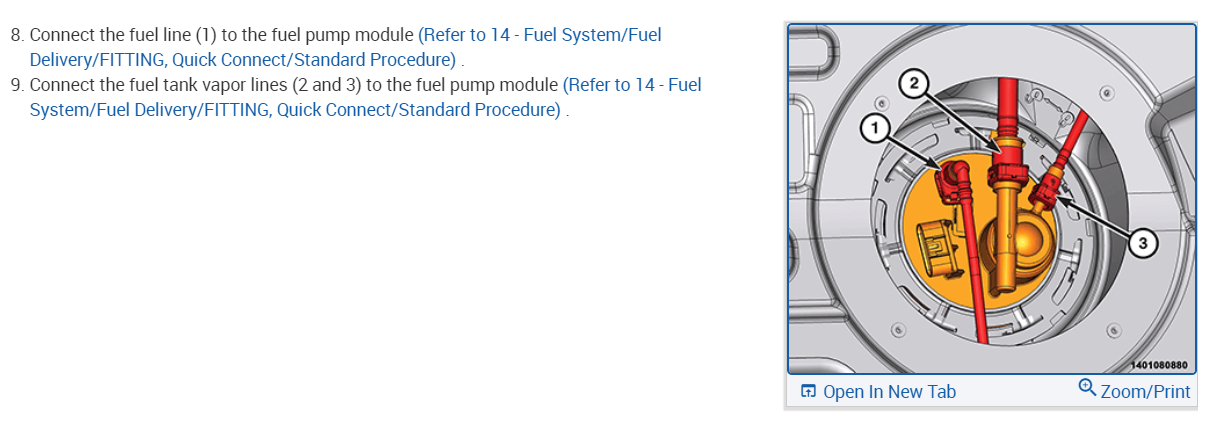

Luckily, you don't need to remove the fuel tank because there is a trap door. Check out the images (below). Please let us know if you need anything else to get the problem fixed.
Aug 15, 2023 at 3:22 AM
