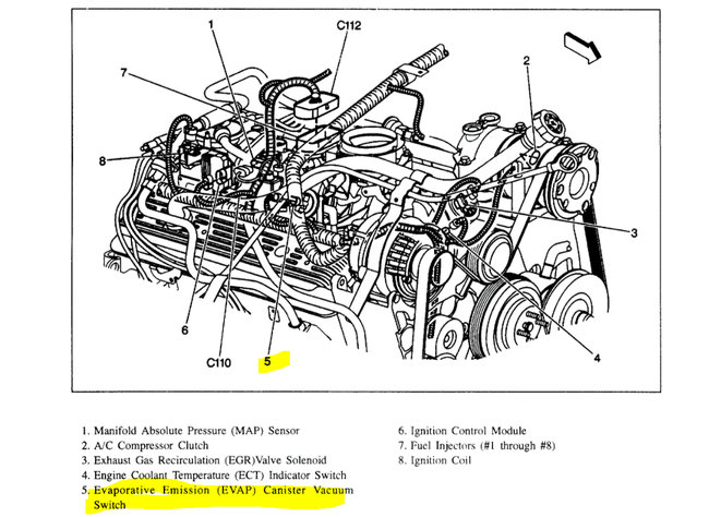

fuel pump replaced a year ago broke some nylon lines didn't finish and lost some lines from the emission thing at front of tank has two ports. can't find hose routing map. thanks
Oct 9, 2020 at 5:48 AM
  • 110,248 POSTS

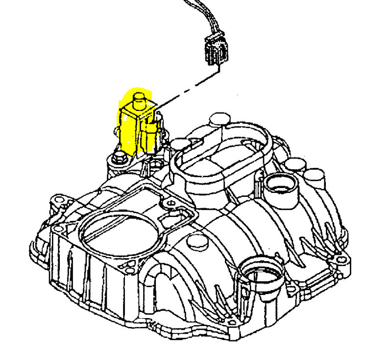

That is the EVAP canister. Pic 1 shows the two vacuum hoses to it. One goes to the fuel tank and the other goes to the EVAP purge solenoid (shown in pic 2).

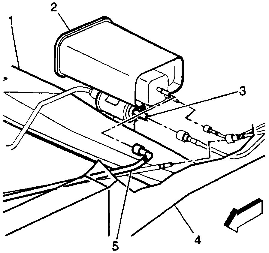

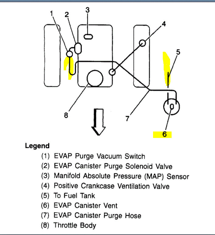

Note that the line first goes to the vacuum switch (pic 3) and then the purge solenoid (pic 4)
