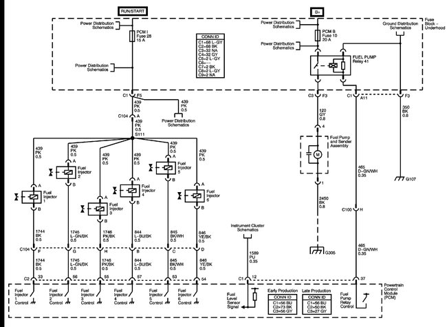

History: Vehicle was idling in the driveway when it stalled out. No successful restart since that time.
Checked all electrical to fuel pump, electrical checks out. replaced fuel pump - no change.
Bypassed the fuel pump(pin 30 to pin 87) relay and pump works. Voltage at the pump is twelve volts.
Pin 86 shows ground. Pin 85 shows twelve volts with ignition in run position.
Pin 30 shows twelve volts.
Dumping a small amount of fuel into the carburetor allows the truck to rumble for around two to four seconds.
I have tested the relay by swapping out with high beam relay, all relays work properly in the high beam slot.

Do you hear the pump kick on during the 2 second prime when you first turn on the key?
If you jump the relay so the pump turns on does it run then? I'll guess it doesn't.
Pick an injector and test the pink wire to see if you have full battery voltage on it. If you do you might want to unplug one injector at a time and see if it starts. A shorted injector could cause the PCM to shut off the injectors as protection.
Test to see if the PCM is pulsing the injectors by pulling an injector wire off. Now connect a test light to battery positive and probe the other wire in the connector. While cranking the engine the light should flash every time the PCM grounds the control side of the system.
You said you swapped the pump, have you checked the actual pressure at the fuel rail? You should have 50-58 psi at the rail. I have seen a bad pump out of the box before.

I can get the pump to run when I bypass the relay. The flow isn't what I would expect, but I have no baseline to go by. There is no pump prime when the ignition is turned on. I don't have access to a way to test the pressure :(
The initial test, Pin 85 (relay power from the PCM) shows 12 volts with the ignition on. Testing with the rely in place, the voltage drops to zero on Pin 85. This is not what I would expect. I have swapped relays with the same behavior.

The relay on signal at pin 85 should turn on for about 2 seconds then go off every time you turn the key on. That is the initial prime. That power will stay off until you turn the key off and on again or until the PCM receives a signal from the engine that shows it is running after a cranking attempt.
The pump should shoot a solid stream of fuel. From your description I would check the ground for the pump and the connector pigtail. They can get corroded and cause a voltage drop.

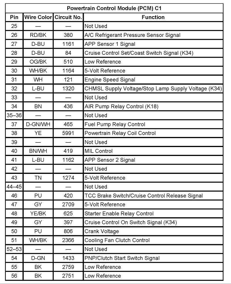

If the signal isn't at pin 85 when you turn on the key you can check for it back at the PCM on terminal 37 in connector 1 That's a Dark Green with White stripe wire.
You might have an issue with the PCM, but it would take a factory scan tool to go in and see if there were errors.
