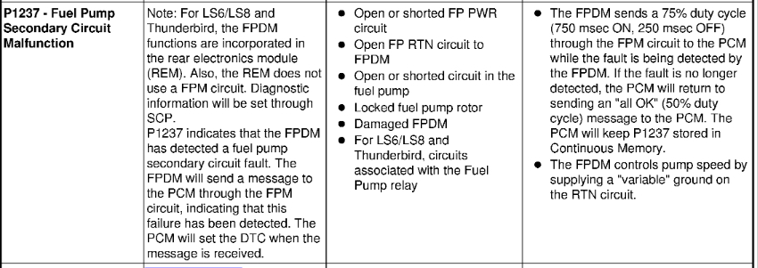

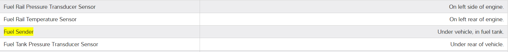

Fault code P1237. Trying to locate fuel pump driver module (FPDM). Can any one help?

It looks like it is on the fuel tank. Location description in diagrams below. Check out the diagrams (Below). Please let us know if you need anything else to get the problem fixed.
