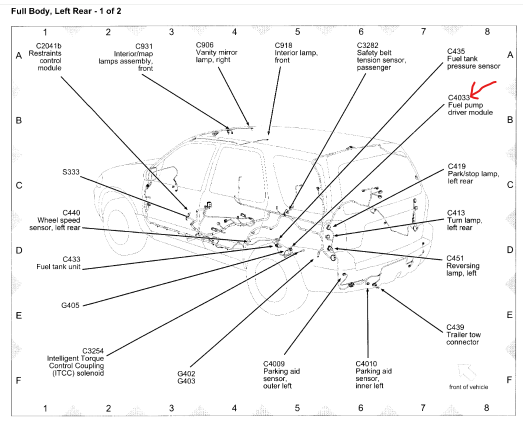

Where is the fuel pump driver module located?
2007 FORD ESCAPE
99,000 MILES • 2.3L • 4 CYL • 2WD • AUTOMATIC
ZIMM1027
Oct 10, 2024 at 8:47 AM
  • 54,832 POSTS
The fuel pump driver module is under the center of the car. Check out the images (below). Let us know if you need anything else.
