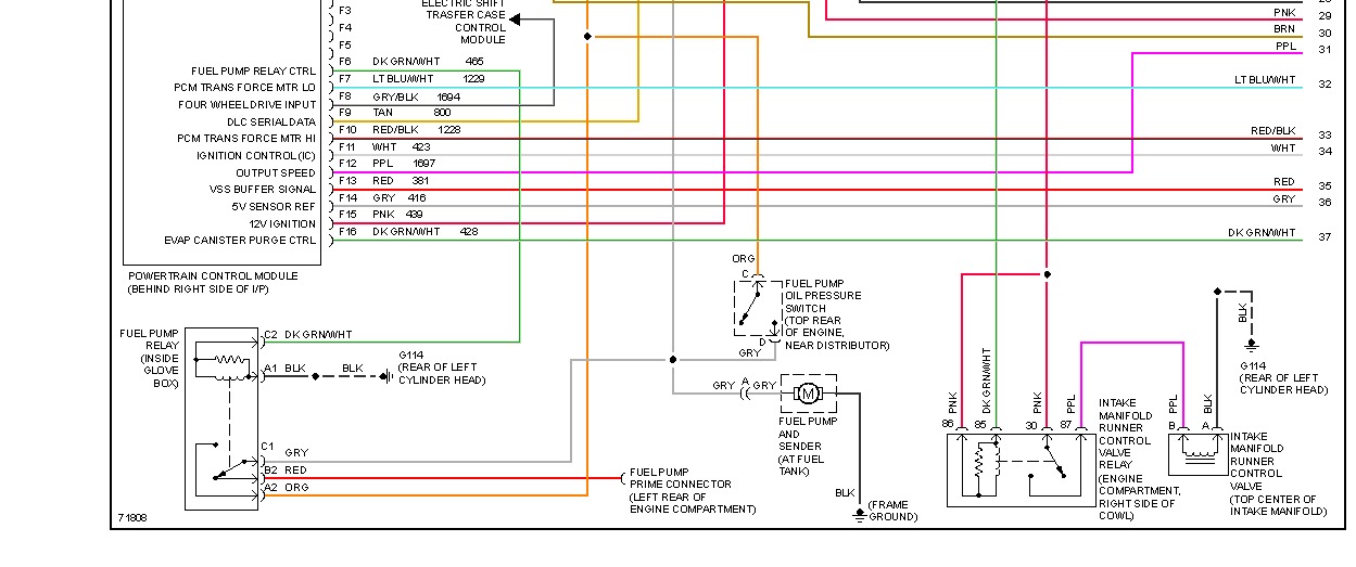

Needing a wiring diagram for a 1995 GMC Sonoma from the fuel pump to the power control module would be great. Found a loose wire and need to see where it would go.
Just replace the fuel pump, tested it does work.
However not working when key is turned over possibly due to the HANGING WIRE.
Needing a diagram to see where this one of many go.
thank you.

Tehpic pretty much sums it up except orange wire goes to fuse 9 in dash fuse block.
